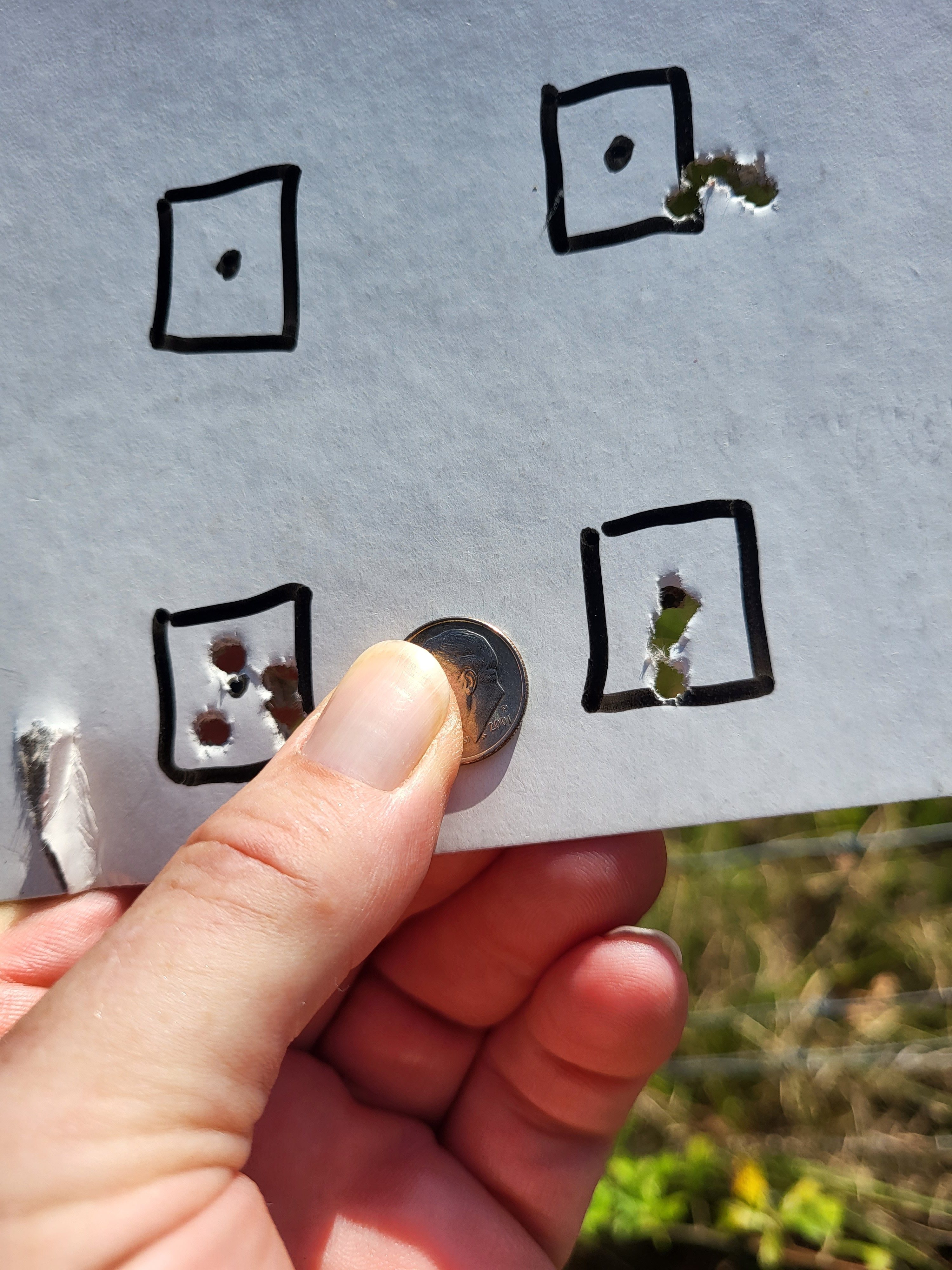

I spend a considerable amount of time recommending the Taipan Veteran simply because I want others to experience the satisfaction of ownership I have experienced with mine. I like simplicity...hate workin' on stuff, (after a life time in maintenance) like my guns to to shoot the "good stuff" like JSBs and also the "more affordable" CP domes...my Daystates do well with both without touching anything except poi but power settings are fixed on Huntsman and Wolverine...one 360* ccw turn of HA spring on my Veteran shooting 18.13s @ 870 and I get 830 with decent accuracy and more shots per fill with CP 14.3 domes, easy repeatable and simple to fine tune, just rezero scope. The "white board" groups, the bottom left was the Veteran after sitting for a couple weeks at 250b first 5 shots with CP domes...the other brown board is a typical 18.13 group, been doin' it for a couple of years now! BTW the bottom R white board group was first 5 shots with .177 unregulated Huntsman also sitting a week or two...JSB 10.34s, all groups at 31yds. Guns with power adjuster knobs like my Bobcat work well and easy to adjust but translate into more O-rings and are more complex...I'm out on them...although had no issues to date just like the Veteran platform better since I found it. I've recommended the Vet
before and will again...good luck whichever one you choose!
