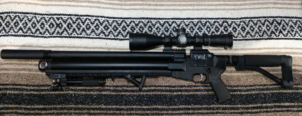

Here's a fairly short 13.5" scope with a 50mm objective lense on a standard sized .30 caliber Evol for size comparison. An LPVO like this Swampfox 1-10×24 SFP takes off about 3" in overall size and weight, has decent magnification for hunting and shooting out to 100 yards.

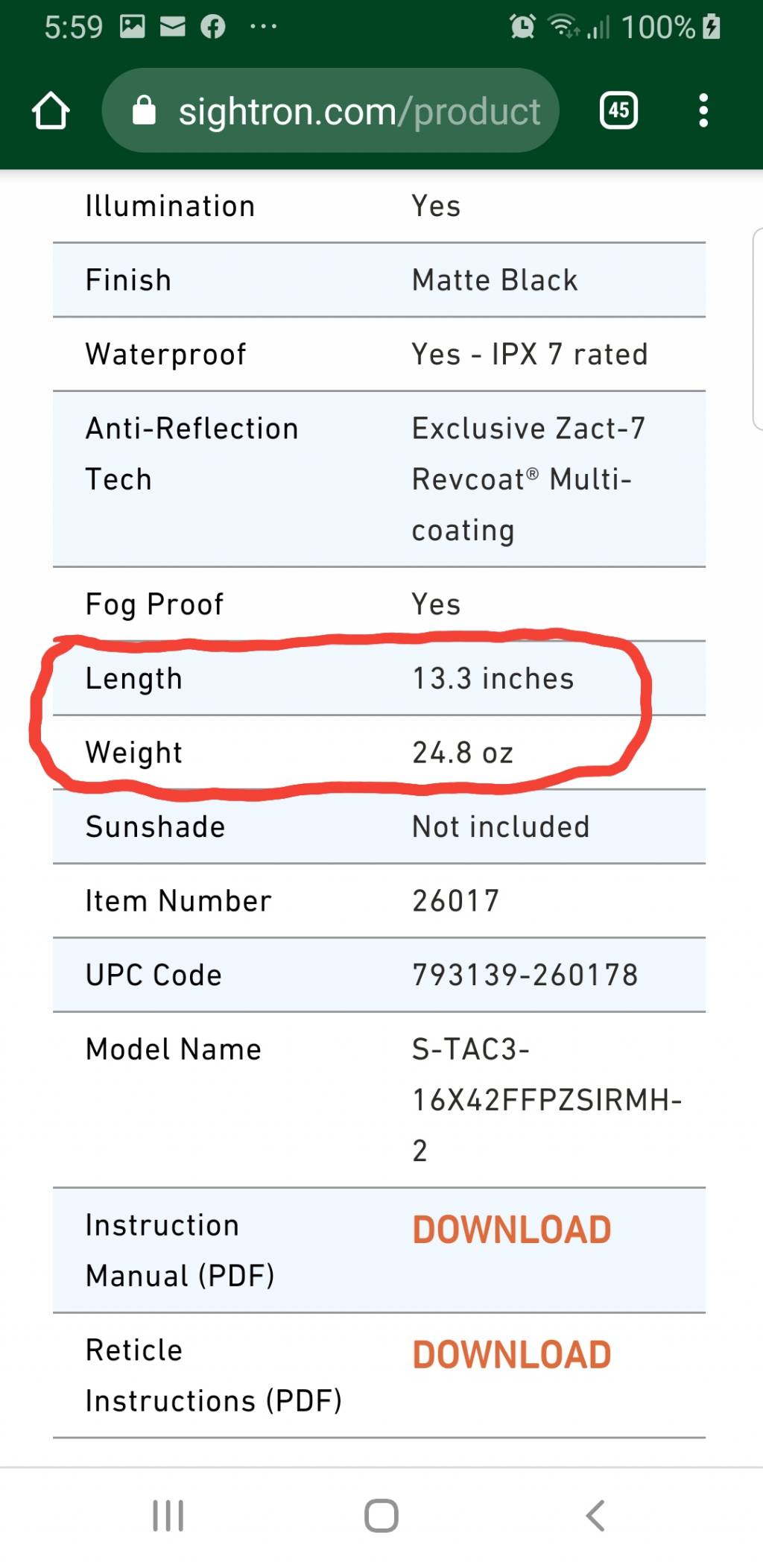

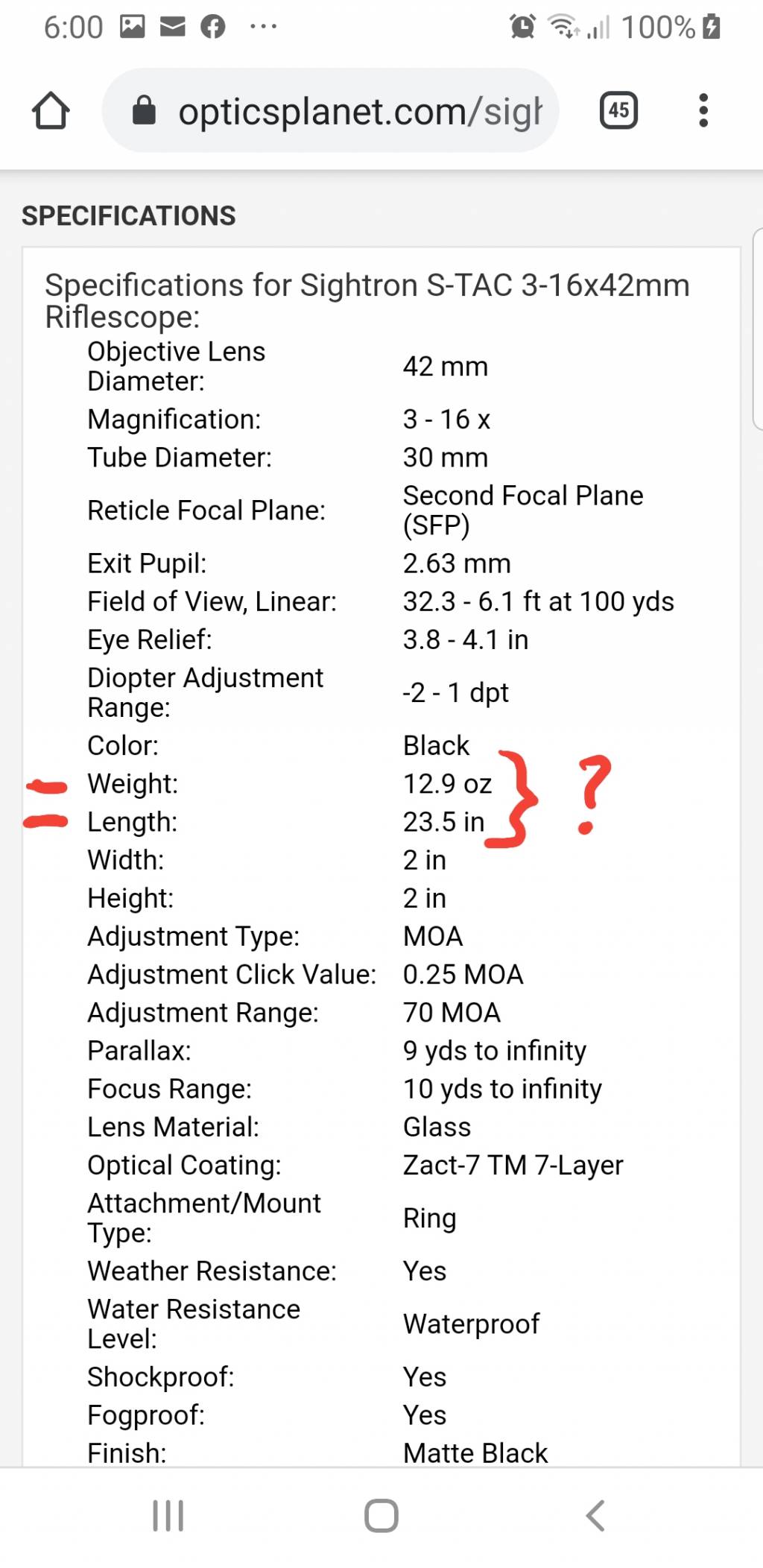

The specs I saw referred to the Sightron as being 12.9 ounces.
Were you looking at the specs on Optics Planet by any chance? I think they got the specs wrong otherwise that would be one hell of a long scope unless it has 10 inch sunshade. They got it backwards.
Here's the specs direct from Sightron...
Which Evol 22 do you have or thinking of getting? The Mini or Standard length?
