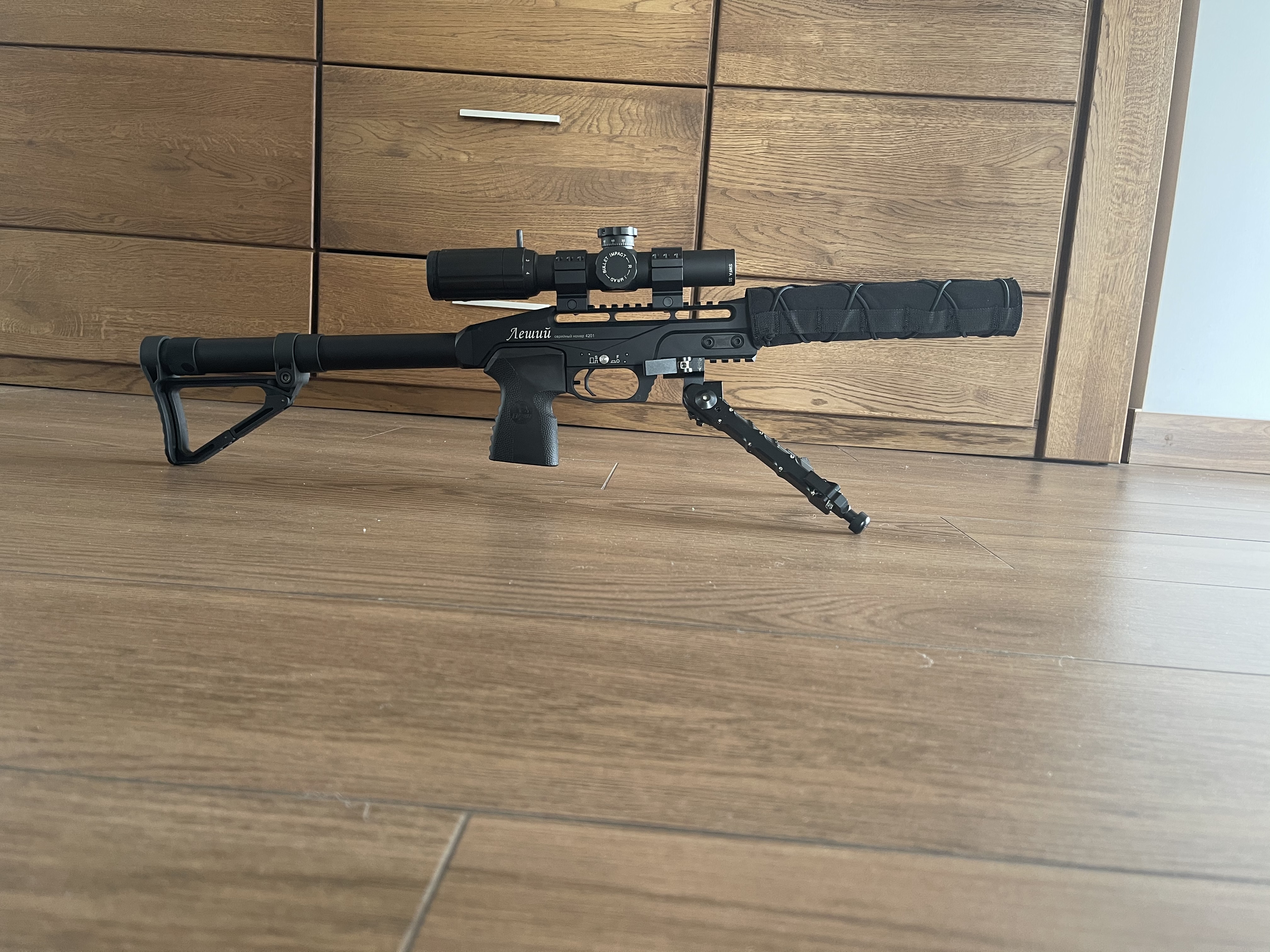

All fits Leshiy if objective is not larger then 42-44mm and length doesn’t exceed 350-360mm.

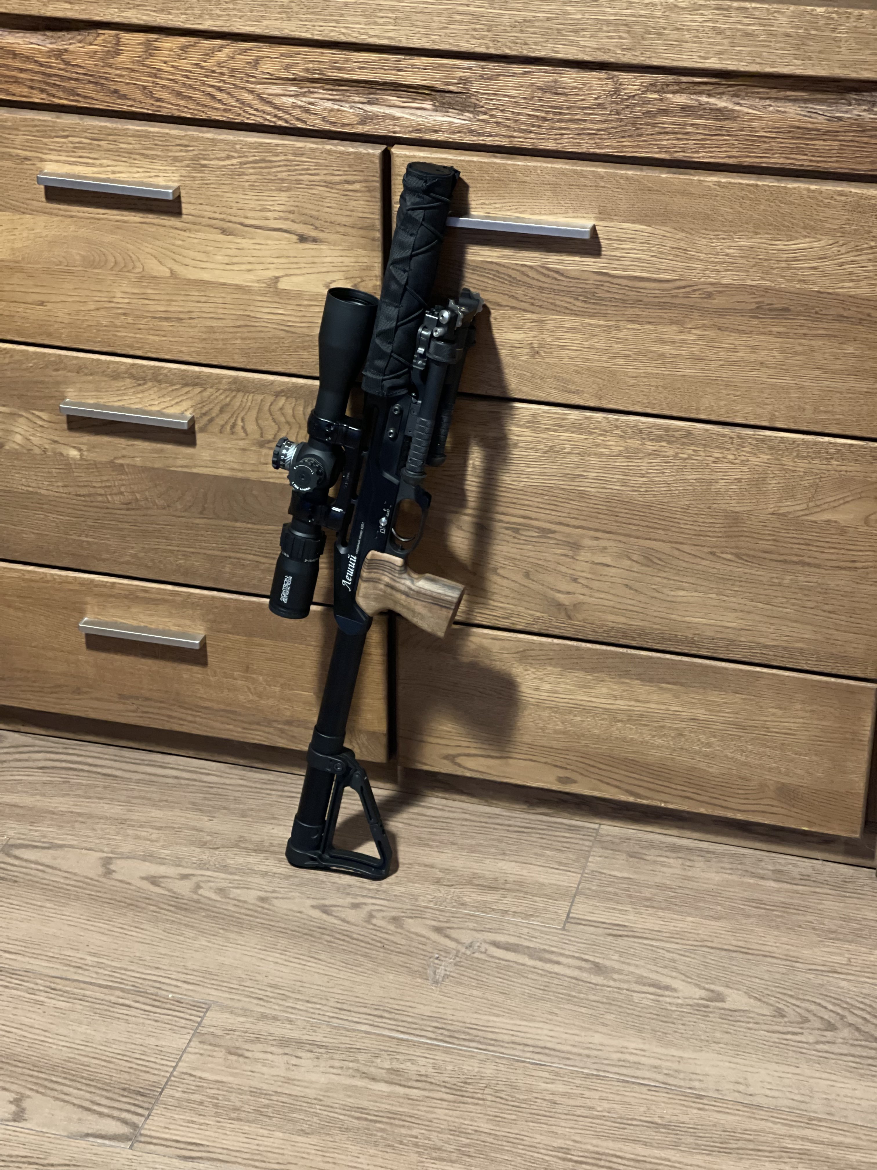

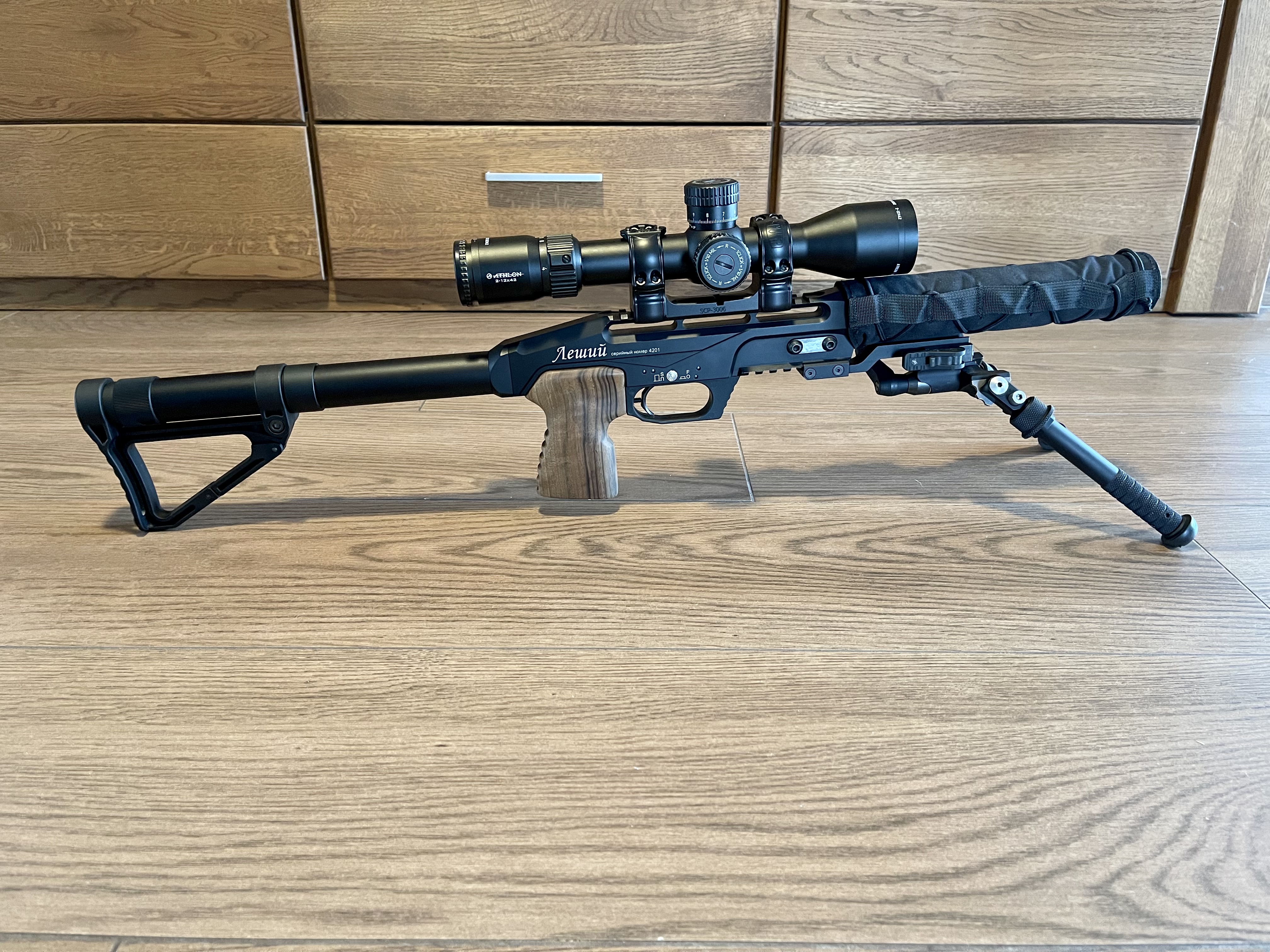

The Athlon Helos BTR Gen2 2-12×42 AHMR2 is a great little scope. Not as small as a true LPVO because of the front glass, it has nearly every requirement most airgunners desire (if not needing or wanting super high magnification).
True. See third picture above.

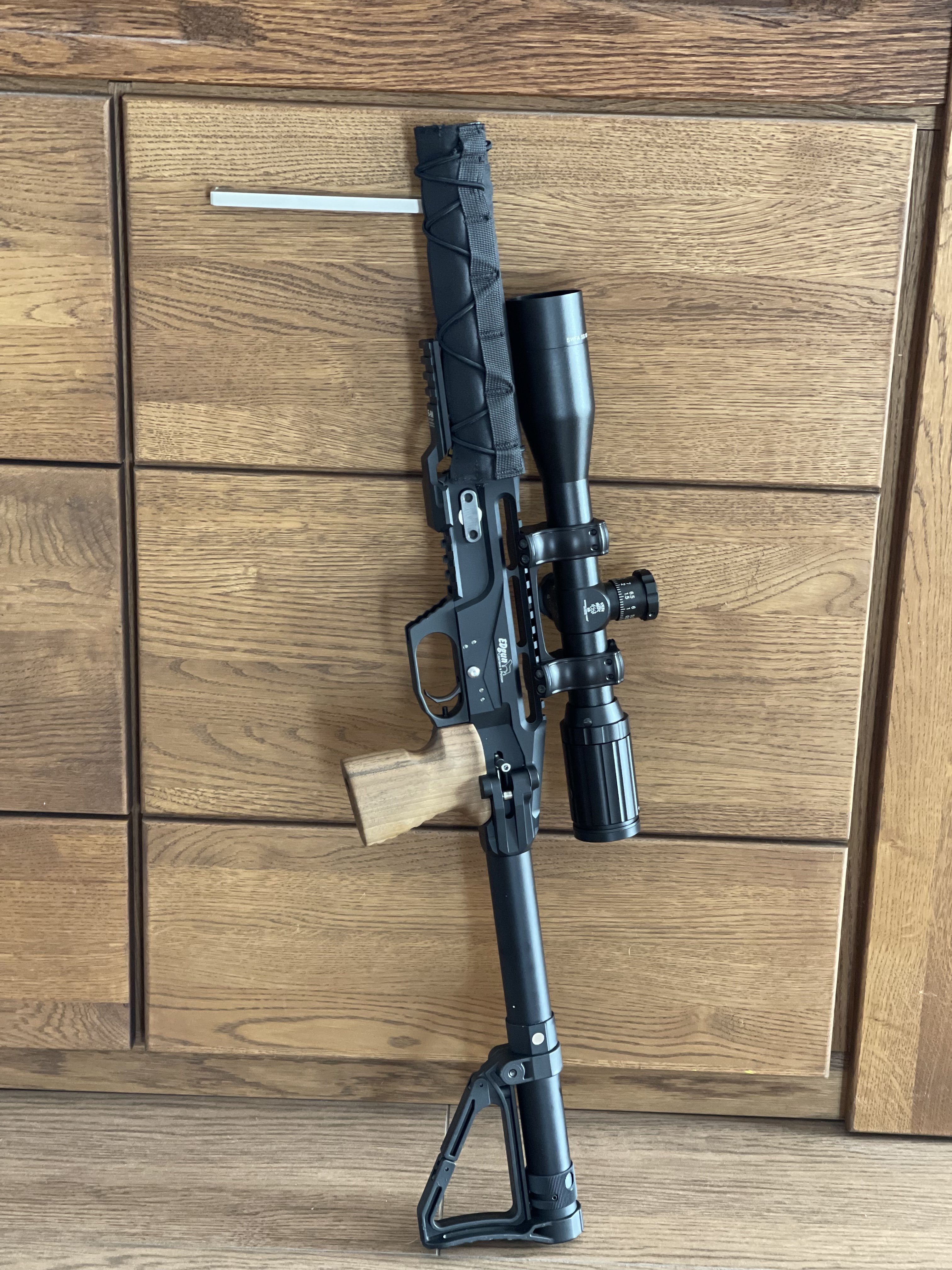

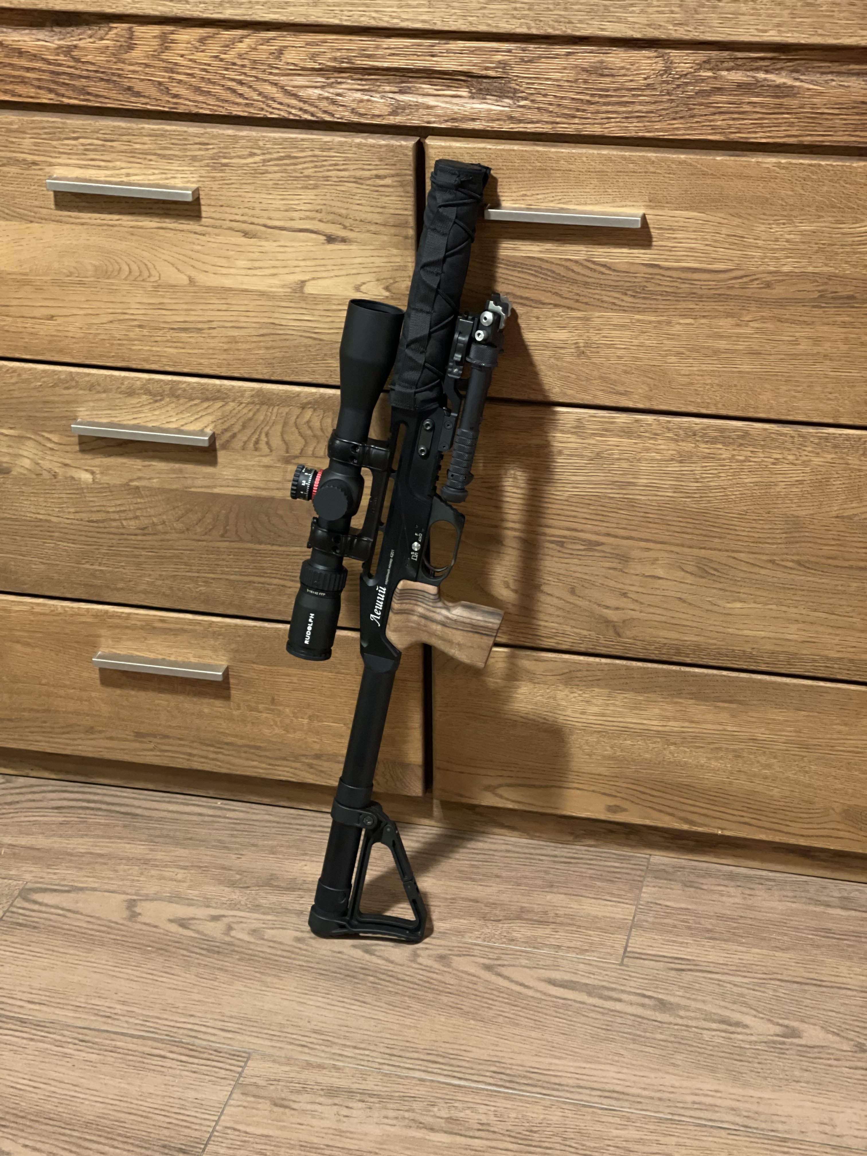

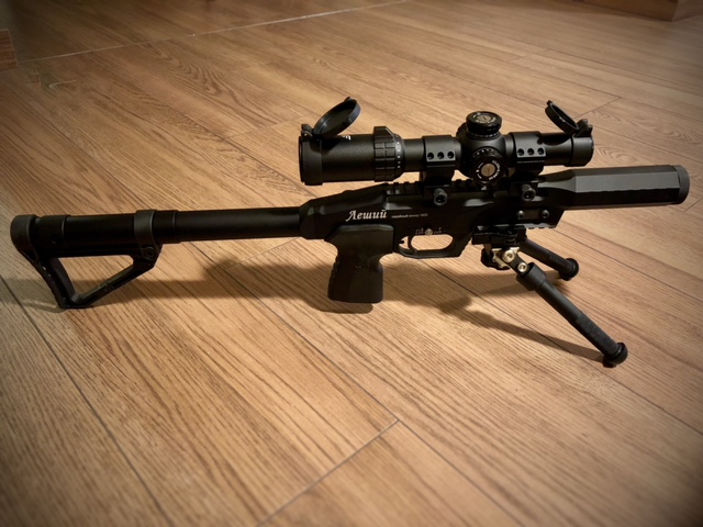

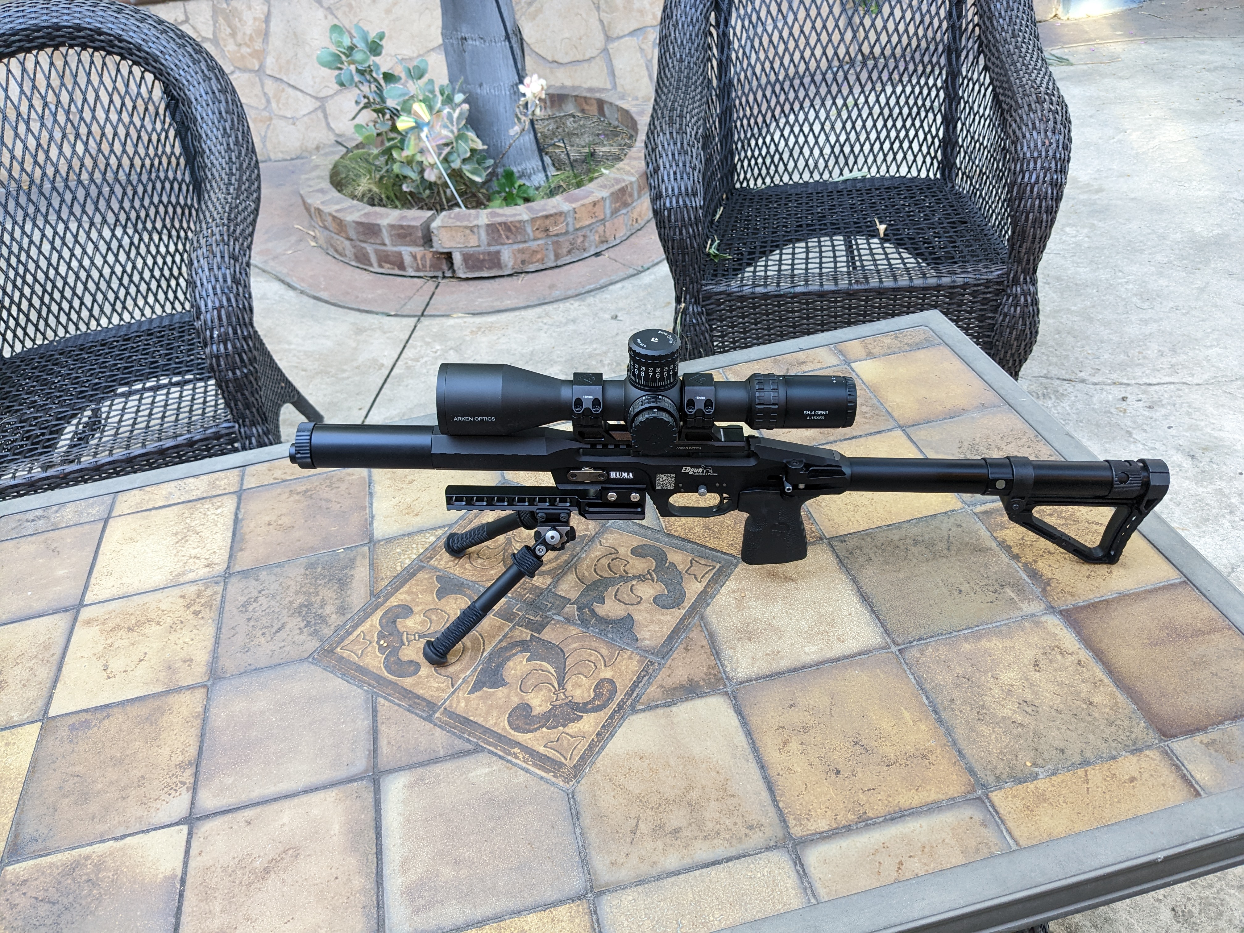

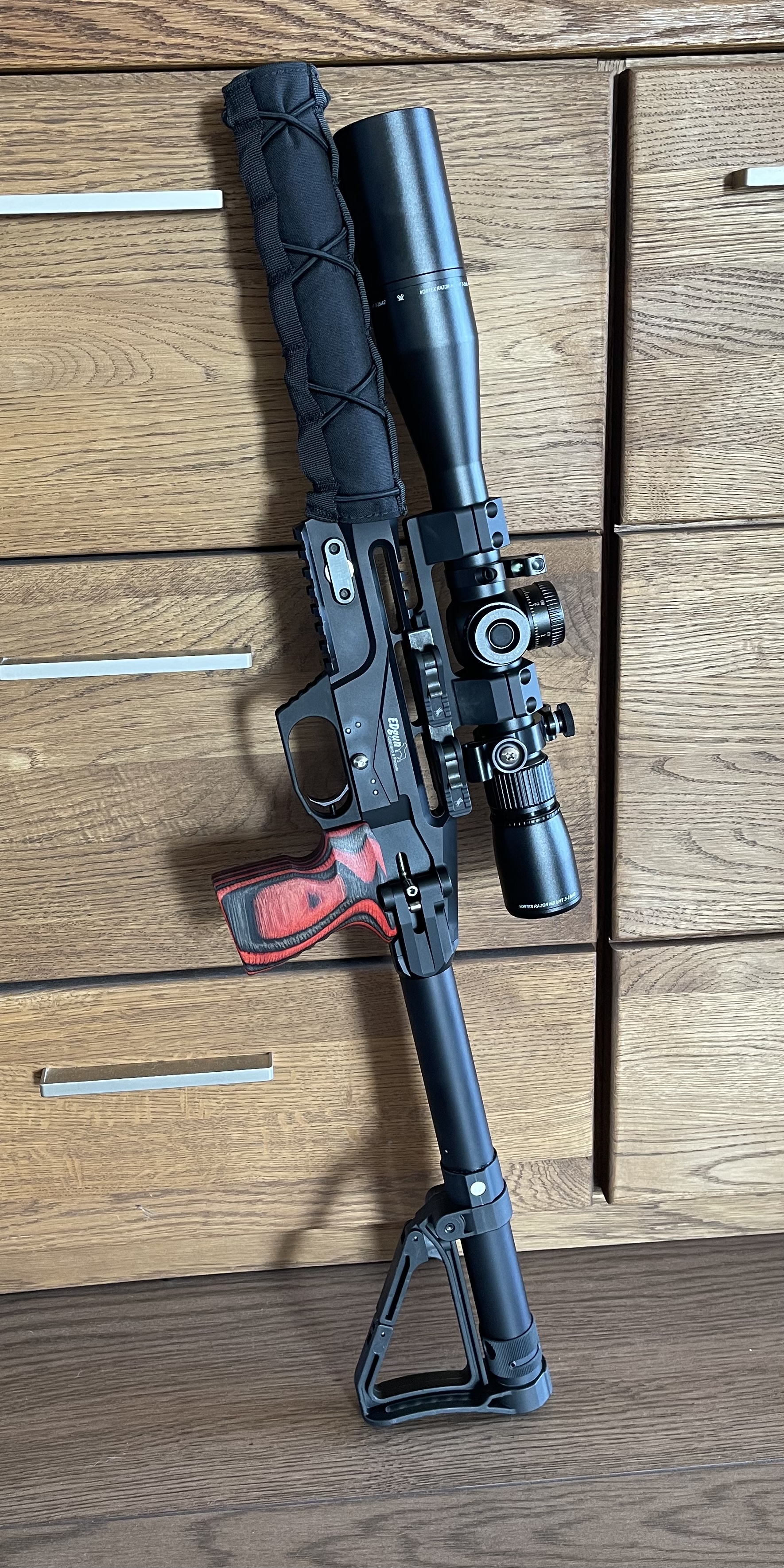

Nice set ups!! Can you please give us a rundown on the optics? I am looking for a compact scope for my lelya. I like the looks of some of those.
From top:
Sightron s-tac 3-16x42 ffp
SWFA ss 10x42 MQ
Athlon helos btr2 2-12x42
Vortex Viper pst II 2-10x32
Vortex Razor HD LHT 3-15x42
SWFA 1-4x24
Leupold VX Freedom 3-9x33 EFR
Falcon S8i 1-8x24
Falcon m18+ 4-18x44
Rudolph 3-16x42 ffp
Vortex Crossfire 2-7x32
Reactions: jt-outta-cali
From top:
SWFA ss 10x42 MQ
SWFA 1-4x24
Falcon S8i 1-8x24
Falcon m18+ 4-18x44
Rudolph 3-16x42 ffp

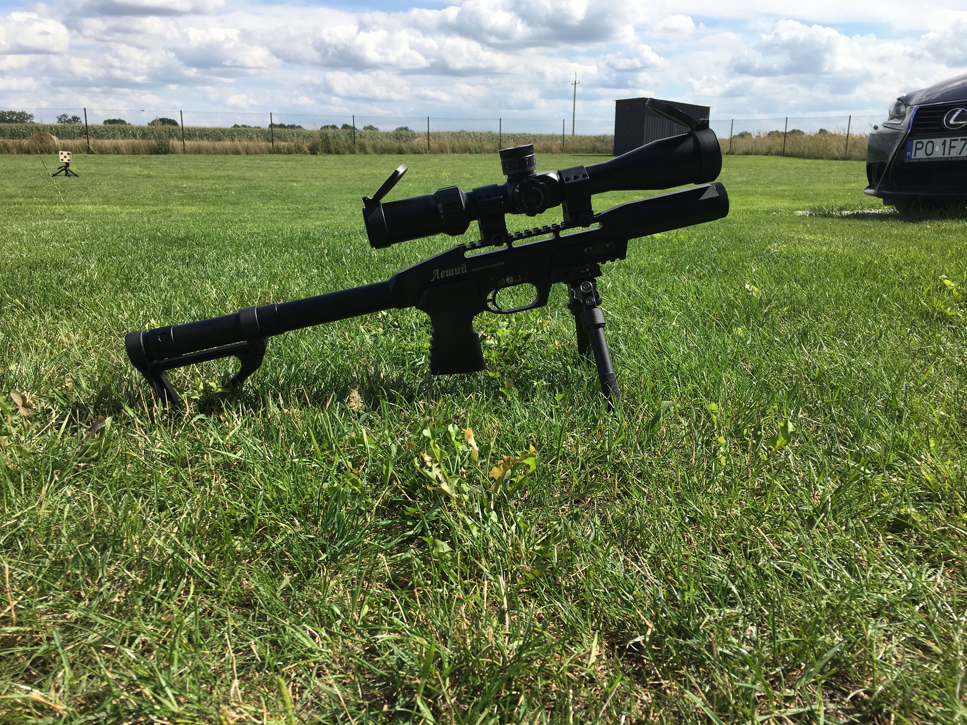

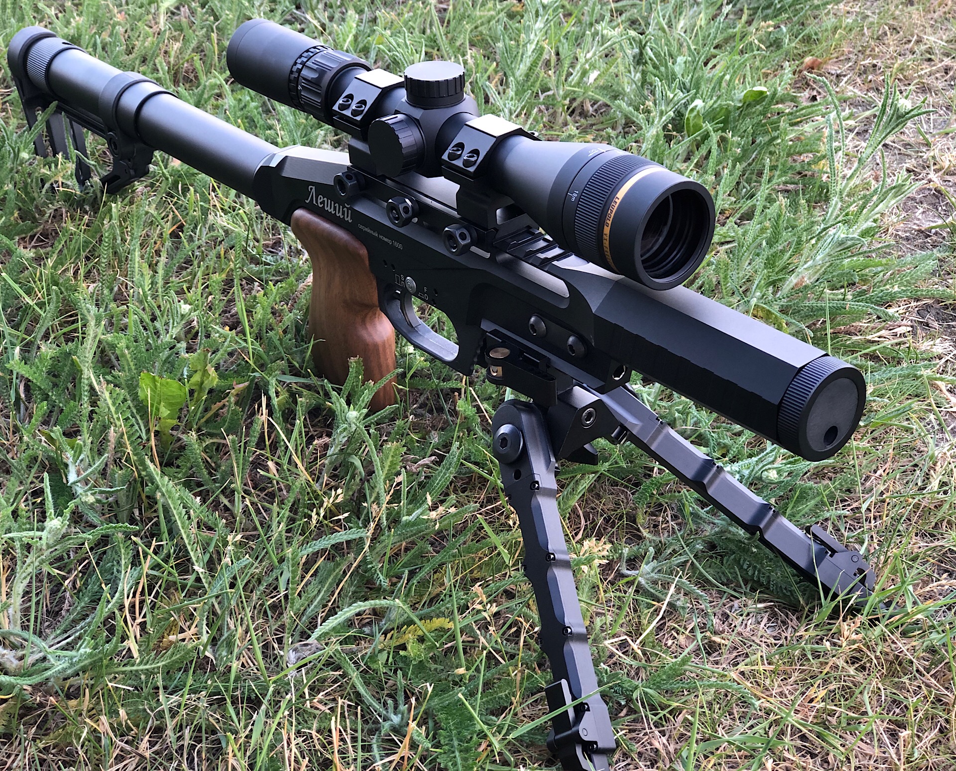

Which was your favorite? I have the S-tac 3-16 SFP in the mail. My leshiy currently has a Leupold VX Freedom 3-9x33 EFR mounted.

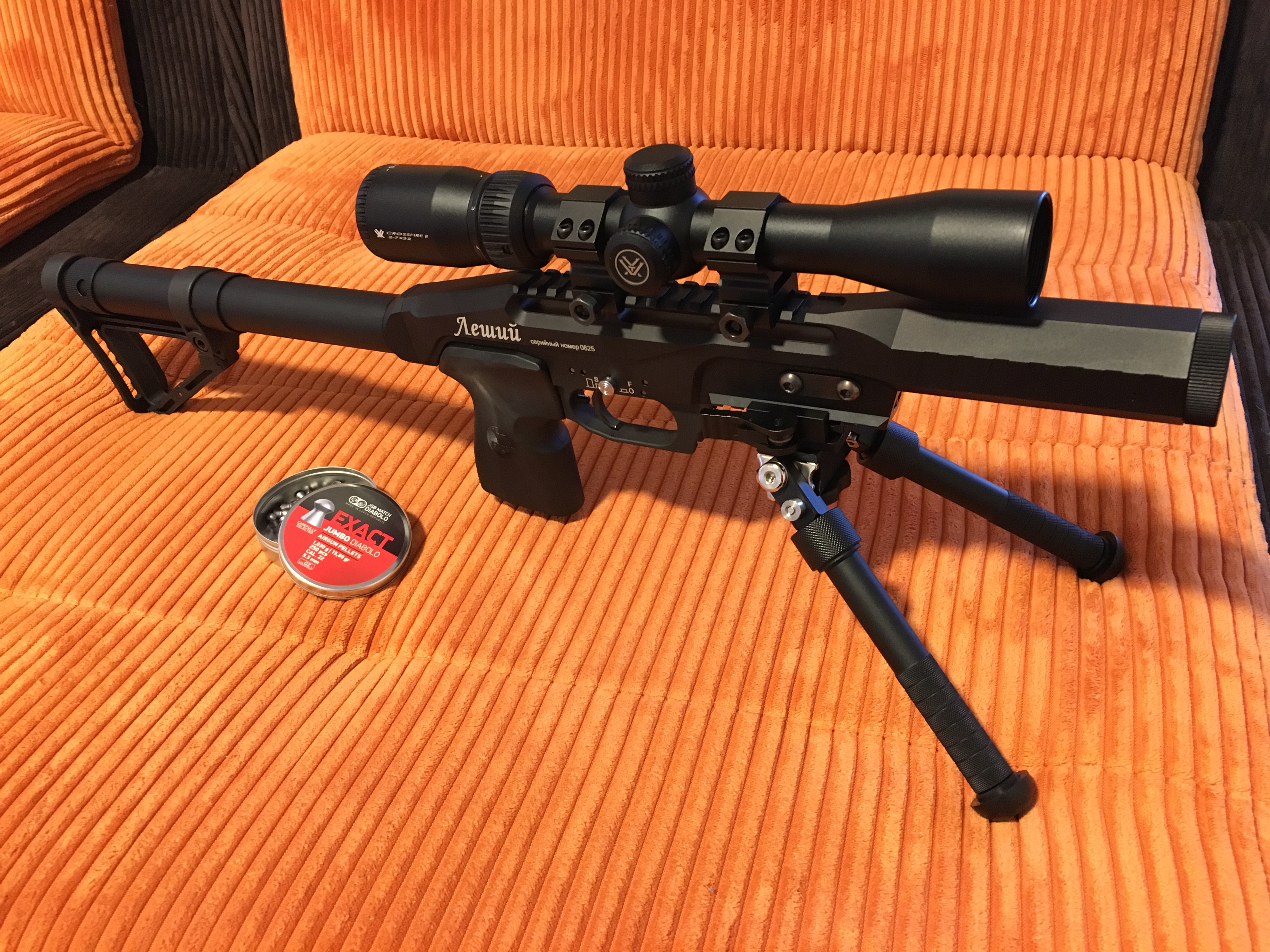

Old pic w/ Arken SH4 G2 4-16
