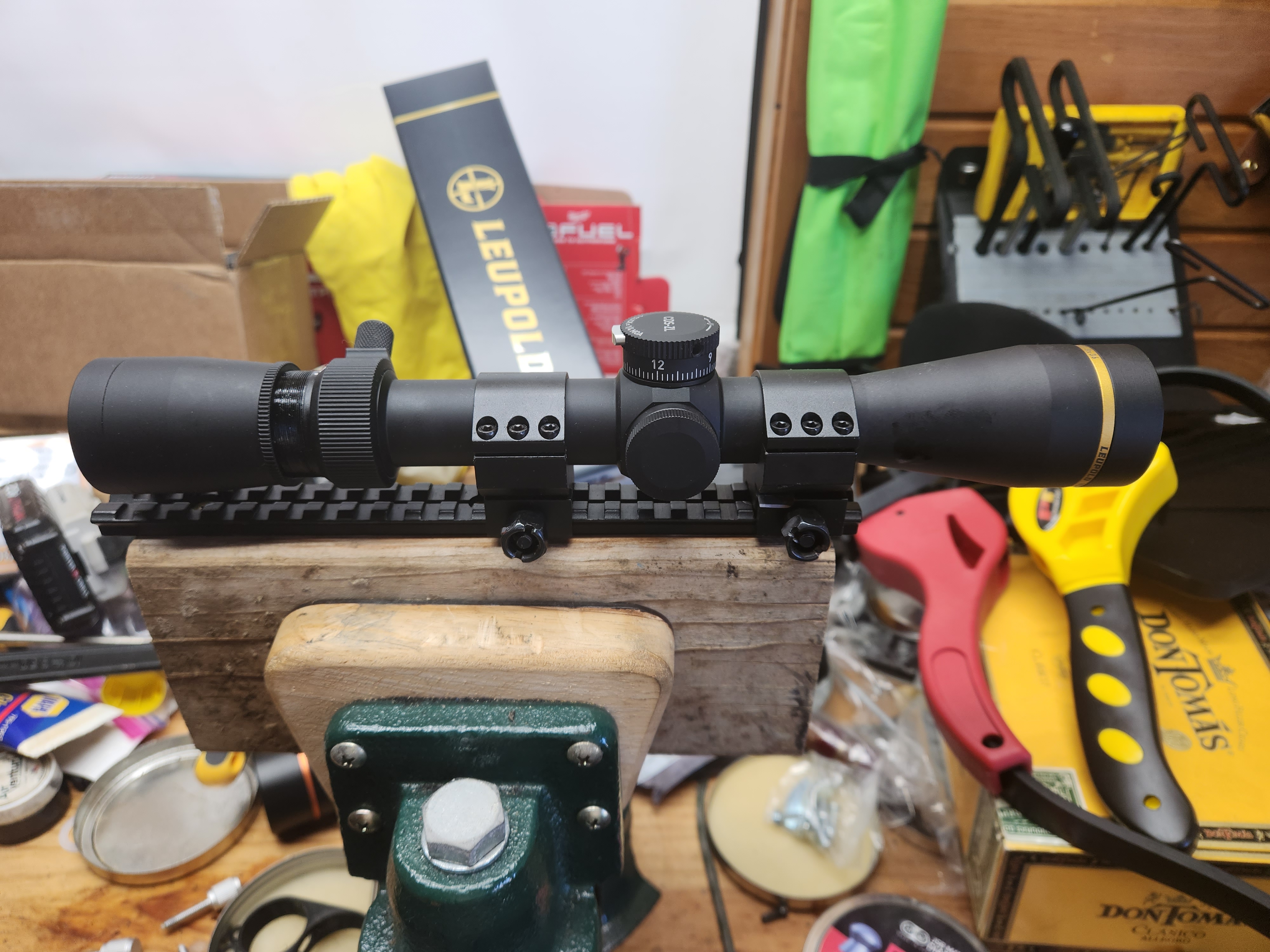

Here is a Leupold I just shortened. There are some risks involved, I would not recommend it if you are not willing to ruin a scope. But so far (knock on wood) I have not ruined any of mine. It does look like a good way to lose the nitrogen.
