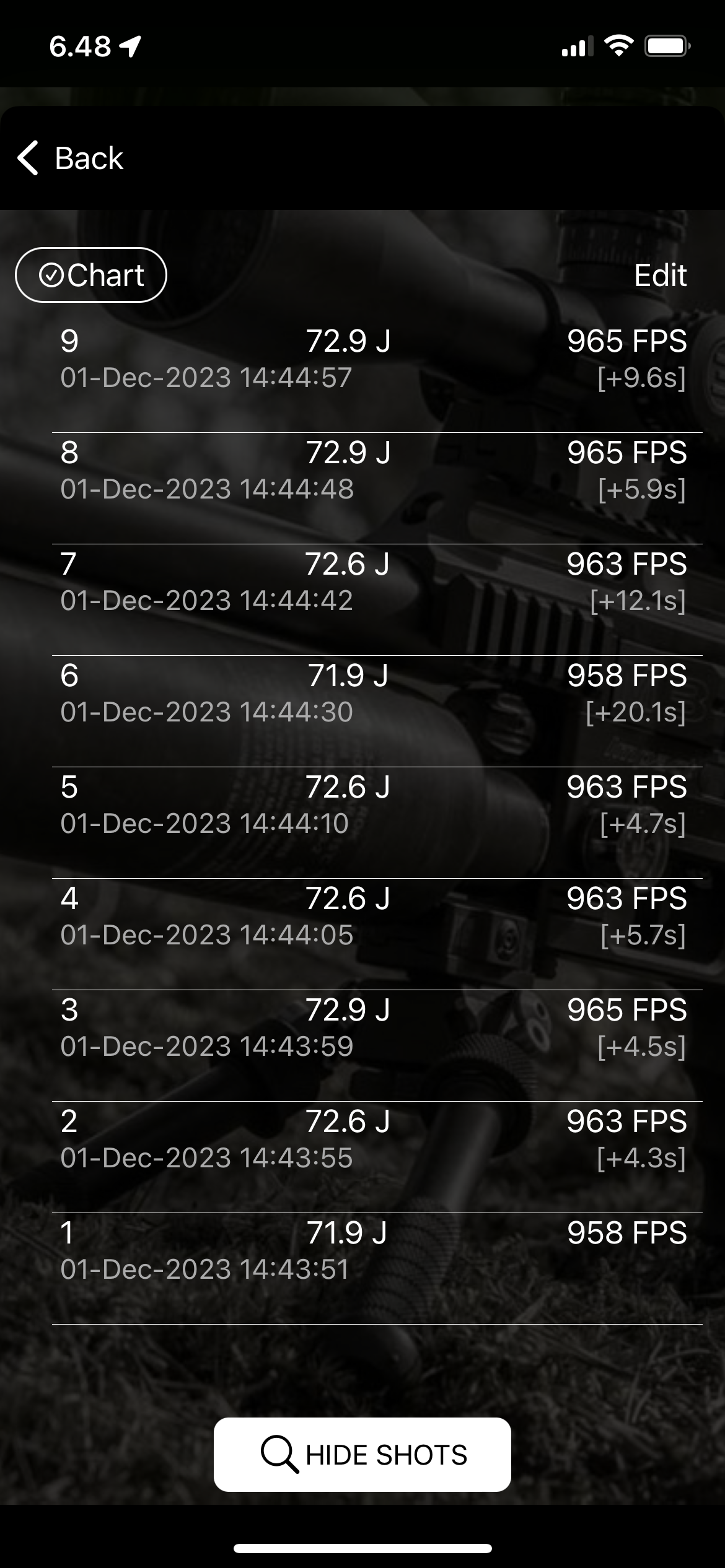

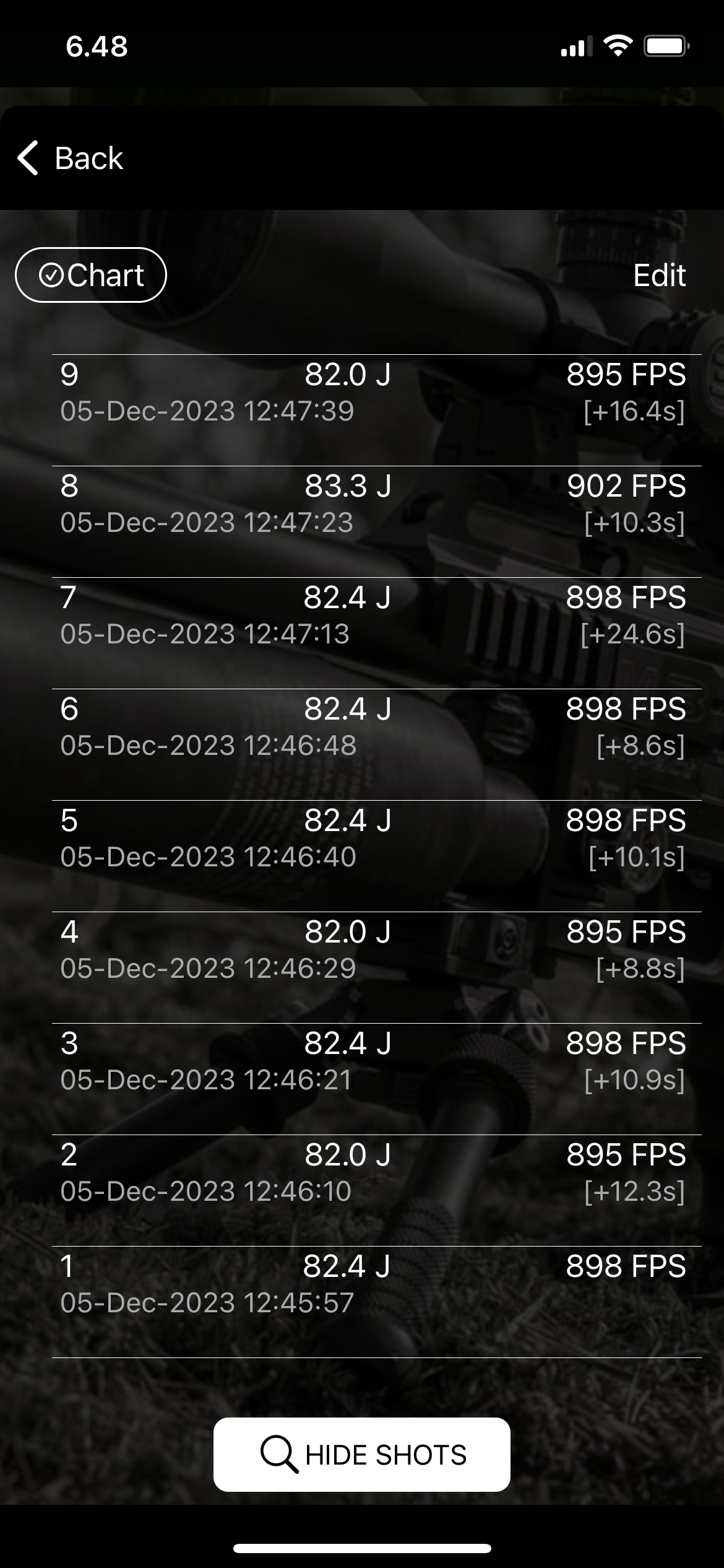

Here is what I had:
26gr Hybrid:
33.95 JSB:
Mikko,
thanks for the numbers: 👍🏼
🅙 JSB 33.95gr at 897fps = 60.7FPE
🅗 Hybrids 26gr at 963fps = 53.5FPE
Yes, that's 7.2FPE difference, similar to the first numbers (7.7FPE) I calculated.
➧ Yeah, unless Frank or someone else has some numbers to show me in error (quite possible! 😆) —
I think about 4FPE loss are due to being a slug, and about 3FPE loss are due to being a projectile much lighter than the other.
Matthias
