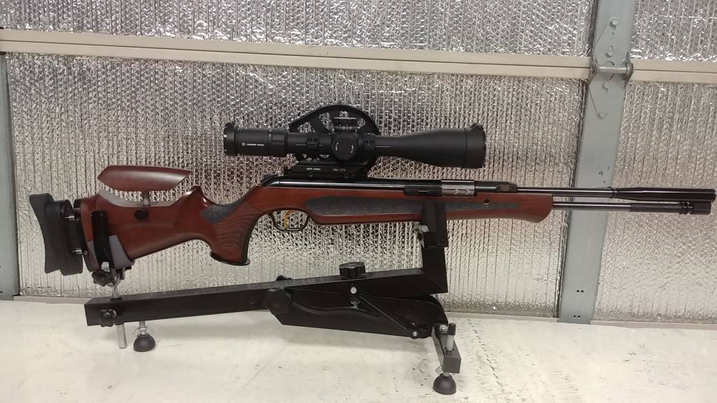

I hope a lot of folks order triggers from him. BTW. I successfully disassembled and reassembled my trigger clam shell. The trigger guard now installs in the correct orientation and I have my LGU installed in the wood stock I purchased. Scope and scope mount are all that's left-soon!

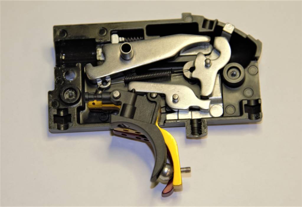

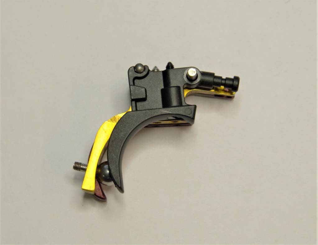

When I ordered mine long ago, a set-back version was noted as an option unless I'm remembering poorly. That is possible but I don't think so in this case. One can state that BOTH are "set back in relation to stock", but "set back" was an option to choose when I purchased mine from him so logically one might assume that in HIS triggers, one is more "set back" than the other. Not just in relation "to stock". JMO. I have the CURVED version in my LGU.
I felt that I should upload the pictures below showing the relationship of both custom triggers in compared to the OEM. The black top one is the OEM. The gold in the meddle is the straight one and the red/burgundy is the curved one. Both triggers rest further back than the OEM one. The curved one, the red one in the middle, is 0.12" (3mm) longer as you can see in the picture. Keep in mind that you can always remove the ball register in the straight one which will make it the same as far as how far back it rests. It is my understanding that the LGU Varmint has a trigger guard that is closer to the bottom of the trigger. The trigger fits perfectly in the LGU Master or LGV . I sold a straight trigger to a gentleman in Serbia, Europe and he had to slightly shave the inside of the plastic trigger guard to make it work. I Just wanted to let you know that about the Varmint version.
Below are his comments:
"...I forgot to mention that in order to fit in varmint stock, you will have to grind the trigger guard a little bit. Trigger is touching insides of the trigger guard and it can be done with sandpaper like remove 1mm. It will not destroy the trigger guard or make it weak just a little bit of sanding… I gave my gun to some club that trains for 10 meter Olympic shooting. I told them to test it as dual stage so that #1 screw gets used a lot. After that they tested it as single stage and one thing they all said is that it's one of the best triggers springer can have. Only few triggers can beat this one and it's those in anschutz, feinwerkbau, walther pcp... pretty much competition pcp rifles but those are different world so not really comparison. They also said that final touches like ball insert is something that helps a lot with consistency. When pro shooters and trainers say something like that, you know it's good…”
Alex from Serbia, Europe

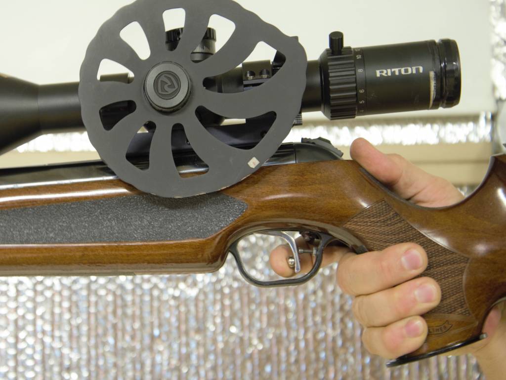

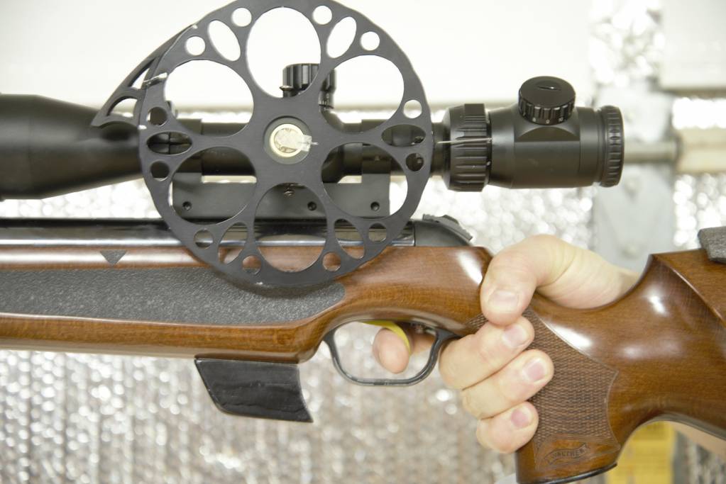

As far as what trigger works best for you it is matter of preference. The pictures below show each trigger and typical holding technique. The curved trigger works best if your thumb wraps around the stock and touches with your pointer finger. The straight is best if you use a pistol grip type of hold where your thumb rests in the vertical top position. The Varmint has a pistol handle so it cold work better with the straight trigger. It is a personal thing.
Let me know if you have any questions.
Thank you,
Eric
