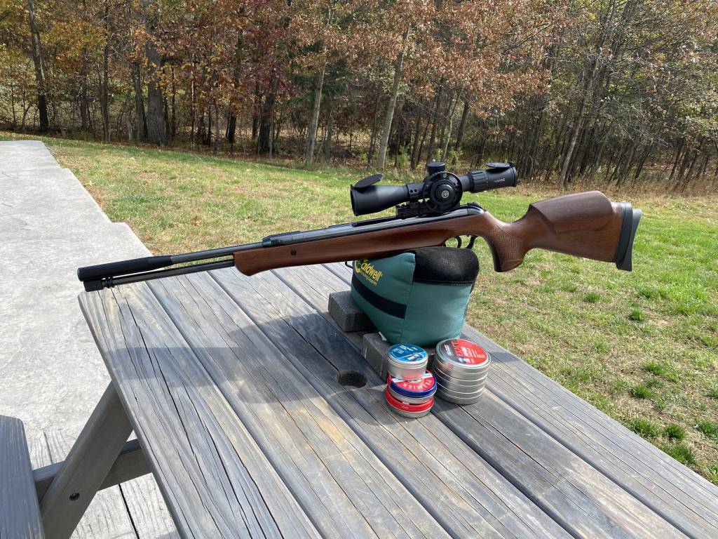

LGU first impression.....wow!
She came on Wednesday, and only had time for a few chrony shots. Smooth cocking and shot cycle. JSB 15.89 doing 640 for about 14.5 fpe. Opened her up this morning and couldn’t believe how much grease was packed inside. Full degrease, quick polish of the spring and comp tube, new moly on the piston and a smear of maccari tar on the spring and now she’s pushing 16-17 fpe and still has a fantastic shot cycle. Tested 10 different pellets so far and all but 1 was under 1” at 30 yards with a 10 shot group. 2 being at 1/2”. The trigger will need some attention but other than that I’m beyond impressed
