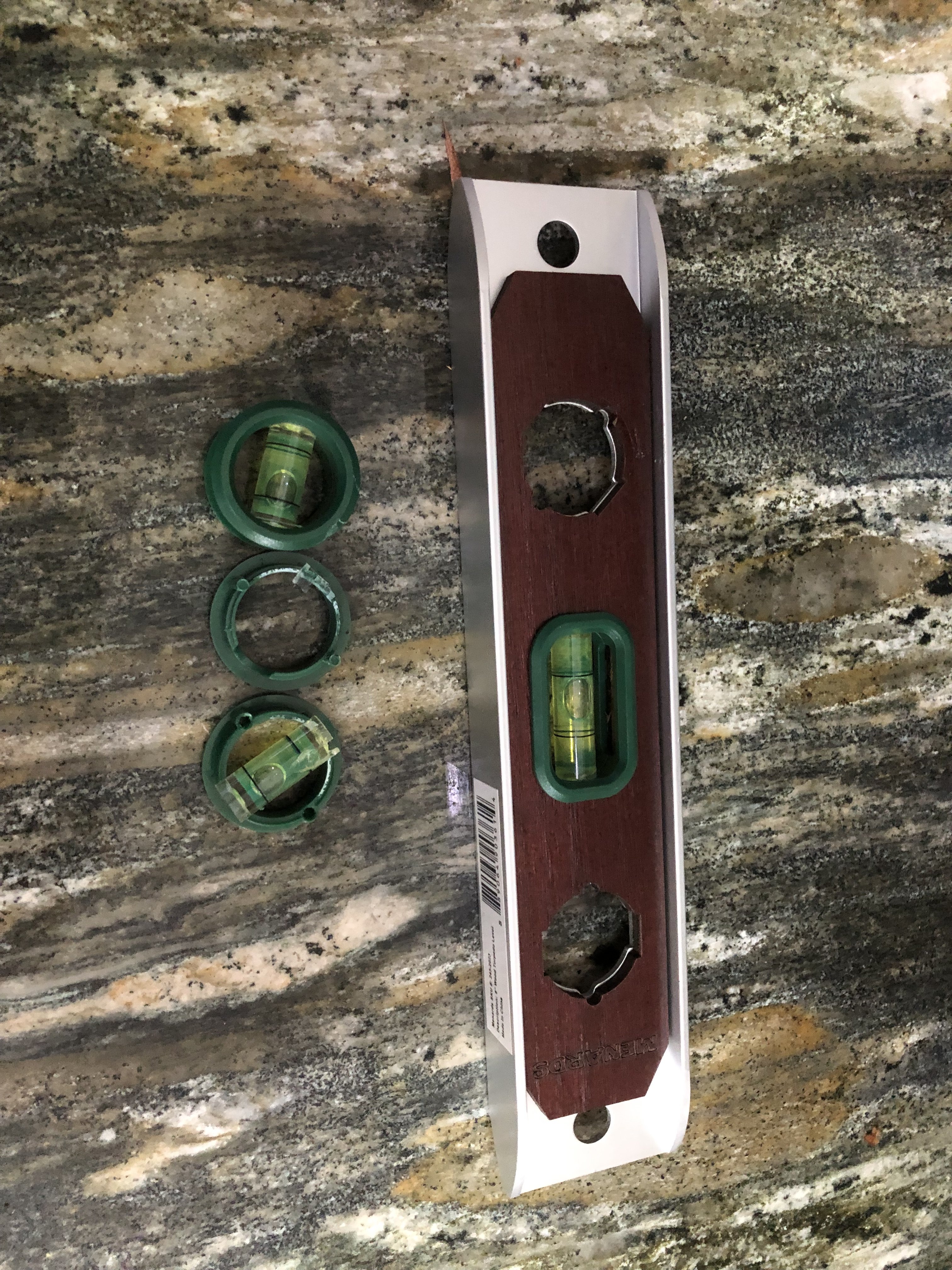

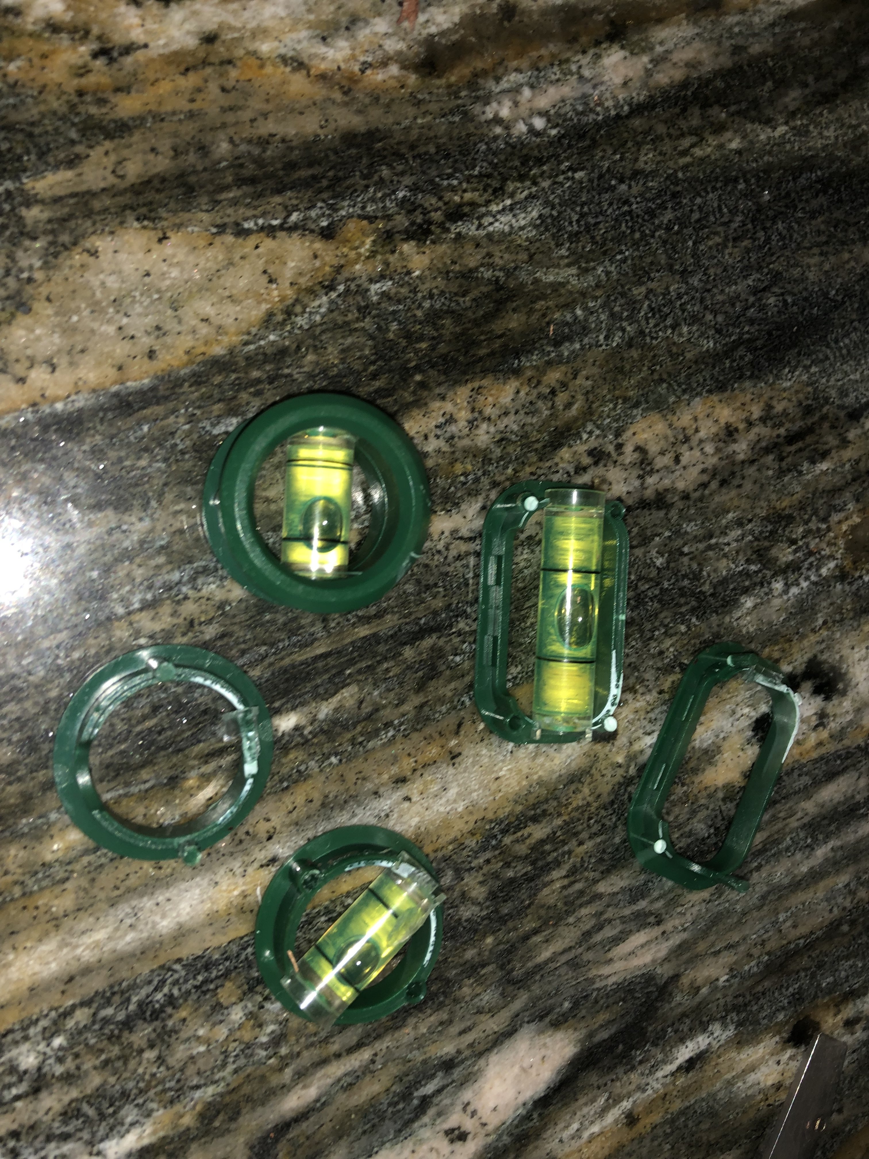

I used 7 dollars of level's bought at my local hardware store. One 5 dollar level with a magnet in it.
I also bought a 2.50$ torpedo level and pulled the three levels out of it.
tim
tim
Is that picture off my bench.. lol. I dont mind repurposeing my well used bent or off level viles . Then maybe why i can hit dirt if aiming at the ground?
