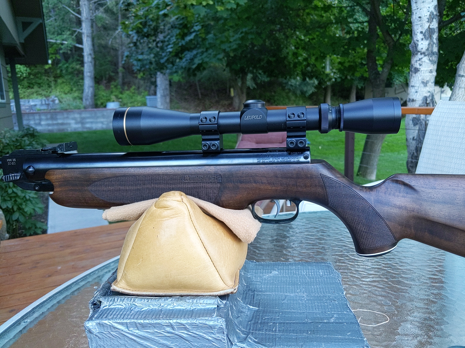

I had an old Leupold VXII 3-9 laying around and I wanted to use it on the HW35. Shooting at 20-25 yards, the scope was very blurry and parallax was terrible. I coundn't keep my cheek weld in the same place and groups were very poor.

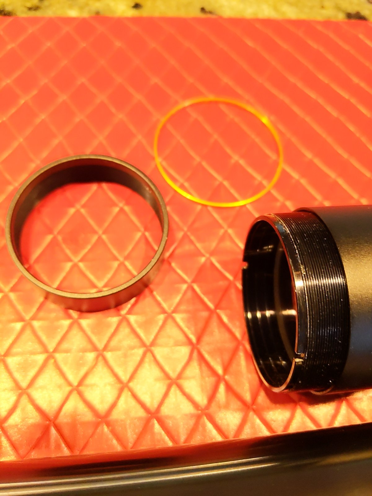

I pulled the objective cover off with a rubber strap wrench and moved the objective group out until I had a crisp view at 33 yards. Now I have good focus from about 17 yards to 45 yards. Easy to do and groups are awesome now.

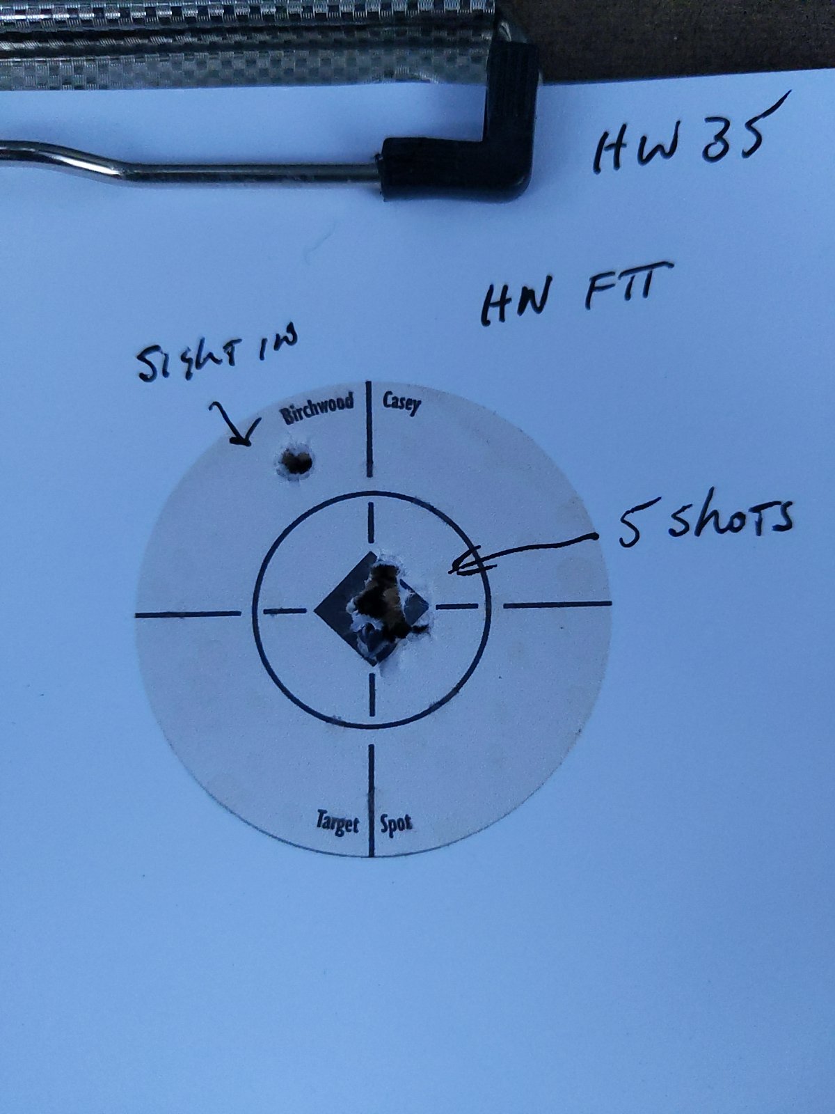

Group was at 20 yards with bench rest. I used Sportsmatch TO4C rings
So you did this on max power? And you adjusted for focus and not parallax error? Or a bit of both?

I'm trying to get away from AO and SF scopes in general. I've used a 100 yd parallax 4x Vantage scope on my Hw50 for a few months and it's been absolutely great. For some reason I can't get apart to adjust the parallax closer. I've done it on others without problems. The 4x hawk is in sharp focus at 11 yards for me but if I get sloppy with my form my accuracy suffers a bit at short range. I've been looking for a non AO rimfire scope for my R1 and the only one I can find that has a reliable warranty is leupold. That's why I was asking about voiding the warranty. Thank you for letting me know these can be user adjusted. Unlike the Hawke Vantage.

I have one scope with a glued lens carrier and I was able to drop small amounts of acetone in there with a syringe until it released. Not sure if that's the problem you're having with the Hawke or not.

The outer ring of the objective bell is not what I used acetone on. That ring actually came off pretty easily. I didn't even have to use a strap wrench.
It was the inner lens carrier with the two notches in it that wouldn't budge. I just kept applying small amounts of acetone, trying to turn the lens carrier after each application. Eventually it broke free.
I assume acetone could also be used on the outer ring, if that's the part you're having trouble with.

When adjusted for sharp focus on high power 9x , the parallax seems to be perfect. Moving my head around does not move the reticle in relation to the target. Before the parallax error would move the reticle at least an inch or so.
