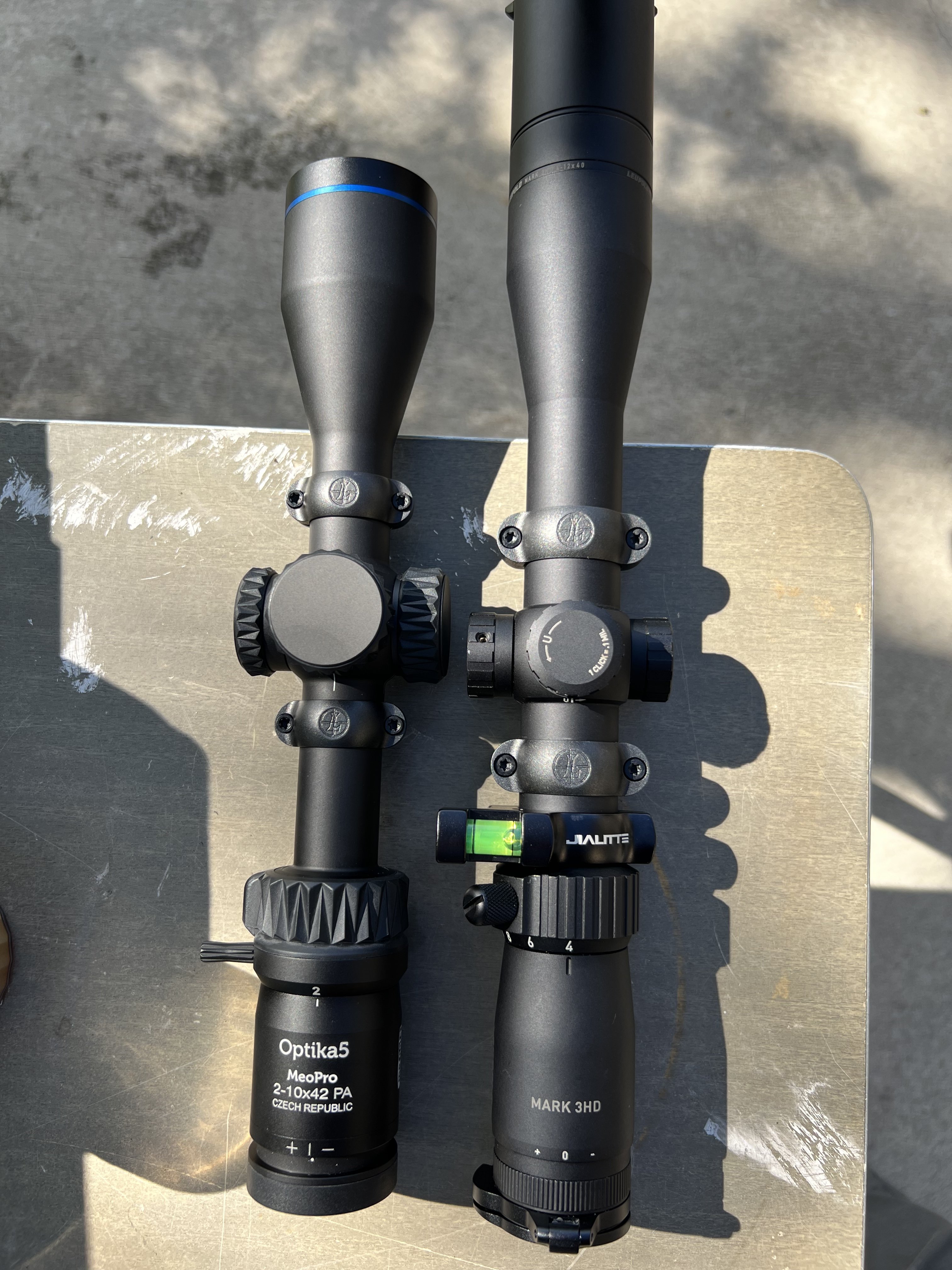

Now might be a good time to talk about scope weight. Scope weight isn't everything but it is definitely a factor in my book. I personally think that a lighter more compact scope may attribute to better accuracy in springers...which can be somewhat hold sensitive. This is one thing that Leupold has going for them. Almost across their entire line up you can pretty much count on it that Leupold's scope is going to be lighter than that of an equivalent competitors. The Leupold 3-9x33 EFR is the lightest air rifle scope that I know of in production at just over 12 oz. The afore mentioned Mark AR Mod-1 4-12 comes in at a little over 15 oz. Even the newer side-focus, 30mm tube, 4-12 variants come in at just over 16 oz! For comparison, the Mark 3HD 4-12 with 2" sunshade, alumina caps, scope level, and Leupold QR rings comes in at 23.6 oz total. That is .6 oz less than the Meopta Optika5 2-10 PA naked(expect for Leupold QR scope rings) which weighs 24.2 oz! But again...the Optika5 focuses down to 10 meters and the Leupold doesn't so the former is obviously a better air rifle scope, right?

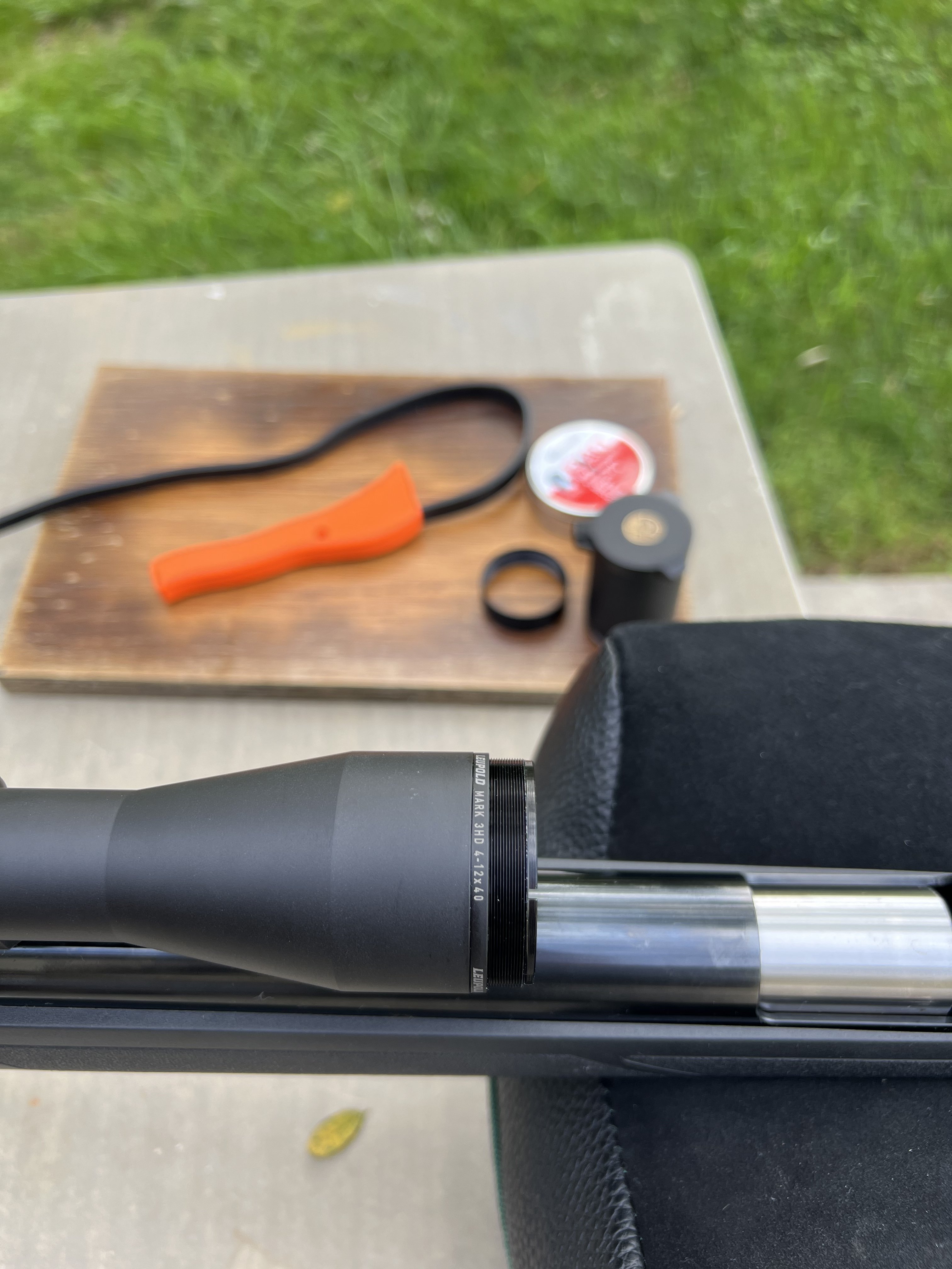

It just so happens, that this little hack doesn't only work for fixed parallax scopes but also for some side-focus scopes. In other words, what if we could internally adjust the parallax of these Leupold scopes to bring the side-focus minimum adjustment down to 10 meters? Well, I did just that! Note!! I am not recommending this and I shall not be held responsible for any problem that arises from attempting this. For the record, I've successfully adjusted two of these Leupold side-focus scopes by myself with zero issues. I do not have experience with the 6-18 and 8-24 variants of these scopes.

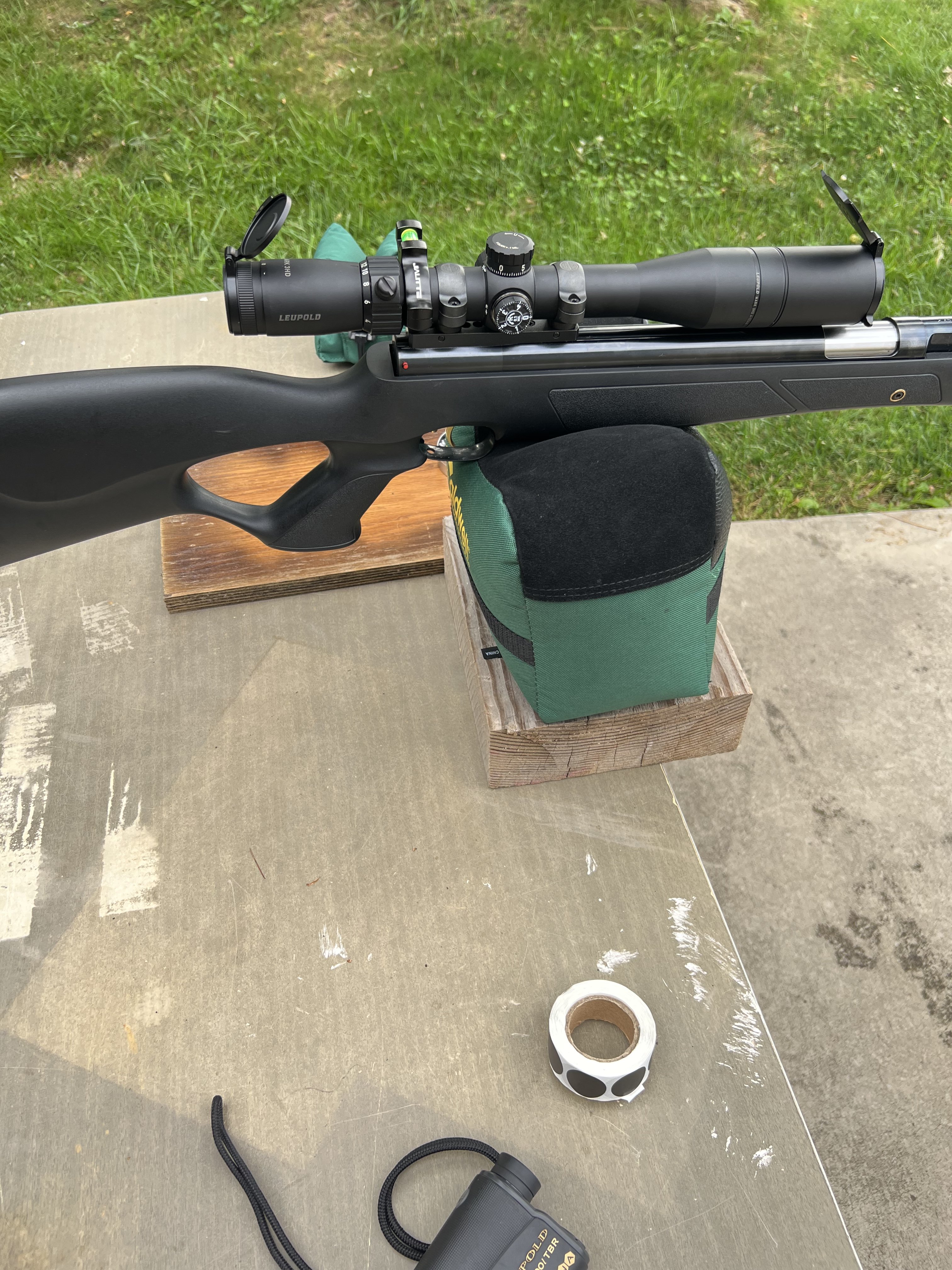

I own the Leupold Mark 3HD 4-12x40 w/ a TMR reticle but found that the closest that it would focus is somewhere near to 25 meters. So, I removed the ocular lock ring and rotated the internal ocular glass housing counterclockwise approximately two full revolutions. This brought my minumum focus down to a razor crisp image at 10 meters! I was elated! Until I realized that the maximum parallax was now...only about 50 meters...FAIL. So, apparently the range of adjustment is not great enough in these scopes to go from 10 meters-infinity. I found a compromise. Rotating the internal ocular glass housing approximately 1/4 of a turn clockwise(for a total of approximately 1.5-1.75 revolutions counterclockwise from factory) resulted in a razor sharp image from 12 meters-100 meters and reasonably clear images at closer and farther distances. Now, at the minimum parallax setting, turning the magnification down to 8X gave a very crisp focus at 10 meters and at 12X magnification a crystal clear focus at 12 meters! Success! For my purposes with .177 springers this is everything that I need this scope to do. The only drawback with adjusting the scope like this is that the maximum parallax setting is now 100 meters. Further distances do seem a touch fuzzy but no different that all the other non-parallax adjustable scopes out there. Longer distances with 12X and lower mag scopes really don't generally need parallax adjustments for the the image to be reasonably clear. Obviously, if they did every big game rifle scope would have parallax adjustment but most don't and are set at a fixed parallax of usually 100 yards and sometimes 150 yards.
Why is this Mark 3HD 4-12x40 TMR Side-Focus my new favorite springer scope? Well, first of all it now meets all three of the criteria that I mentioned earlier. It's 1) reliable, durable, holds zero 2) has very good glass quality 3) and focuses down to 10 meters. Otherwise...4) I'm a big fan of the reticle which is a very thicc and bold TMR, mil based reticle. It's perfect for hunting in the woods or in lowlight situations; very visible and being a SFP stays the same size. If I was precision shooting past 50 meters it would be too thick but for what my Weihrauch HW50 and HW97 can do it's perfection. 5) Custom Dial Compatible...figure out your drops for a particular projectile, send them to Leupold, and get a custom dial that eliminates all calculations. It would be wise to be sure your air rifle is professionally tuned and has settled into a consistent fpe output before doing this. 6) 40mm objective; it's quite difficult to find a 30mm tube scope with only a 40mm objective and the advantage of this is that you can mount it super low and close to the barrel. This gives several advantages...1) less holdover at very close ranges 2) more compact profile 3) better accuracy potential; the closer to center of mass the scope is the more consistent your accuracy will be; particularly with a springer 4) superior cheek weld and easier eye alignment 7) alumina flip caps; if you've never used these before...well, if you know you know
These are only a few of the reasons that the Leupold Mark 3HD is now my favorite springer scope...but the Optika5 2-10 PA is a close second. The advantages of the Leupold is slightly better glass quality and better reticle while the Meopta does focus a bit closer. Maybe just keep it simple and get the Meopta.

I'm surprised to hear you say it took two full revolutions. I started turning the lens carrier on an inexpensive scope to practice on first and from what I read on another forum that it usually takes less than half a revolution and to only go small amounts at a time. I haven't gotten anywhere close to eliminated parallax so maybe I need to be more aggressive with my rotations.
Did you require a strap wrench to remove the ring on the objective?

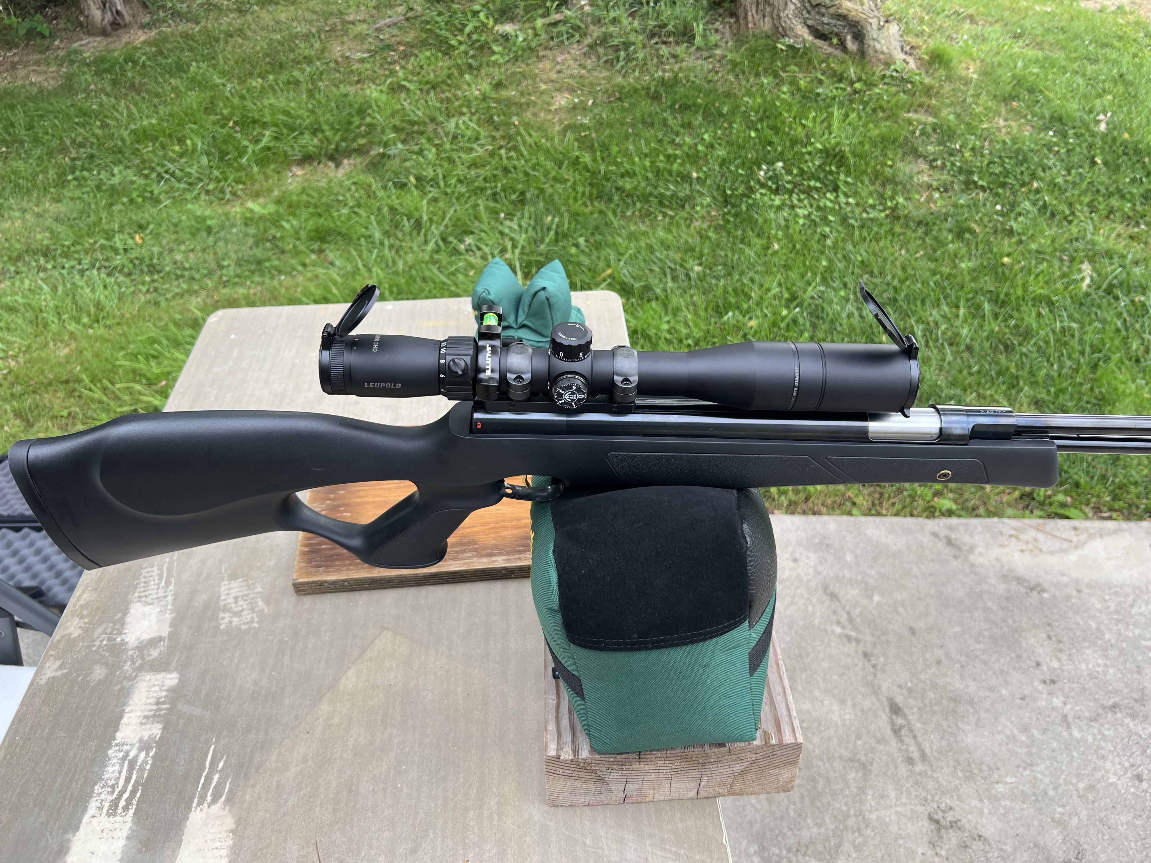

As an update…I took this new combo out(Leupold Mark 3HD/HW97) Saturday evening on a groundhog hunt. Yes, you can absolutely kill groundhogs with .177 springers. I shot two and killed two within about 10 minutes of each other. My HW97 is tuned a bit hotter into the 16 fpe range and they were both inside 30 meters. The first was a chunky fellow at 30 meters and it took several 10.34 JSB Heavy to the head to take him out. The second was at 20 meters and one shot in the back of the head dropped him stone cold. The combo performed very nicely…but I want to re-evaluate the minimum/maximum focus of the Leupold. It seems very forgiving with a wide depth of field which is nice; in other words, the only time that it seemed like the image is blurry at 12X is when the focus was turned all the way down to 12 meters and then further distances were blurry; but it makes it difficult to know for sure if the parallax is set right because it is so forgiving; I believe this may be partially due to a (relatively) low max magnification of 12X. This is all the magnification a springer needs, realistically; particularly if you have good glass that has good resolution and I’m quite impressed with the Mark 3HD’s resolution.

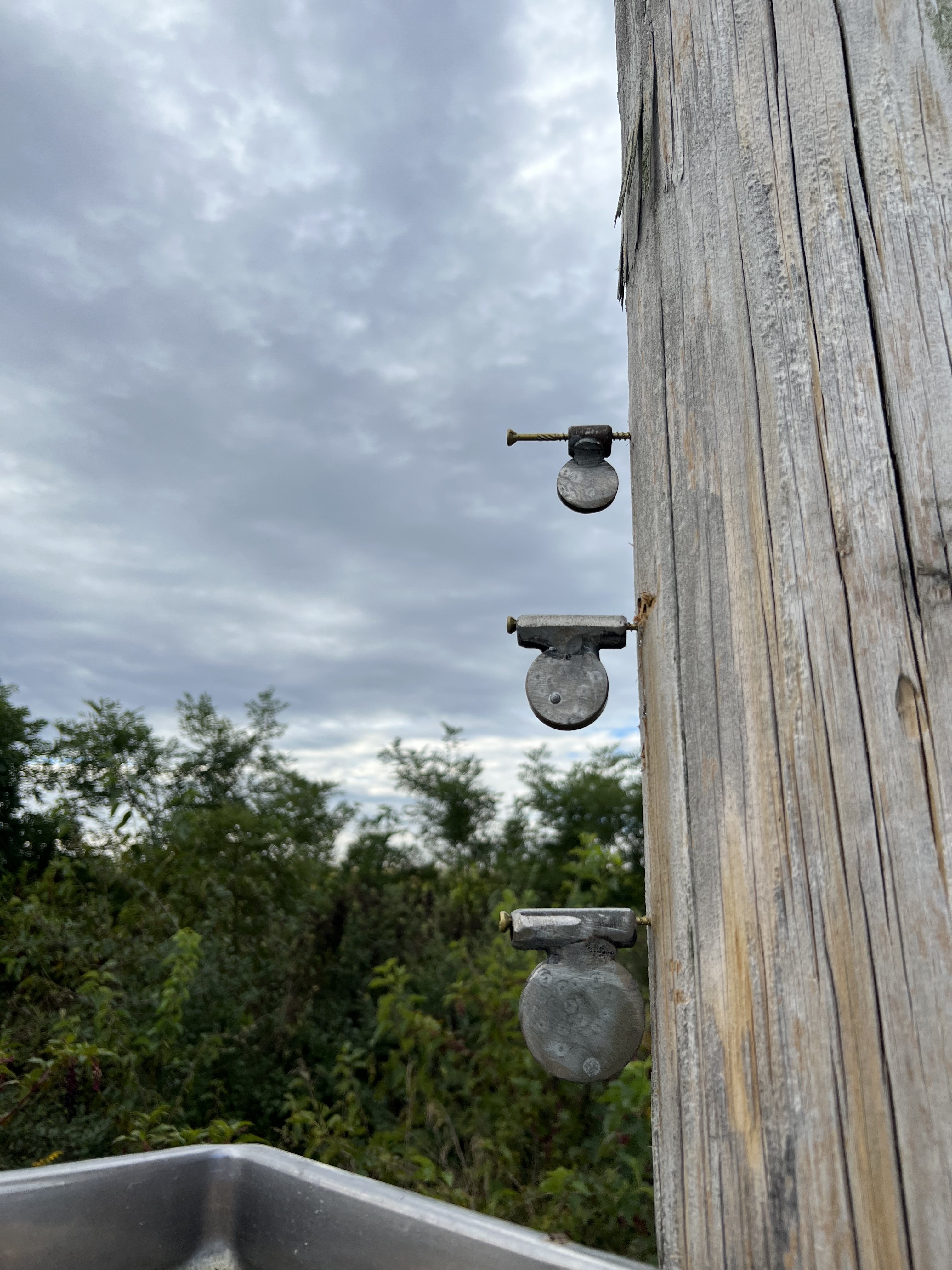

The photo of the 3 steel targets is to give you an idea of the precision these 12X scopes allow. My hits consistency was almost exactly like what I achieved with my 3-18x Optika6. The largest is about 5 cm and the smallest 3 cm in diameter. At 45 meters I’m consistently hitting the middle target and frequently striking the smallest. In other words, it’s more accurate than me.
