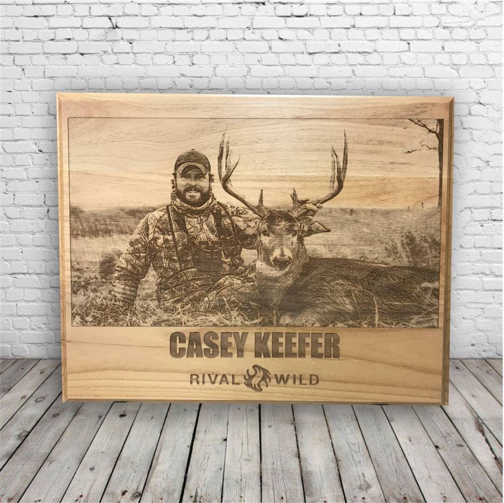

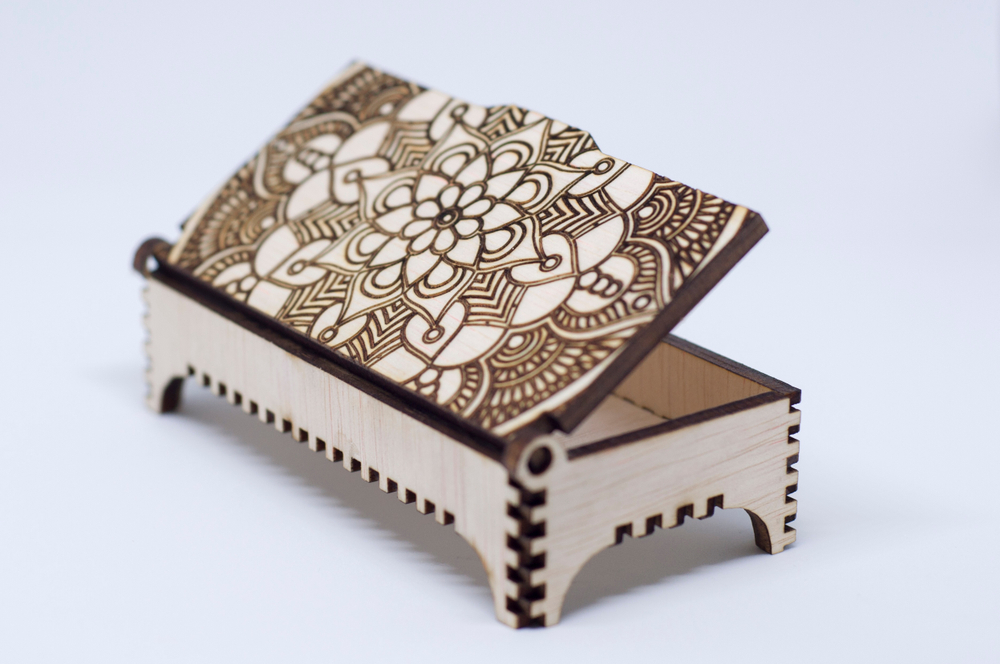

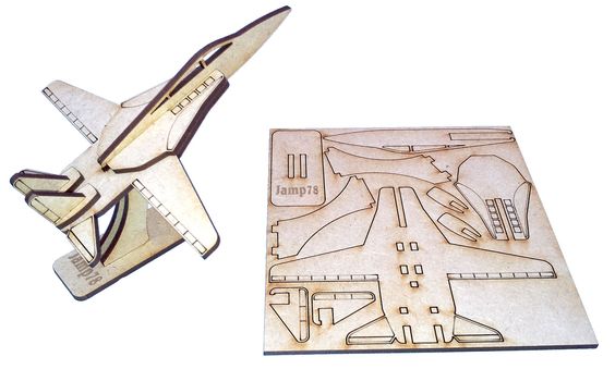

I'm planning to try and make some cool pellet racks, and also some airgun related art. I'm pretty sure I'll be able to turn pictures into laser burned wood creations. Once I figure out that, I would like to hear some cool ideas for either laser cut builds for use with airguns, or ideas for laser prints or posters. Examples below. If anyone wants to get one of these $555 machines just PM me. I can tell you where to order one.
