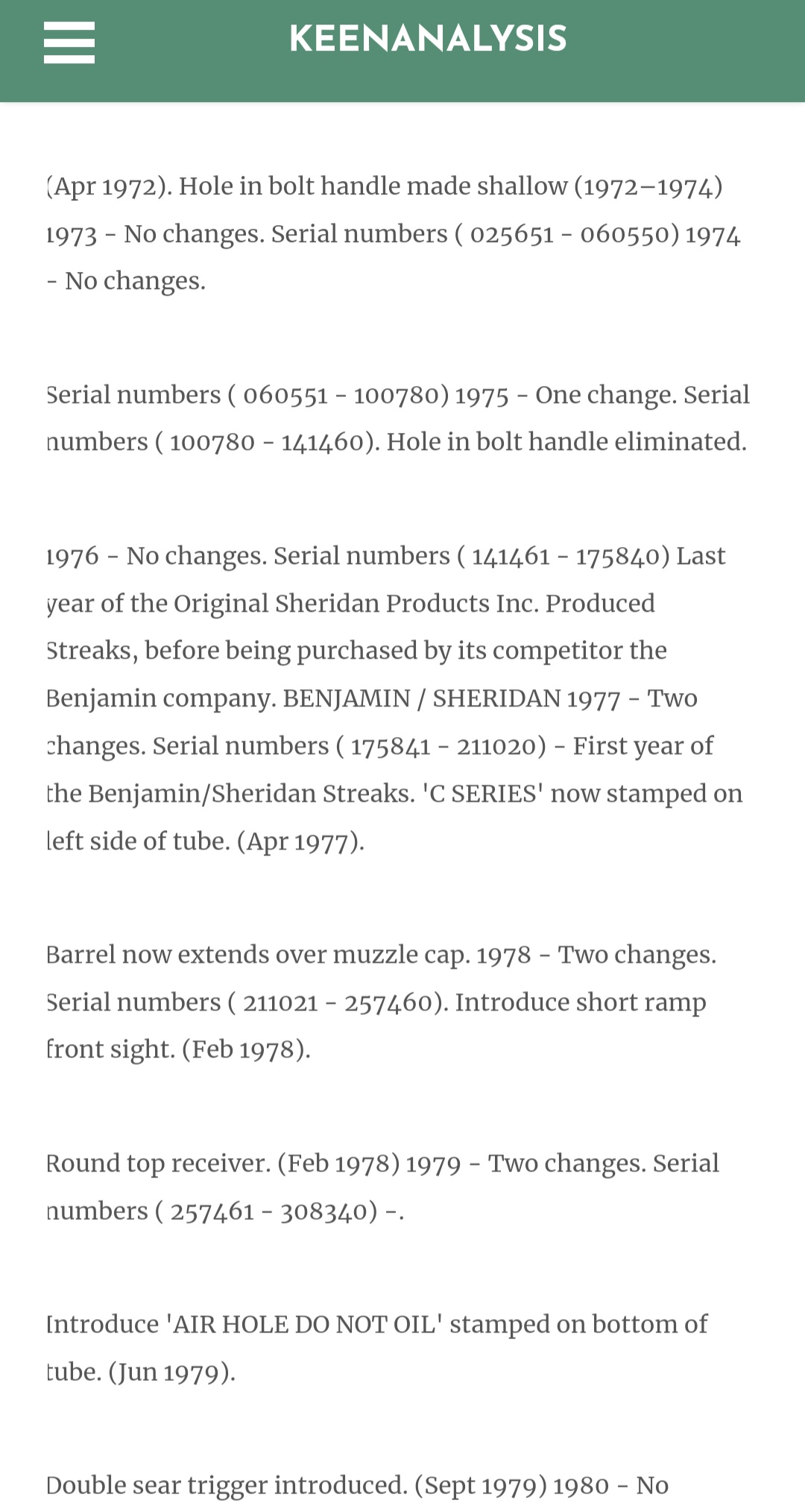

Here are the newer than 1961 model features in photos.

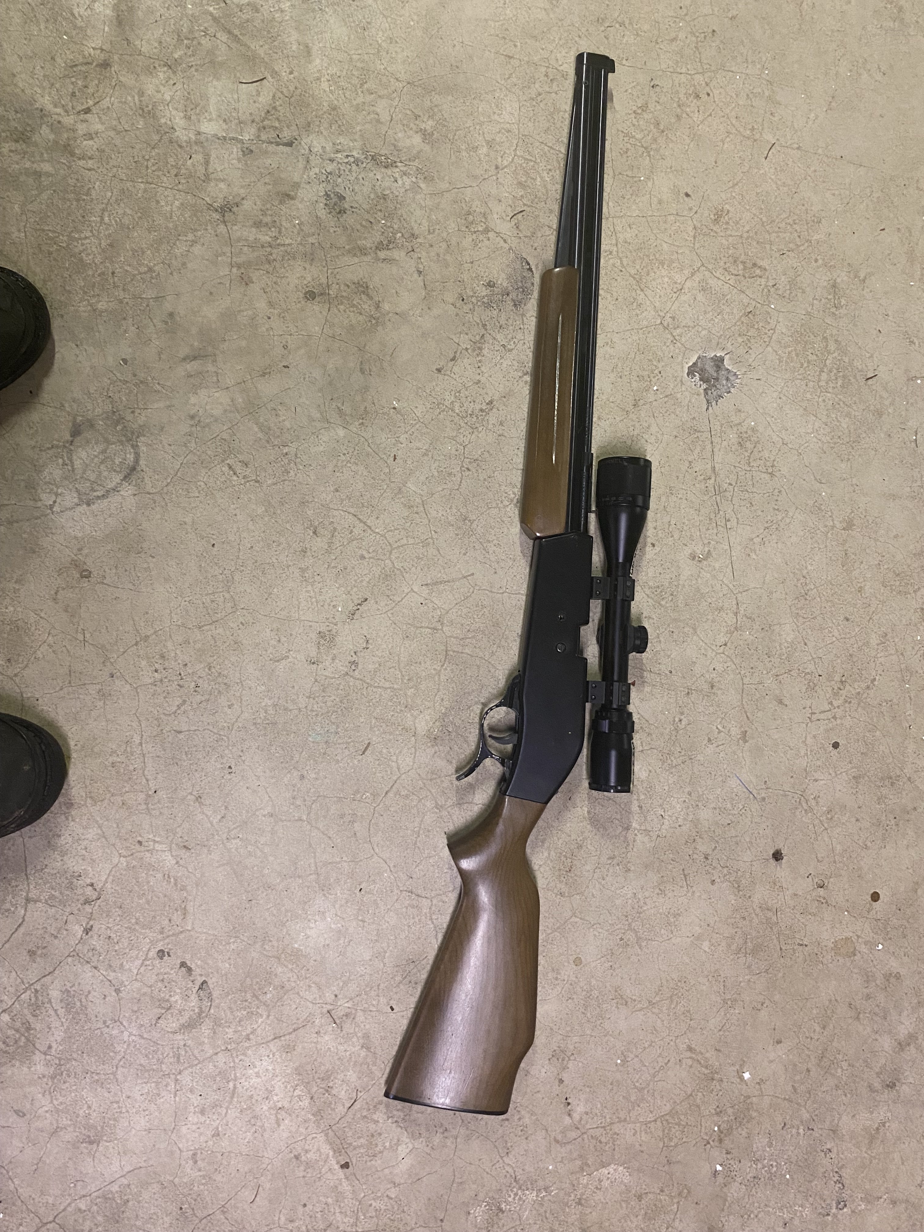

I managed to get a pair of these on eBay. This one is really nice, but the other was just a bunch of parts in poor condition held together with zip ties. Neither one worked, but I did an alcohol flush on this one and after a few hours it started holding air.
I haven’t had enough time to really wring it out yet, but I was getting velocities of around 630 fps with 18.1 JSB’s. After about 12 pumps it stops dumping all its air, but I think that will improve with use.
I guess that would mean you’ve reached the guns max pressure, or the hammer spring is weak.
I suspect it’s the hammer spring. I was hoping it would resolve itself as the lubricant penetrated and parts got used to moving again, but it only got worse with use. It won’t dump more than 2 or 3 pumps now.
I’m a bit reluctant to crack it open as it’s one of those clamshell designs with a bunch of pins and parts sandwiched in between the halves, but that looks like what I’m going to have to do.
