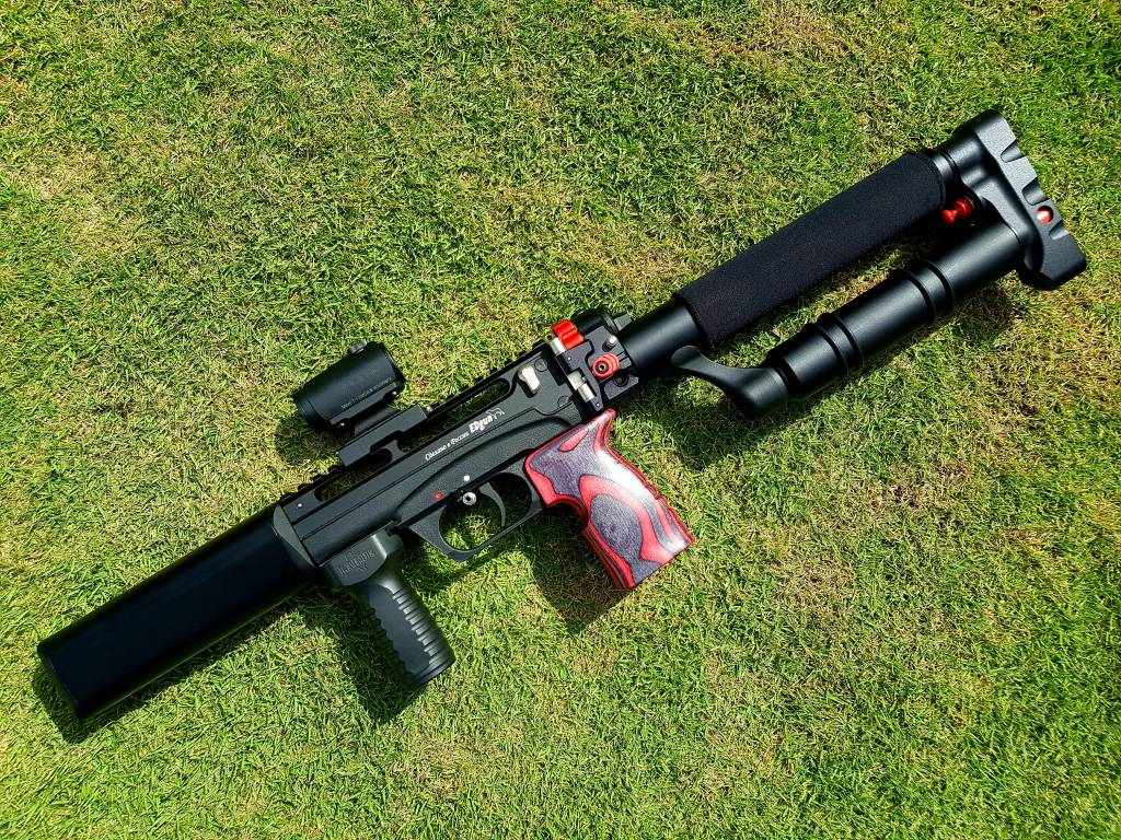

So having had the Leshiy 2.0 in my hands for about two weeks now, I've decided to try out some alternative grip options. The L2 laminate grip is much nicer in both form and function than the tiny plastic grip on the Leshiy Classic but it's still just not quite right for me . . . and is actually probably a little too nice for what will end up being a field rifle. So I wanted to see what grips you guys are planning to use with your L2's.

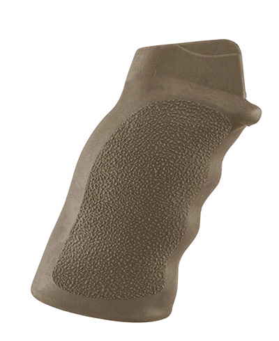

The Ergo Flat Top Tactical Deluxe Suregrip - I have this same grip with beavertail on my Impact and really like it:
https://www.anarchyoutdoors.com/ergo-flat-top-tactical-deluxe-grip-suregrip/

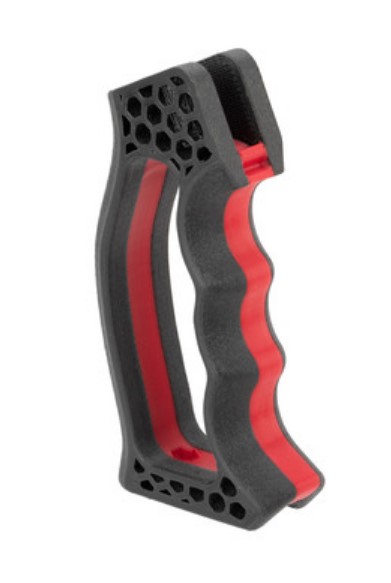

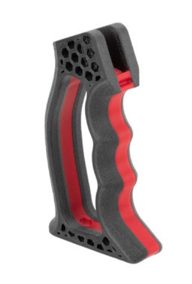

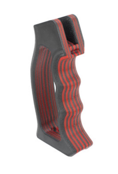

Future Forged Vektor SG1/SG2 Hybrid Two Tone in Red/Black - keeps the factory color scheme and looks pretty cool (other colors available as well):
https://www.primaryarms.com/future-forged-vektor-sg1-hybrid-two-tone-ar15-grip-red
https://www.primaryarms.com/furute-forged-vektor-sg2-hybrid-two-tone-ar15-grip-red

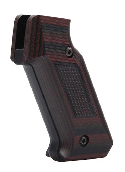

Future Forged Vengeance Vektor 2 Red/Black (very similar to factory laminate style):
https://www.primaryarms.com/future-forged-vengeance-vektor-2-ar15-grip-red

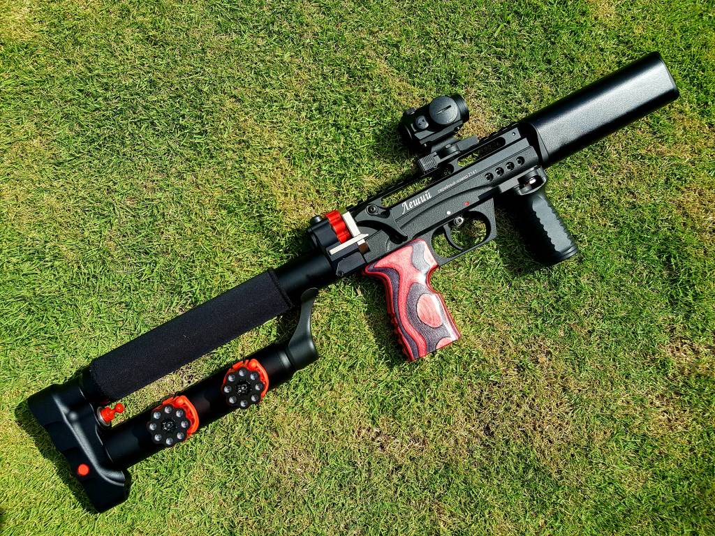

I will probably just go with a Hogue.
That's the stock grip that came on my Impact...I hate it :) I have mine sitting unused on my bookshelf and thought about installing it just to see what it would look like but decided it wasn't worth the effort if I'm not going to end up using it in the long run.
Edit: Leatherman posted his pic just as I was writing this reply . . . that Hogue doesn't look too bad on the L2. Maybe I will try it out after all! ;)
@leatherman - I just tried installing the Hogue from my Impact and it wasn't easy b/c the factory Edgun screw is about 1/2" too long to use with the Hogue grip. Did you use washers or some sort of spacer . . . or did you get a shorter screw?
I used the spacer that came with my Ergo grip but it's not ideal since I can feel a little wiggle on the grip. Will probably go to the hardware store and pick up a shorter screw.
EDIT: picked up a 5mm x 25mm (0.80 pitch) socket cap screw at the local hardware store and that fits the Hogue grip perfectly (the factory socket cap screw is 5mm x 35mm).

I just used the stock screw but I had to add a washer, the screw head is too small for the Hogue grip. Brian had made a video while back where he installed an AR grip on his prototype and there he stated you would need a shorter screw. But mine worked fine . Go figure .the Houge grip is rather smallish so if you have large hands it may not suit you but they offer a slip on sleeve that increases the circumference. The Ergo and Mag Pul’s are beefier. I plan on getting a carbon fiber bottle when they are available From EdGun if the price is right and if EdGun offers one short enough to still use the Hogue grip. There are some on EBay that would work but I’ll see what ED offers. I’m getting around 50 shots on my .22 380mm on a 300 bar fill at 120 bar reg. That’s fine for the light .22 pellets but I’m going to be increasing the regulator to push my .30 450mm at a decent velocity and see what it does for heavy .22 pellets and slugs so the bottle is definitely in my plans.

Hmmm, I think your Hogue grip and mine might be slightly different on the inside (mine came with my Impact). The stock screw head fit fine but it was way too long (I've seen Brian's video on the grip install as well). So I just needed a screw that was about 0.5" shorter.

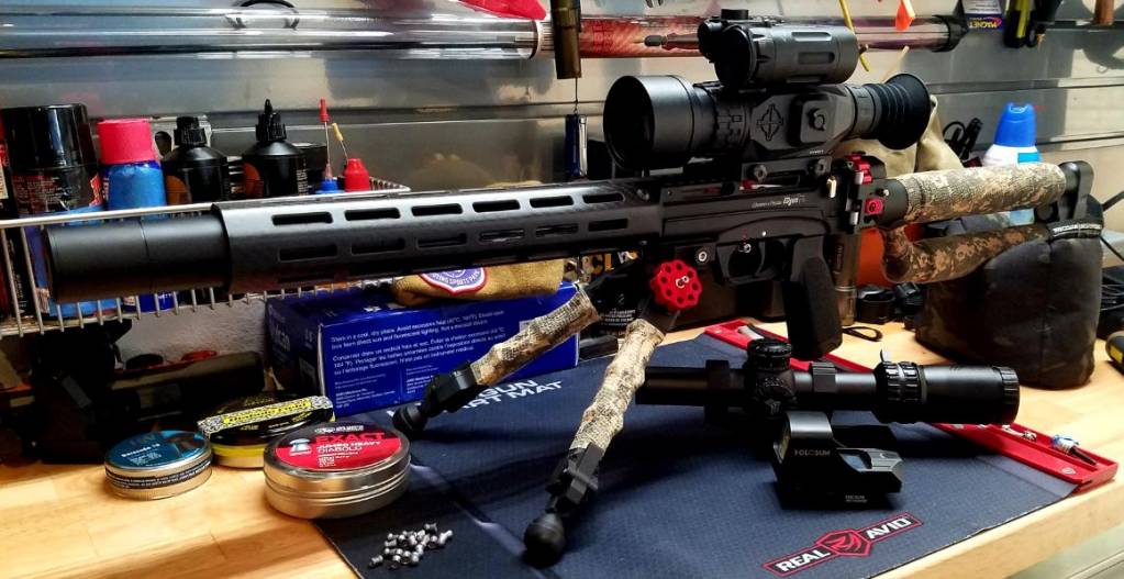

started with a .22 long (350mm) and replaced the shroud with a combo of Huma mod50 (5) and Valkyrie Leshiy 2 Carbon fiber handguard - 11"
as far as i know, that is the only one that fits over the mod50 and 11" is the shortest. here is the full guard and 5-piece mod50.
i am only using 3 of the 4 smaller sections that came with the mod50 when i bought it. this is a purely aesthetic decision because i think the proportions are better.
i cut the handguard so it extended just beyond the muzzle (for protection), which is why i didn't cut back to a flat (looks fine to me).
i put a cheap cf sleeve over the barrel, but honestly think it looks fine without it. meh, i should have gotten a flat finish tube.

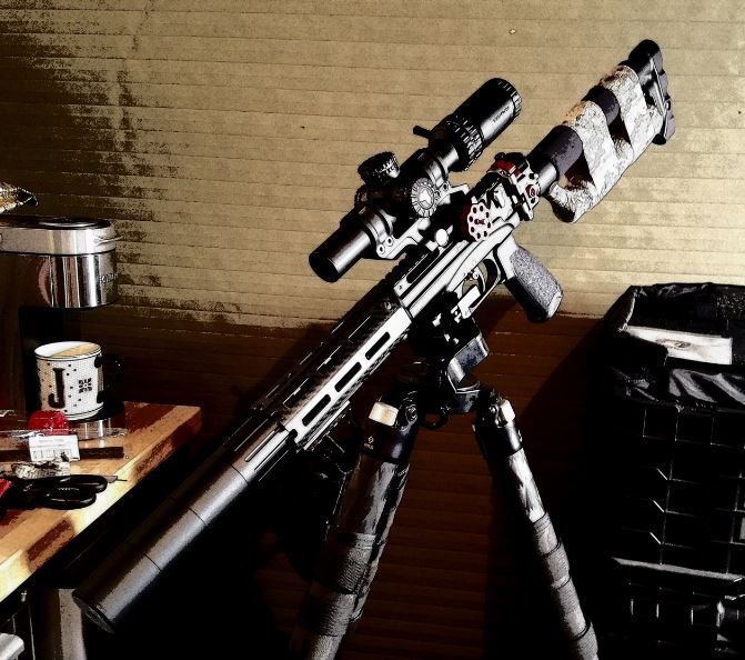

Yes, I bought this originally to go on my impact, but I hated it and went with a slightly raked grip (15 degree) from fab defense, and loved it. Figured I’d try it out on the leshiy as being as I already had it, and it’s a completely different feel.
