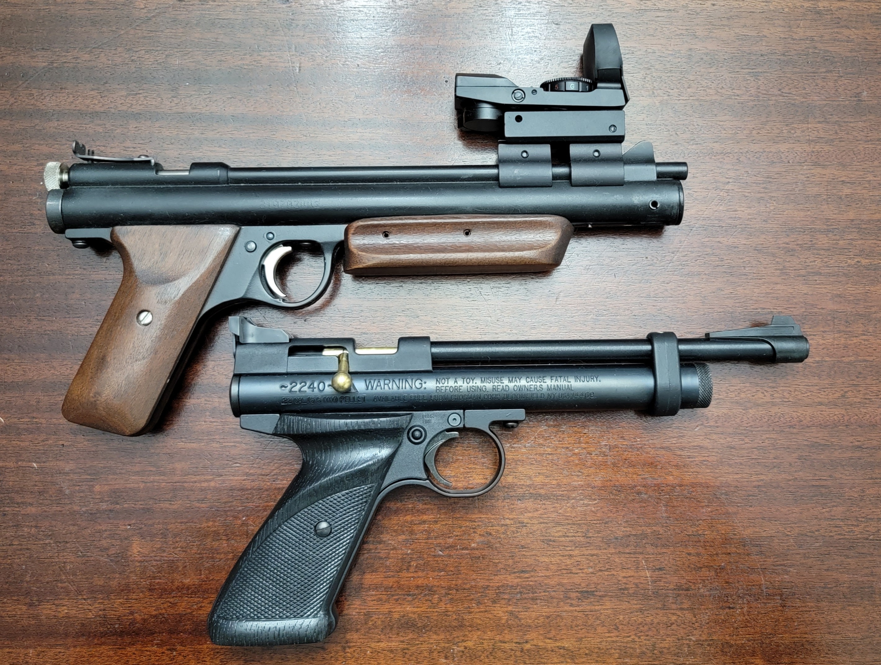

Let's see those 2240 builds!
My first 1377 rebuild.

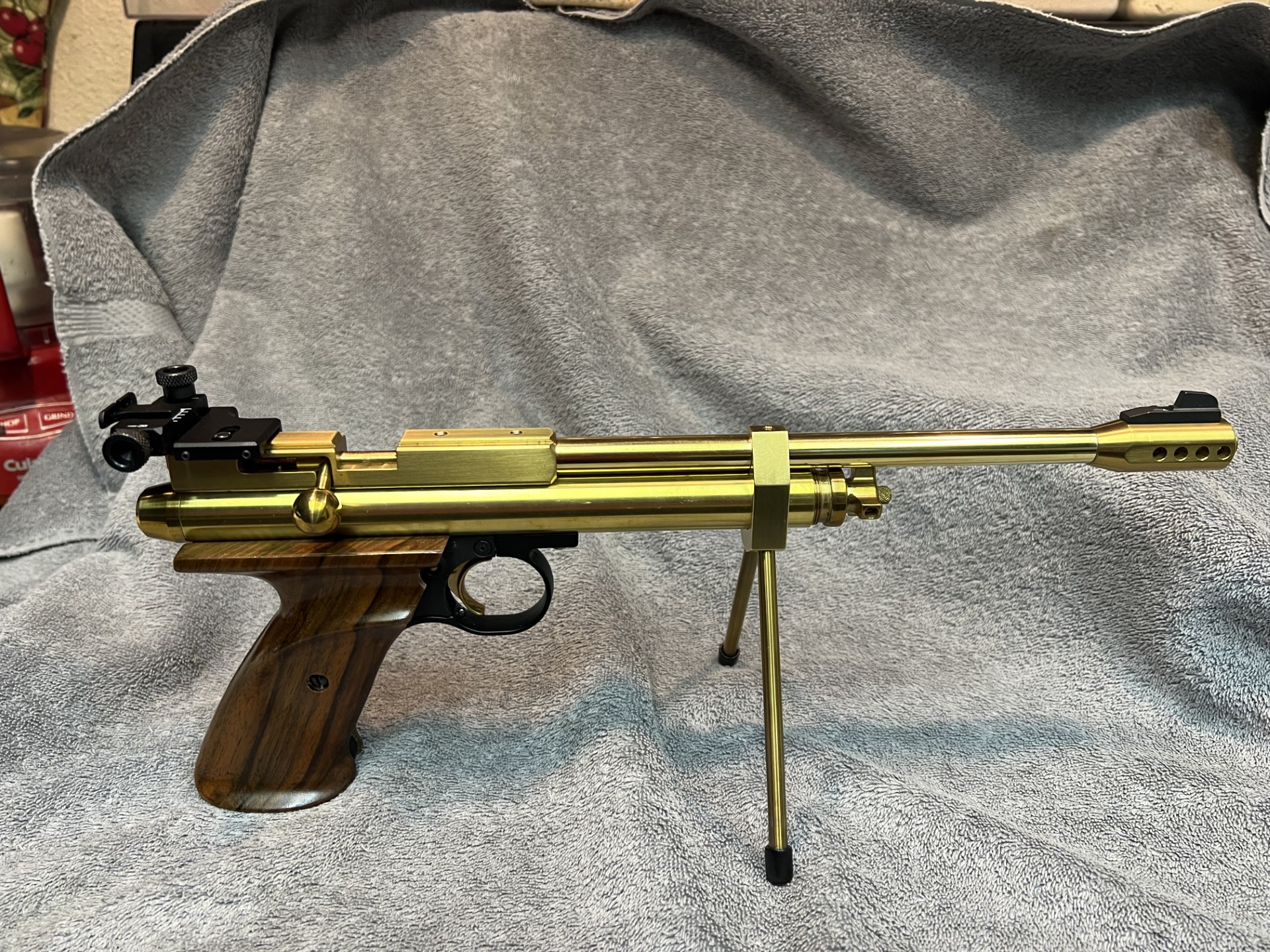

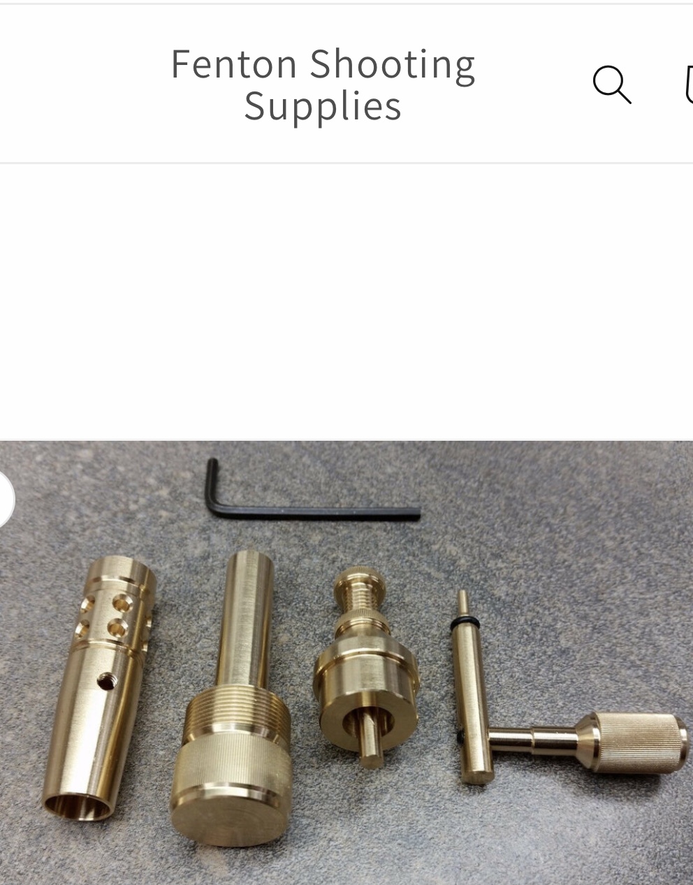

Building another one but waiting for some parts.

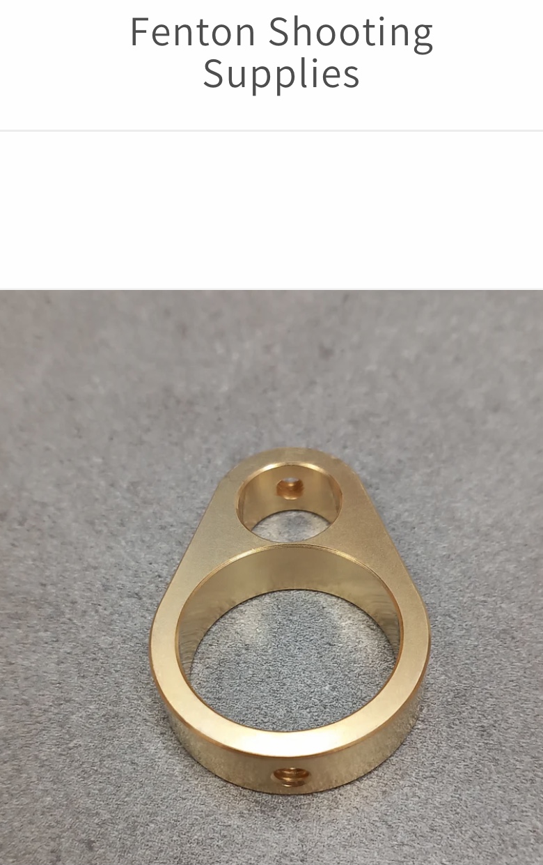

I don’t have a brass-festooned Crosman in the US (have some in my native land), so I’m constructing one.
My 1st time to order from Fenton SS in the UK but they do have nice reviews——and they’re very affordable…More so if you buy a pack in lieu of individual parts. I paid a measly $61 including shipping, a bargain, truly :coffee:

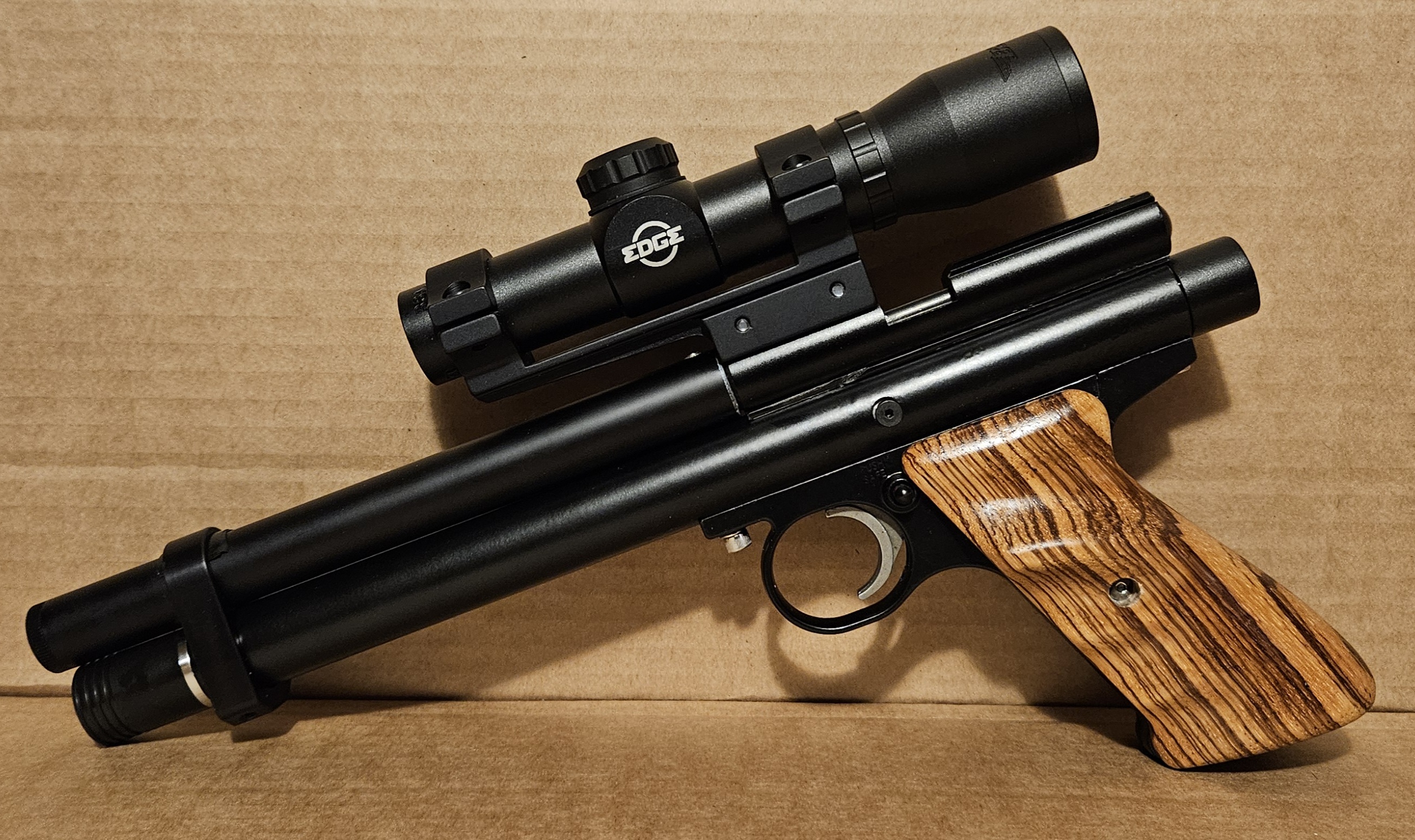

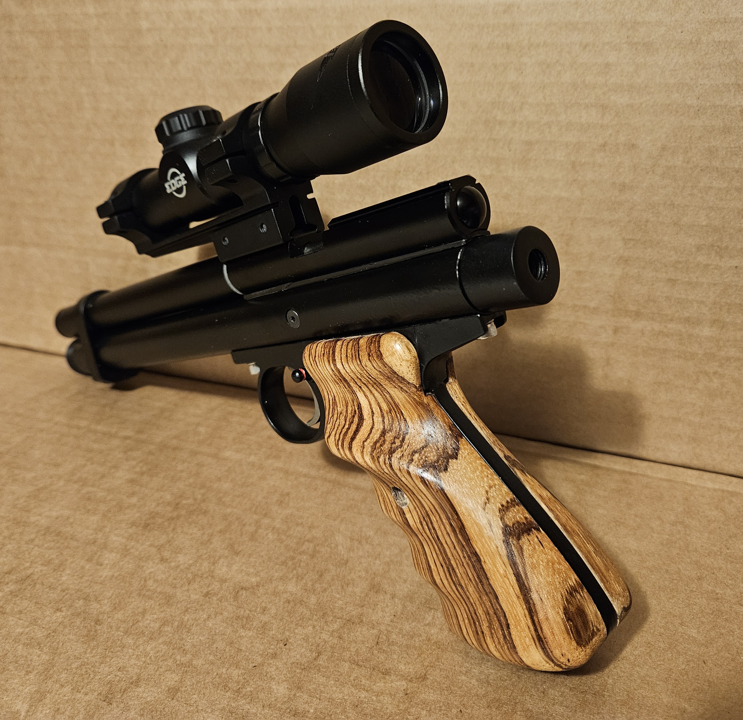

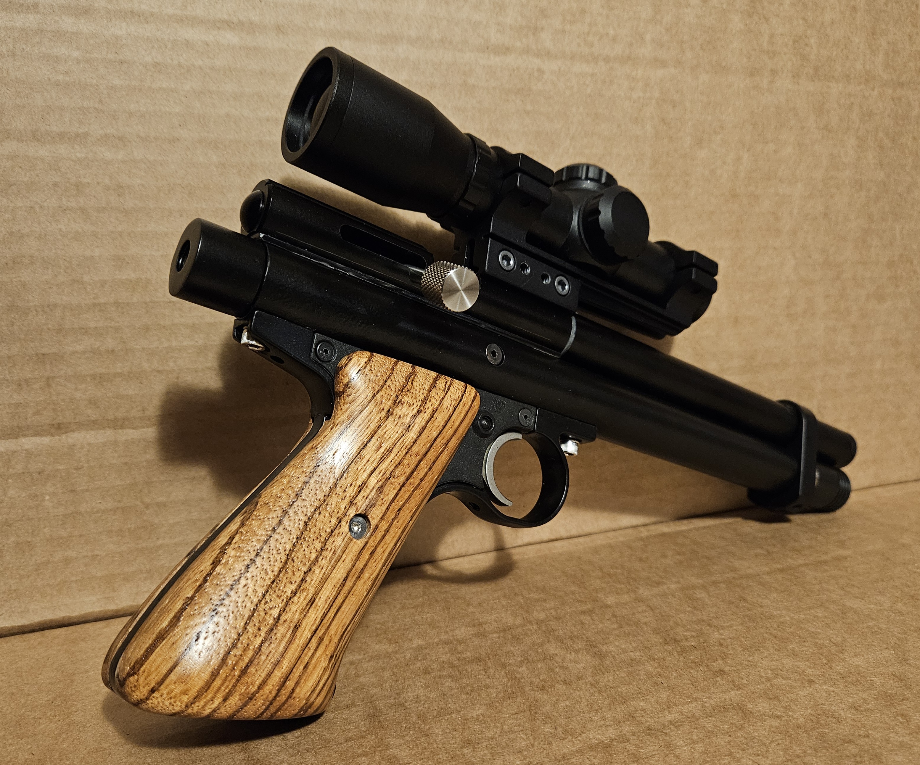

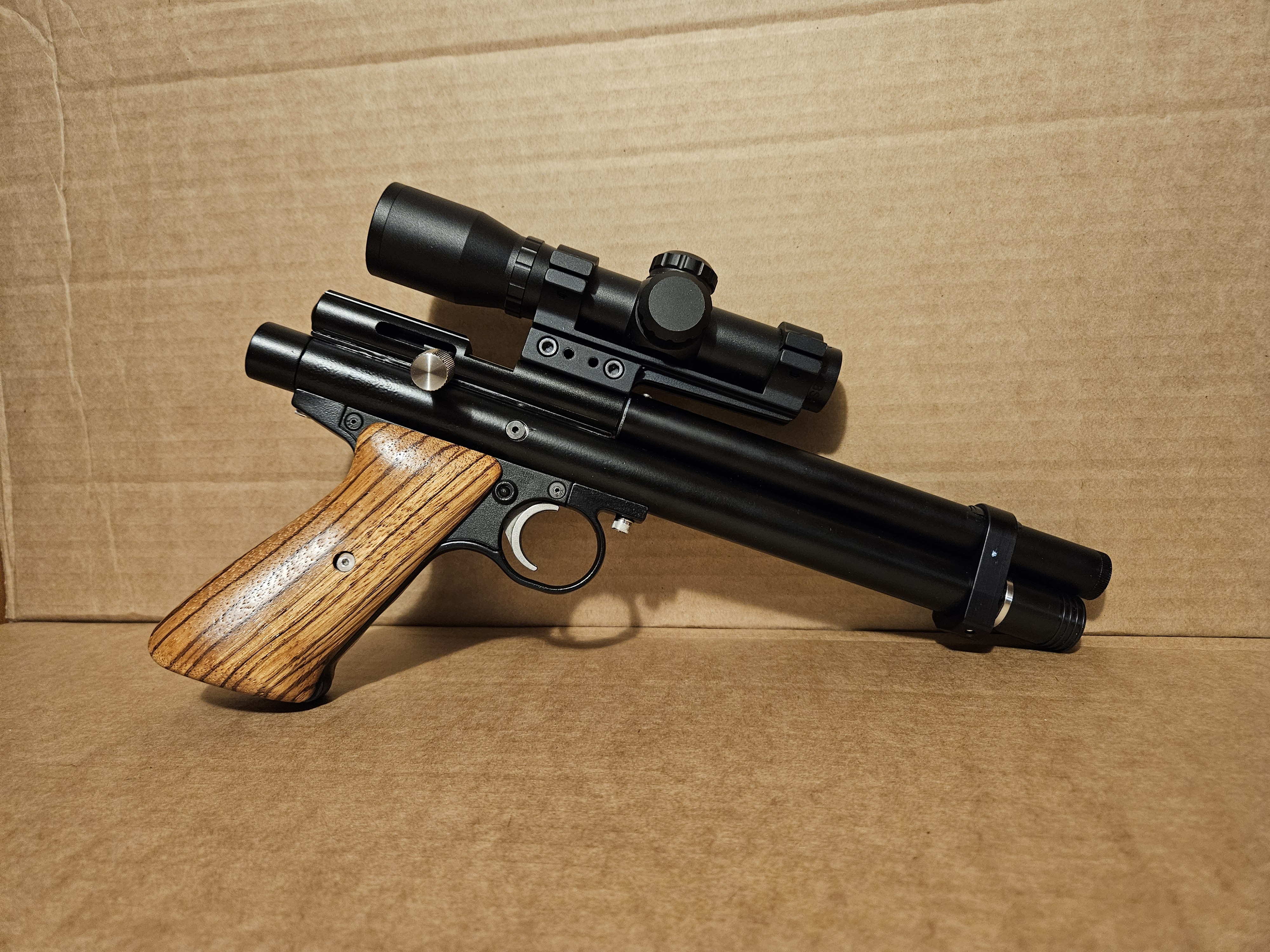

Just finished this one up. Custom tube i made from a cut down fortitude tube i had used the rear section on another build. It's a bit longer than a 2400 tube.
Uses a disco valve. Prod trigger and magnum airpower poly core hammer. Made a breech riser from aluminum. Cut a 2240 barrel down to 6" and has a Prod air stripper and a couple small baffles. Decently quiet when around 10 fpe, but it barks when cranked up. 20 fpe out of a 6 inch barrel is going to be loud lol.
Zebrawood sport grips from Alchemy Airwerks. David makes some damn good parts. These grips fit the frame with zero wiggle like some others I've had. I just need to put the extended stainless probe in it and it'll be 100%.

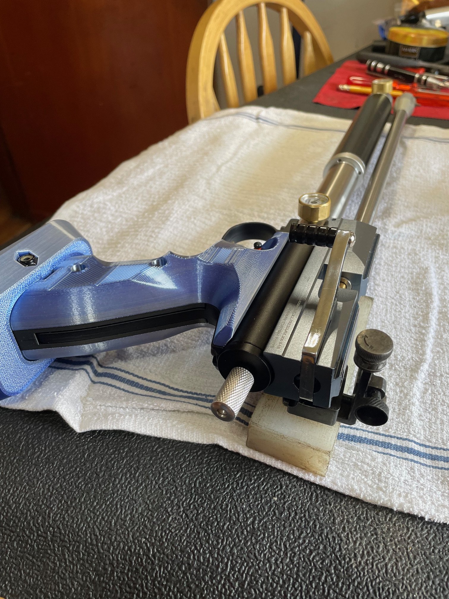

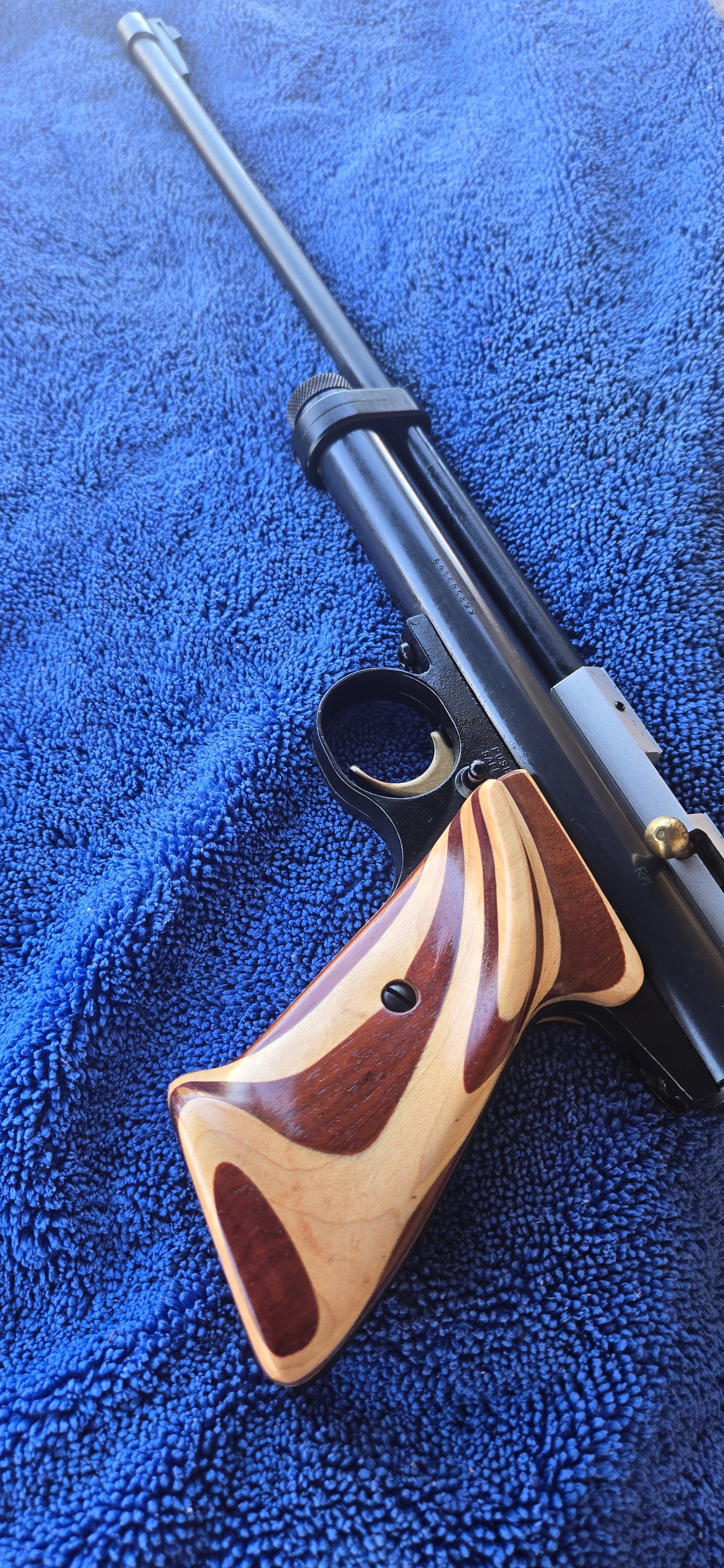

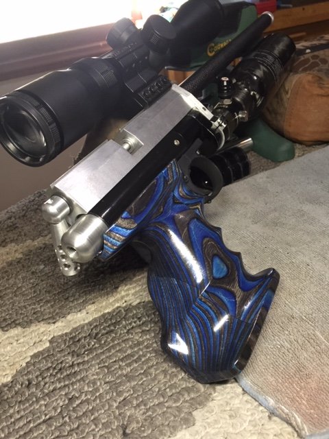

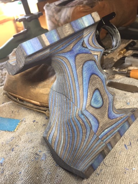

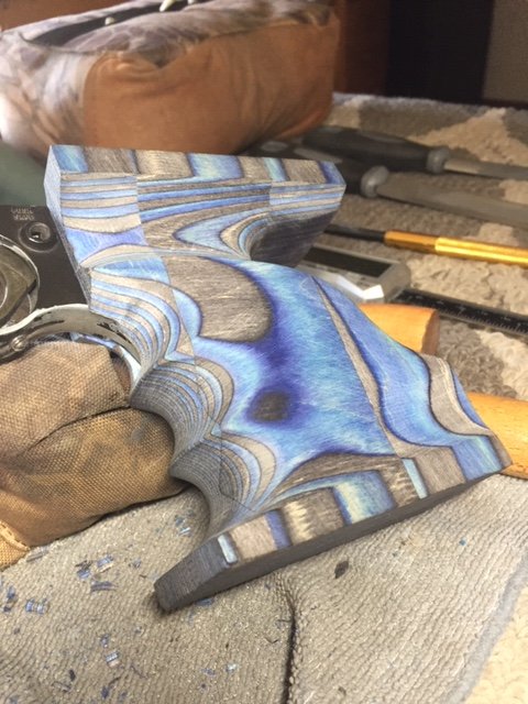

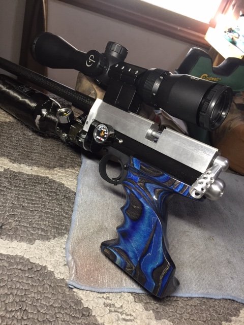

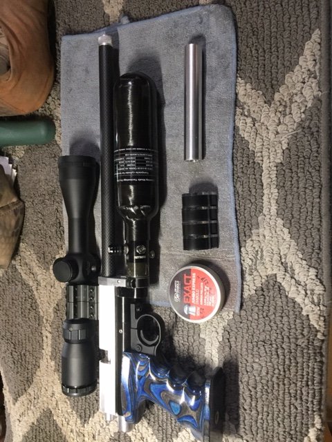

I don't know if I've posted this in here before. This was my attempt at making a target PCP pistol a few years back. 200 cc CF tank, 12" Lothar barrel, modular valve system, home made multi shot action w BRK style bolt handle. This was my 1st attempt at blind inletting, 1 screw under the grip some I could keep trimming it for comfort.
Simply awesome! I'd love a grip and breech if you'd be interested in making any more. No pressure! 😎
View attachment 539136View attachment 539135
View attachment 539137View attachment 539138
Nice grips 👍

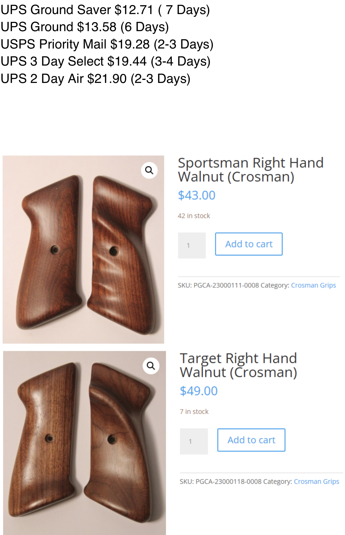

They're from the same company that used to supply Crosman's Custom Shop:
I think their website is under construction, so you cannot purchase a pair online, but orders via phone are accepted, AFAIK.

The brass parts from the UK arrived today.
Super shiny even though I haven’t polished them yet 👍
I talked to this lady a few hours ago and I was told they do take orders by phone…or you can send her an email.
I forgot to ask her about the shipping fee though but I sent her an email; I’ll post it here.

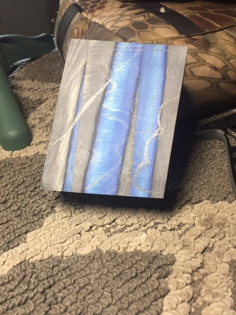

I’m looking at the Target and the Sportsman R/H in walnut because Vernon Austin, mi paborito grips maker, hasn’t gotten back to me, so I think he’s truly retired. I have about 10 pcs. (?) of assorted items from him.
