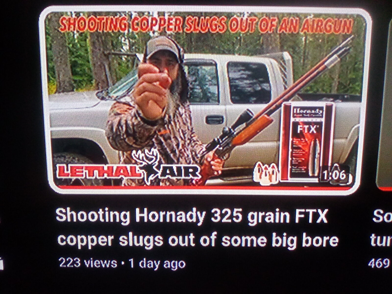

Lethal Air shooting copper slugs in some big boresšŸ˜€šŸ˜€
Up North Airgunner did a test on them some months ago:
So far only avaliable in .50 cal.
Reactions: qball and ThomasT

In the video they are shooting regular hornady ftx copper jacked bullets. Not special airgun ammo like.the Lehigh defense. I couldn't tell from video if they were using a different barrel steel or how they accomplished it. Both airgun s had custom barrels to fire the copper. I give them credit for trying. Look forward too more testing.. I'm good with casting and powder coating but for the average hunter being able to buy normal ammo from hornady nosler Sierra a big plus. Copper jacked ammo.from powder burner company's are cheaper than airgun cast or swaged ammo. Better ammo cheaper for average hunter if they pull.of copper in airgun s.

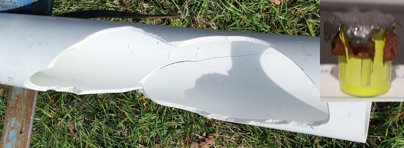

Being a reloader, and having many 357 handguns, I have a fairly large assortment of 357 bullets laying about that I have no use for. Once I had my bullet resizing die for my Texan polished out to the right diameter for my Texan and lead slugs, I experimented with jacketed bullets in the Texan, sizing them down if they were over what my Texan likes. Lost cause for the most part. Very very very slow velocities compared to my lead slugs, so slow I never bothered with groups but it would have been bad if I did, just didn't waste time trying. Some of them I powder coated and sized down, again a lost cause though it was an improvement. On the recovered 357 bullets that had been powder coated, the lands had cut to bare jacket through the powder coat. Out of curiosity, I had a couple hundred Hornady 147gr 9mm XTP boattails, even though I have never reloaded 9mm, friend gave them to me ages ago. They are way to small in diameter for my Texan barrel and required a very thick powder coat to get larger than my bullet sizing die. Using a harbor freight electrostatic powder coat gun, I had somewhere between a 10-15% reject rate when sizing them(no resistance in sizing and if shot wide ES poor accuracy). I won't be doing anymore since my barn burned down a couple months ago, all my powder coating stuff was in there, and lots of stuff I care about. Electrical fire. BTW, my Texan barrel has a larger bore and slightly less pronounced lands than one straight from the factory, my bore resembled the surface of a concrete block as new from airforce. I did some serious fire lapping on it and eventually got a perfectly smooth barrel surface that does not foul in a long long time. It turns out that XTP is the most accurate bullet I have ever shot out of my 357 Texan, runs about 925fps in my air rifle. It is reasonably close to MOA, my "long" range off my front deck is 110 yards to target hanger. I shot a 10 shot group, fill and fire 2 shots, refill, repeat 5 times. ES of 3 fps, 1.25 inch group. It makes an awesome varmint round, would be a worthless round anything much bigger than coyotes. That particular bullet expands quickly and violently in water jugs out to 125-130 ish yards, longest I can do safely anywhere on my property. This is what it does to a 4 foot long 6" schedule 40 pvc pipe full of water at 75 yards. Pipe was on lifting forks on back of my tractor, adjusted to match trajectory at that distance. Plumbers test cap on one end held on by tight clamp, entry side was plastic grocery bag held on by rubber bands, pipe held down by heavy rubber straps on each lifting fork. Took out the same size pipe I've been using to catch pellets with and shot it point blank with a 357 handgun, gas checked 158gr semi wadcutters at just over 1100 fps and that pipe survived the shot, tried again and survived again. The XTP entered almost perfectly centered, expanded so fast it over pressurized the pvc pipe and blew it apart, water pressure blew the test cap a couple feet back, and the whole pipe pushed back a couple feet and was leaning on the ground and the back side lifting fork.
The bullet was laying on the ground.
