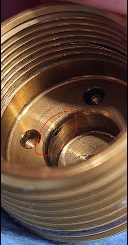

Toke the REPR cap of, removed the washers, wanted to remove now the piston and didn't move, it toke me some effort with my precision pliers to remove.
A metal chip inside, magnetic, not really visible with naked eye, but I have several jewellery magnifier lupes in high power and this how I could see that MF chip chunk.
I am blaming this on me. I got the REPR tool last week and I didn't blow it with a compressor right away how I got it, this is the only way the metal chip could get inside between the piston and bushing...the 3-400 shots and tuning the Reg up and down, and seized both sidewalls after some "heavy rubbing - on the piston and the bushing as well.
This explains also how it was hard to turn the tool, the metal chip was grinding inside and stuck the piston.
I polished both parts (with the lupe again) and hoping the first aid will work, but I will have to send an email to Edgun if I could get replacement parts.
Going now to open the forward plug to check if any metal chip get there inside as well, I don't want to F*up those parts for sure.
Edit: added pictures.
Finally I got these pictures uploading.

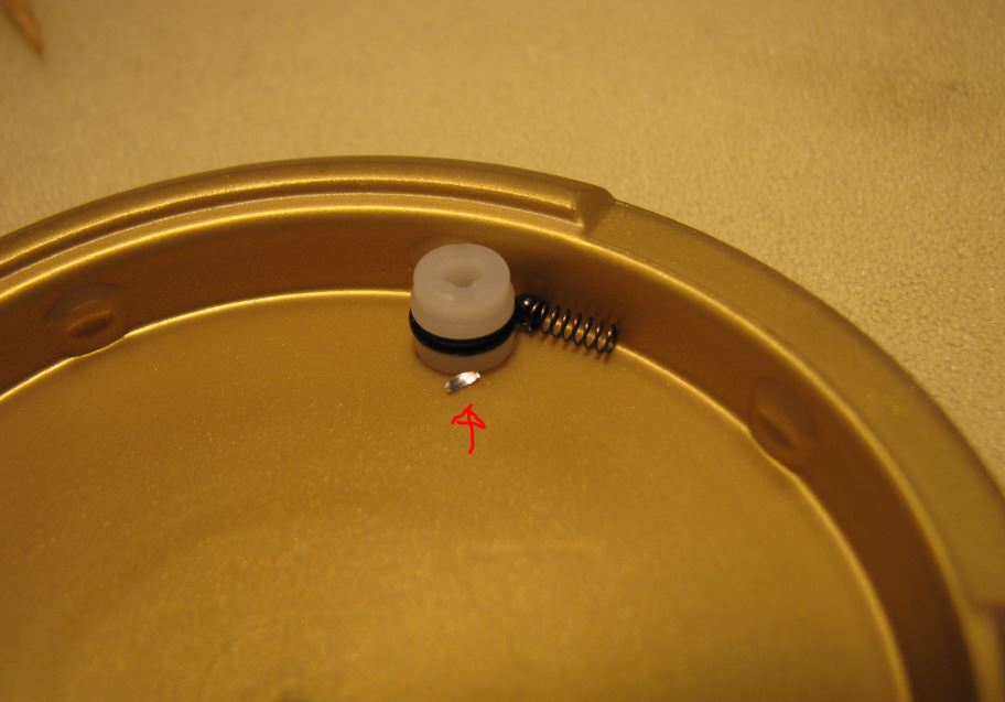

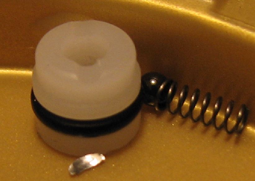

Found out today that the little ceramic balls is a major key in creep. Such a small surface and light spring. The spring can't just sit on the ball in the delrin housing, it must be centered and push directly down. No lube on the spring or ball as it must freely move back and forth off the delrin. After 200 shot or so the ceramic ball will start to make a formed indent that will greatly stop creep. some L2 work great at the beginning, some delrin have small burrs and need some indent to help. Can't just drop the ball in the housing and drop the spring in, you have to get the spring directly center over the ball. This may help.
I toke the L2 a part to smallest bits and pieces and found more metal chip inside the air path, no other way to get in only from machining in a hurry... I washed all with IPA, air dried replaced all the orings and re-lubed before assembling. Holding now the pressure within 2 bars a whole afternoon, but I had no time today for a shooting club. Also I got an email from Brian asking $55 for those two yellow anodized pieces, kind of pricey but I want to replace these for a peace in mind.
That ceramic ball and a spring below was full of white grease in my Reg as well, I cleaned that mess and just lube it with a thin silicon oil. It was really easy to put all back into the pocket even without a tool.
