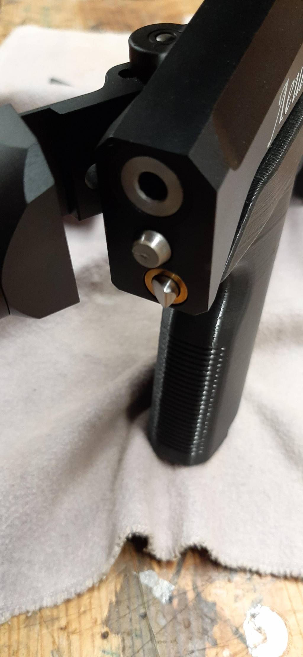

For the velocity I want I have to lower the regulator even more.
I'm cranking so much the HST that the striker is already way out (photo bellow) and I cant rise more the velocity. But it doesn't drop either.
What about now.
