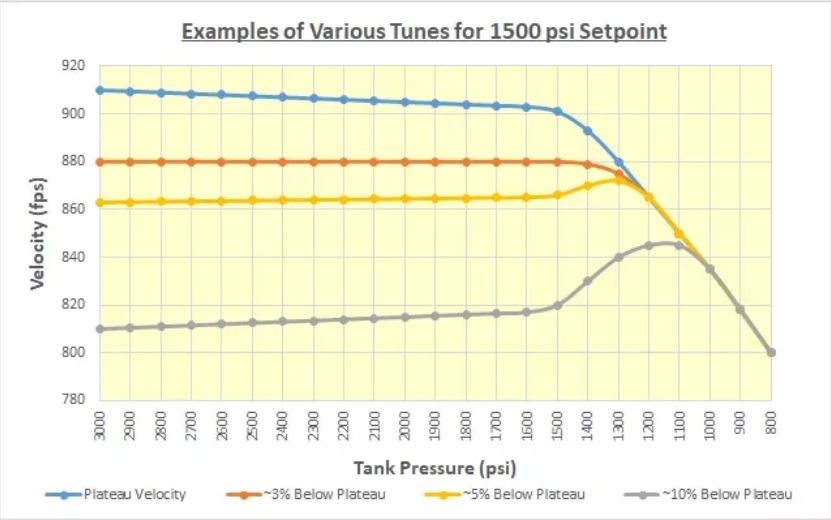

An increase in velocity around the regulator’s setpoint is an indication the hammer spring tension is set too low. As the pressure falls, the valve becomes easier to knock open and you get more lift and dwell, causing the velocity to increase.
If you want to prevent it, increase your hammer spring tension until you find the peak velocity. Then back off until it delivers somewhere around 95 – 97% of that maximum. When you do that, the hammer strike is optimally balanced for the regulated pressure acting on the valve, and it will produce a gentle rolloff of velocity as it falls below the setpoint. You will also tend to get a better extreme spread because it is no longer operating in a state of partial valve lock.

your setup is like the lowest gray curve, too high reg. setting for your targeted velocity
from the best explained tuning guide I have seen on the net
https://airgunguild.com/ask-bob/tuning-a-regulated-pcp/msg20336/#msg20336
