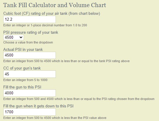

Forgot to mention that five fills seems low for that size tank and a Leshiy. What did you use for your fill and re-fill pressures?
Here is a calculator that I like.
http://calc.sikes.us/2/
As long as I'm entering the proper pressures I'm getting just over 5 fills which is still over 100shots which is plenty for a few hour hike or any remote shooting. The Leshiy is spec'd for 300bar but I assumed you never take it all the way to that pressure to save o-rings ?

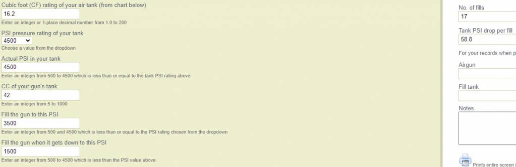

I fill to about 240 bar which I understand to be a good tradeoff for o-ring life and efficiency.
If I enter 3500 and 1500 as the fill/re-fill pressures and got 12 fills.
And remember you'll still have fills below that point as well. They just won't be all the way to 240 bar.
Do note that I lowered the re-fill pressure since you said your 350mm Leshiy is shooting 700 FPS. I'm assuming the reg pressure is actually lower than 100 bar.
The regulator is at factory setting 110bar.
I found 1 better. 16.2CF ninja. Calculations show 17fills. average 20shots x 17fills = 340shots for 10$. Couldn't see putting more then 1000 pellets through it a year. 30$/yr.
