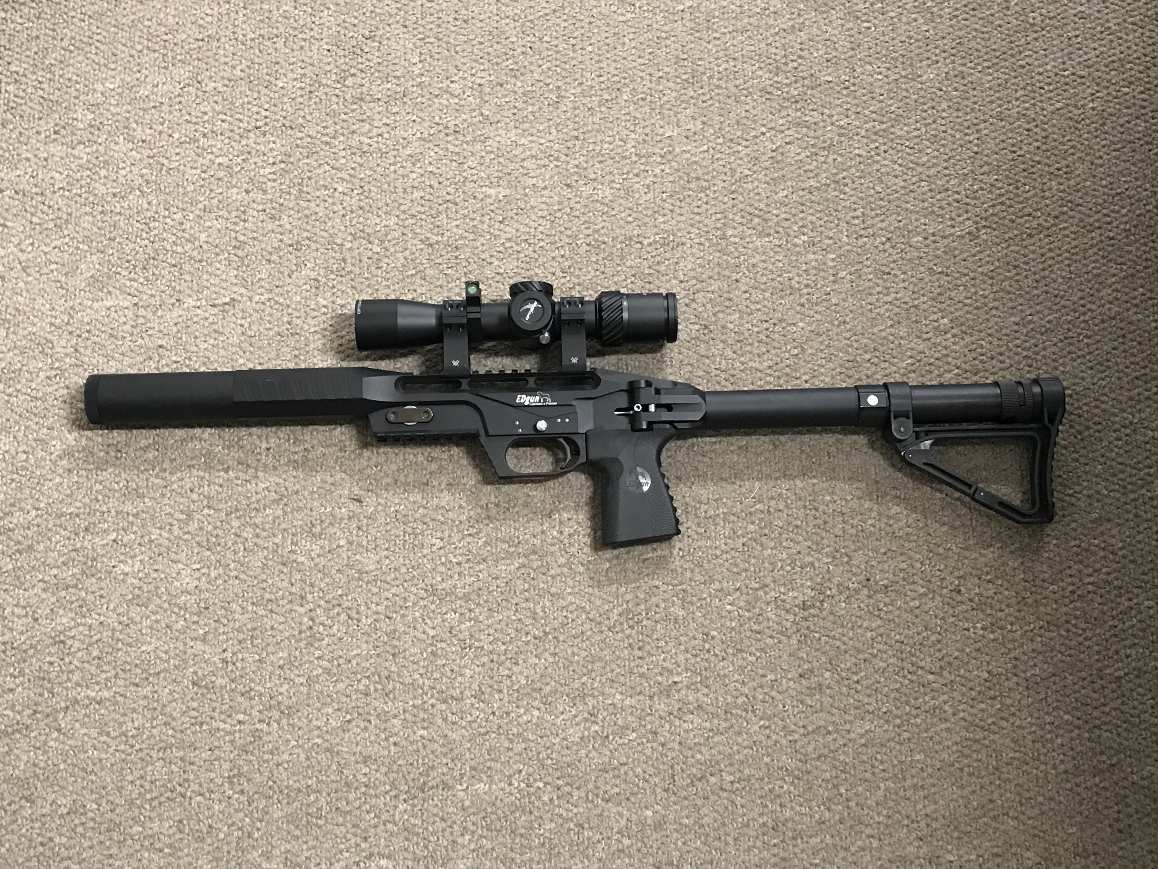

I found a Warne skeleton one piece rings with 20 MOA and are 1.5" high, mounting an Athlon Helos Gen 2 BTR 2-12x42 scope is a wonderful combo for the Edgun line of rifles of any type or a shorter bullpup design. I would highly recommend the AHMR2 reticle as it's probably the best 100 yard reticle I have ever seen. This combination is very had to beat for an airgun build.
