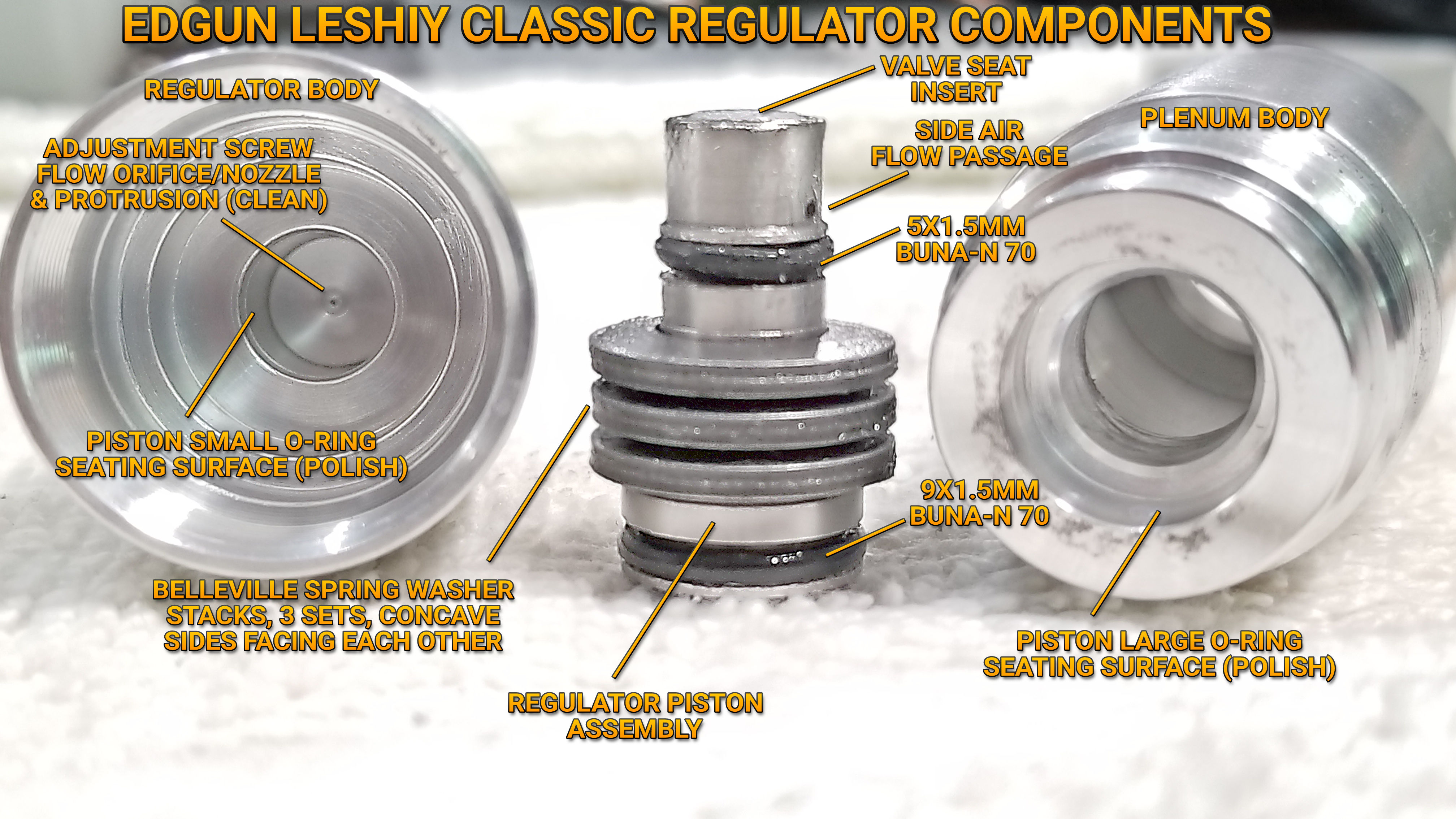

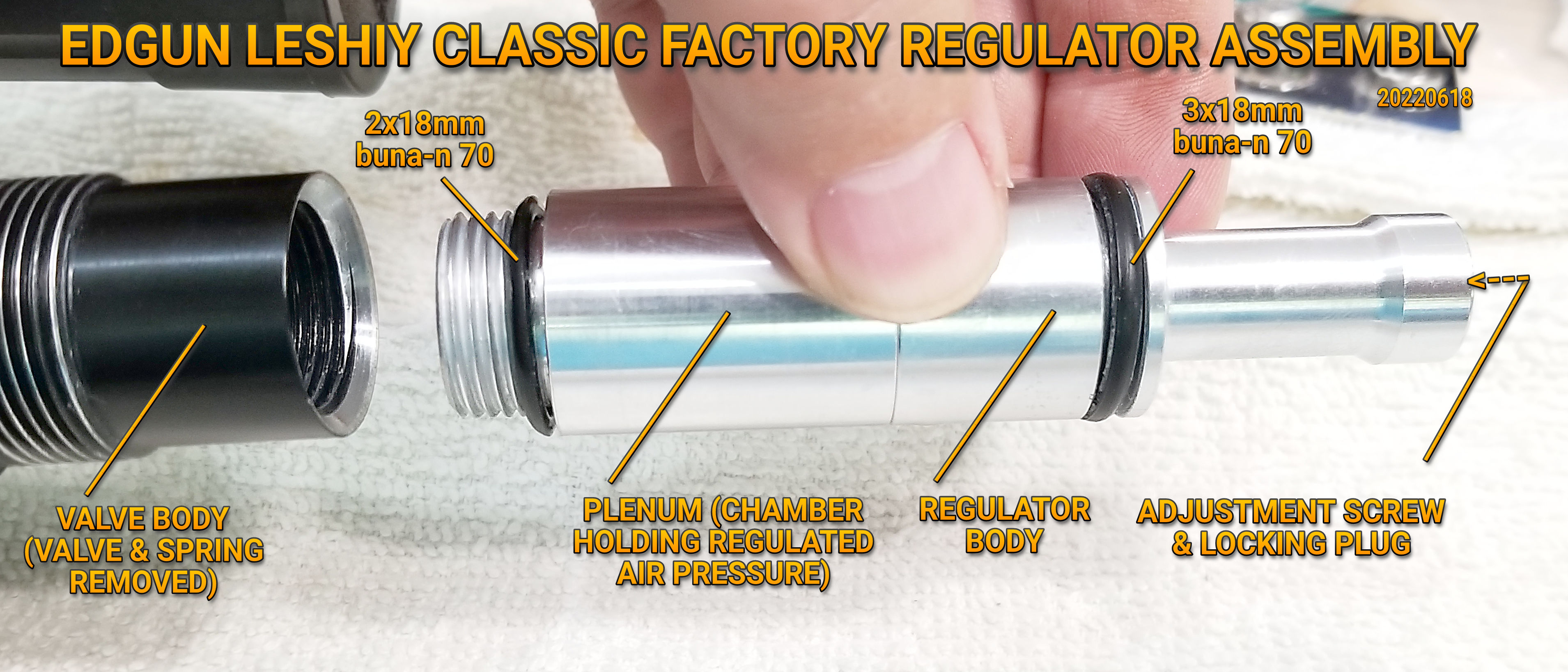

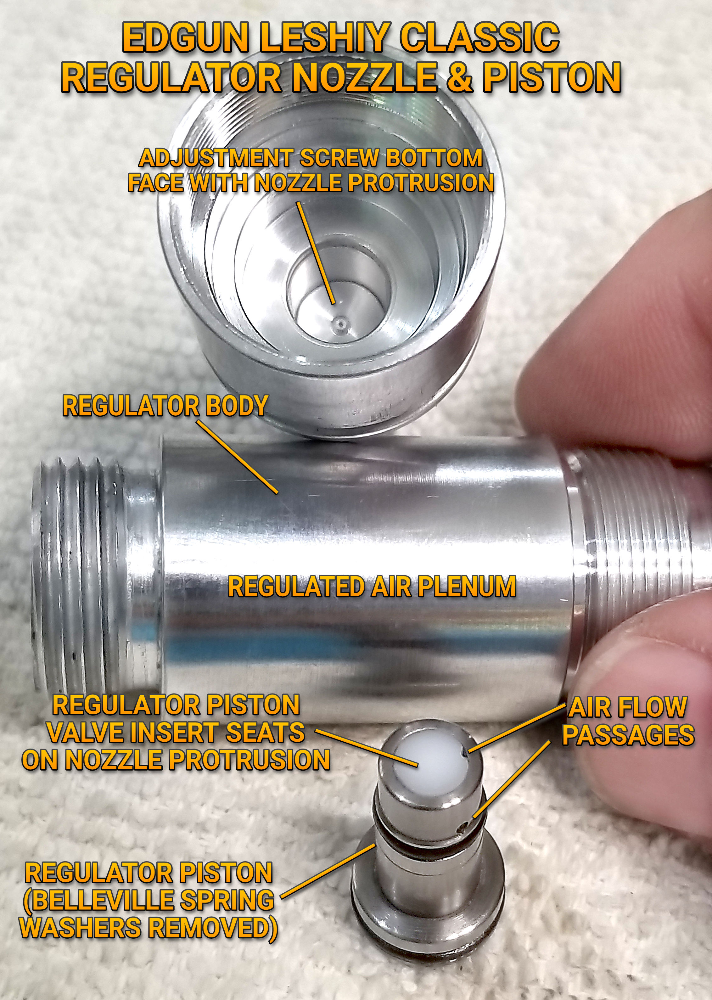

Yep you most likely have regulator creep from leaking o-rings, allowing reservoir pressure to bypass the regulator and prevent your puppet valve from fully opening for each shot. Do not try increasing hammer spring tension or you will risk breaking your valve stem.
You probably need to clean your air reservoir, any mineral deposits and corrosion for moisture, replace the outer o-rings and re-grease in your regulator assembly. Replace any o-rings that appeared to have taken a permanent compression set. Usually the outer ones take the brunt of the reservoir pressure.
It's pretty easy to do so try not to get to worked up about it. There are some good videos on YouTube for this. You should take the time to do at least a quick polish of some surfaces of the regulator mechanism, easily done without changing the regulator set point screw. And you definitely want to inspect the plastic nose of the regulator piston valve seat for debris or excessive indentation. See photos in the following threads for examples.
Here are some photos of the regulator from my Leshiy classic. There is more than one regulator style made over the years. Knowing which o-rings to buy is the first hurdle .
Edgun Leshiy Classic Regulator Piston Assy Nozzle n Plenum Annotated 20220618.jpg
Edgun Leshiy Classic Regulator Piston Nozzle n Plenum Annotated 20220618.jpg
Here is another thread about regulator creep for a different gun. I contributed some experience from my Leshiy classic:
https://www.airgunnation.com/threads/maybe-i-can-fix-this-reg.1276665/#post-1350320
And here is a story of regulator overhaul for my larger Edgun R5M with annotated photos. Hope they help you and others.
Good luck with your repairs.
Feinwerk
