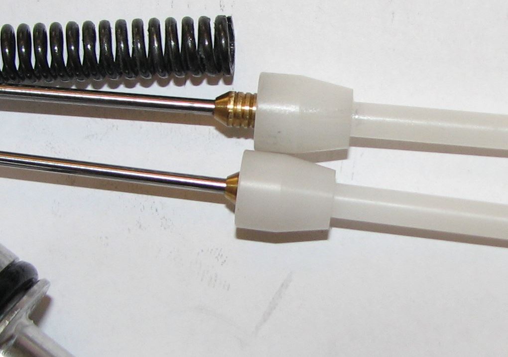

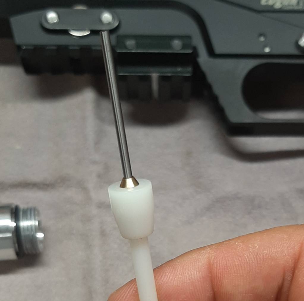

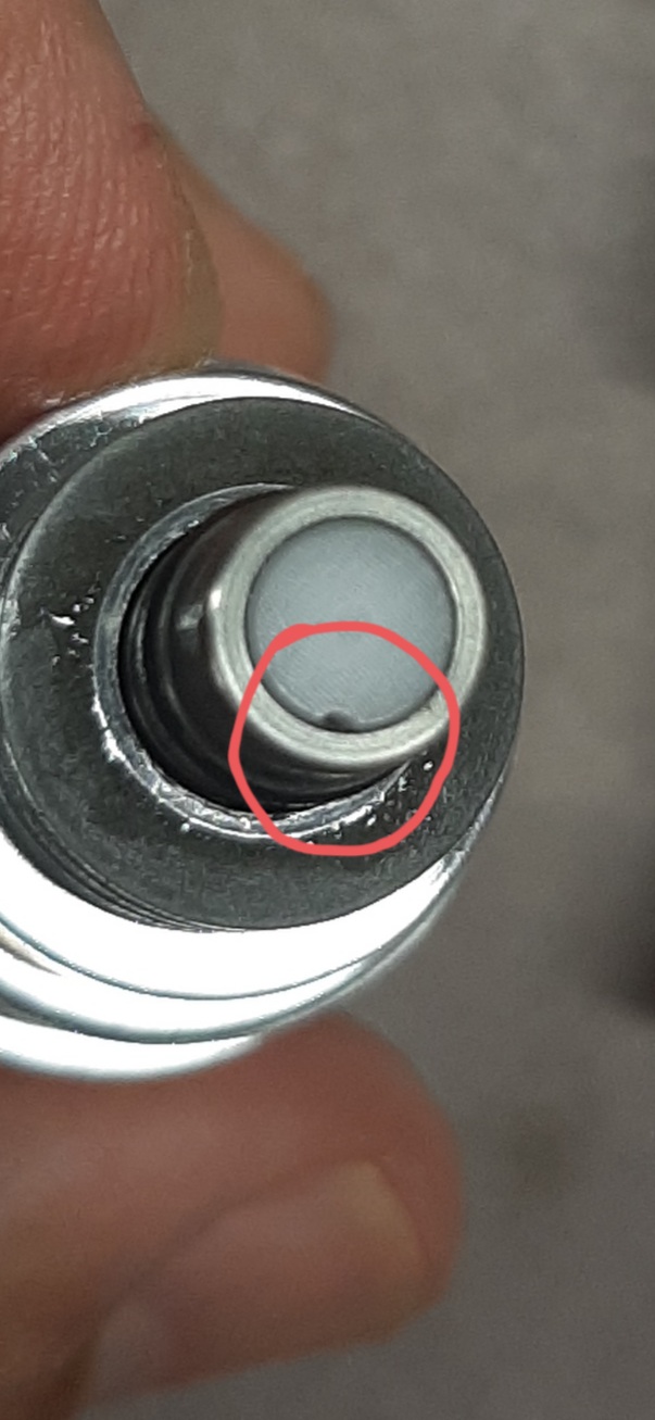

BUT something's missing in plasti part of the regulator:
Can it be this tiny little thing the problem?
Most regulators have a piece that looks like that. Not sure why unless it's to be able to get it out to change it.

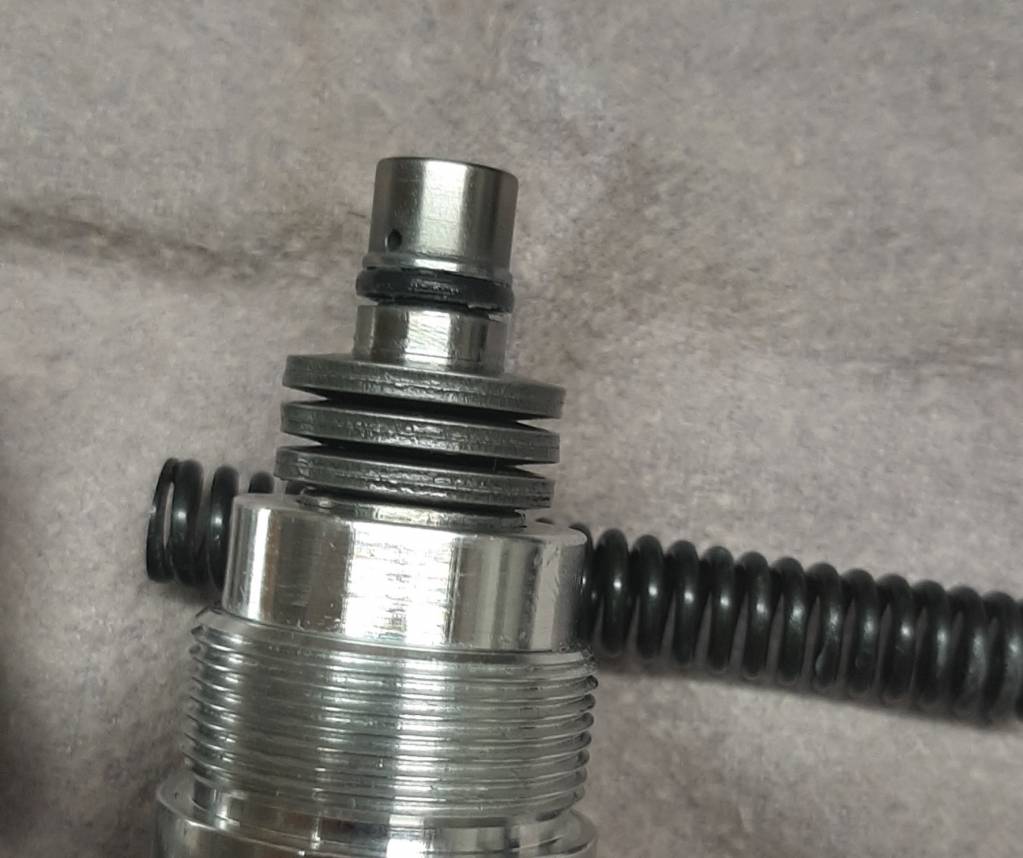

I will say those bellville washers look really banged up and the edges quite rough. Wouldn't hurt to remove - after noting order ()()() - and give them a little polishing.
