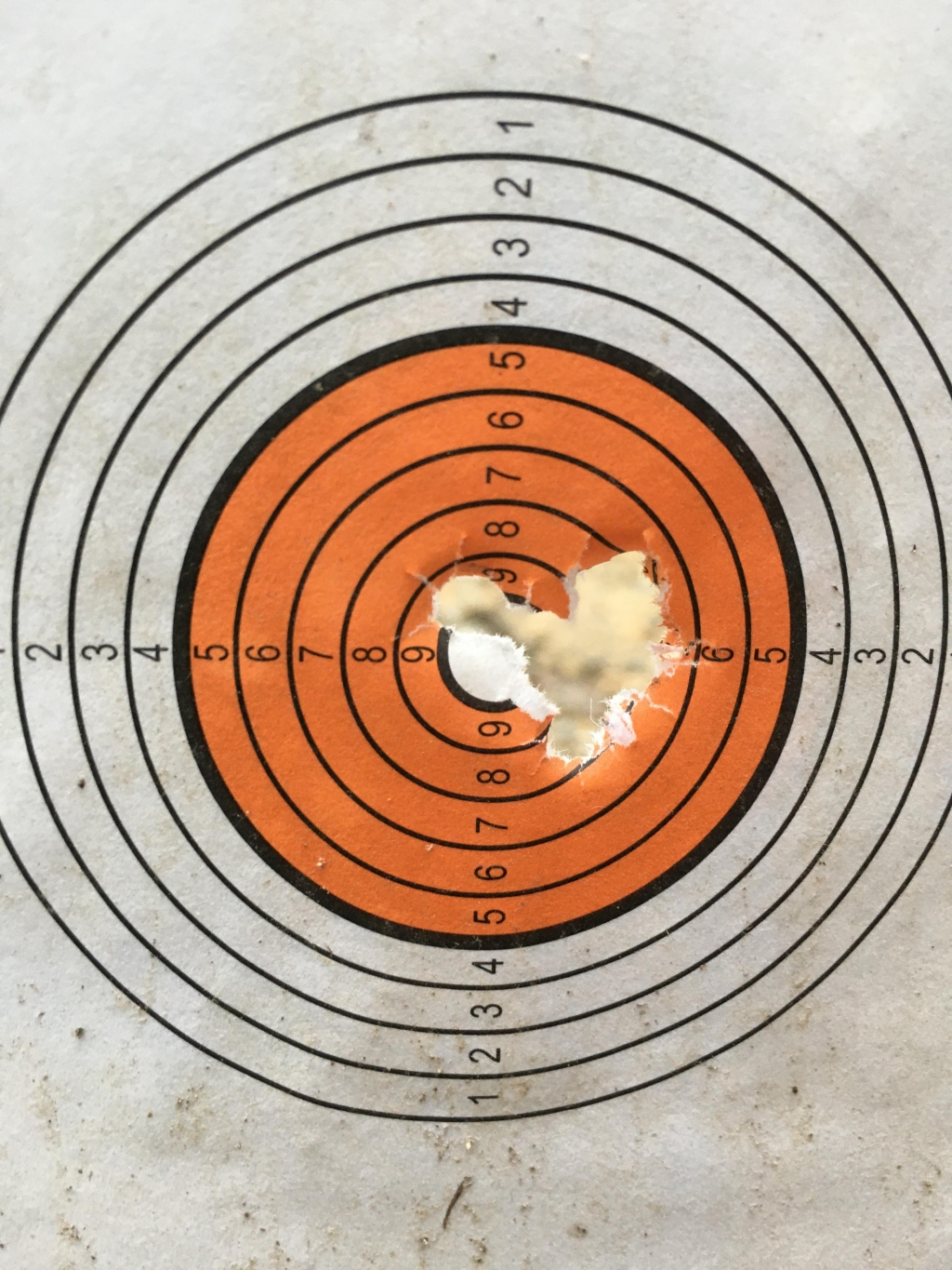

I have the Leshiy in 22 caliber with the 350mm barrel and stock regulator set at 120 bar. With the hammer set at 25 clicks using the Edgun 25 grain pellets it is a tack driver at 35 yards and easy to shoot.
