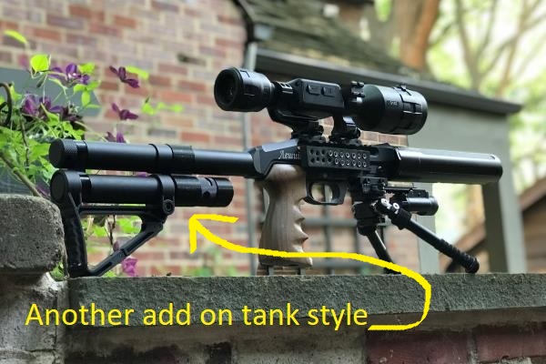

I have seen the one you are thinking about of course as you know lol but have not tried it out yet. haha It is easy to install but before you pull the trigger on that one ask Dillon about the one that earnest installed on his. Dillon recently sold his I believe and is always nice and helpful with his experiences ( Dairyboy) It is a less complex add on tank that connects via the fill port and can act as a check weld assistance if needed or desired. I would be patient and check both units in full before pulling the trigger. The one I have has more orings which in my opinion is more possibilities for potential leaks haha. Not helping myself out I know but I am being truthful in my thoughts 😁
Scott
Here are a couple of pics of the 2 tanks I tried to mention above. They do not belong to me at all but shows the add on tanks.
I hope this helps you as it is my intention to try and assist in your question as best I can lol.
Again these are not mine but it does show examples of the add on tanks.
