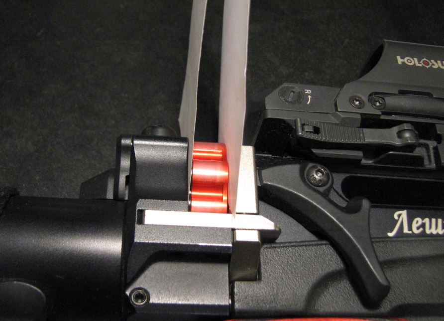

..and the mag should "float"between the breech and valve housing, you should be able to slip a piece of paper in between the mag and breech, down to the barrel - and between the mag and valve housing, down to the puck

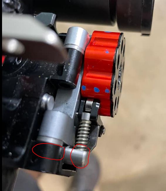

What else I can suggest? A tons you can entertain with, but a first that can improve the mag indexing:
I removed this "bracket" and polished the hole = meaning removed the cutter marks from machining = less friction between parts. Also the pin side of it got a touch of polishing.
Grease in between connecting/sliding parts.
