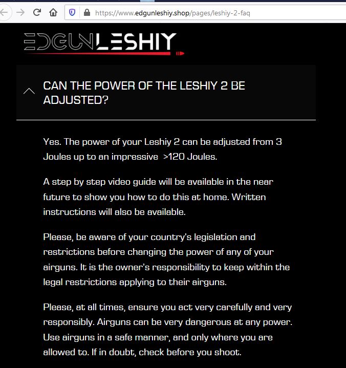

Here is something from Edgun Leshiy 2 and Andy’s of AAR. According to what is being said and posted on Edgun dealer sites and the latest from AAR. The Leshiy 2 will be HIGHLY tunable. Maybe the prototype wasn’t but the production model is tunable.
Edgun Leshiy Link: https://www.edgunleshiy.shop/pages/leshiy-2-faq

What I have learned about this system is that it operates differently and responds differently to typical adjustments many of us are familiar with. Yes the power output changes with changes in regulator pressure. It is not as simple as decrease pressure to decrease power as a fact. Yes the power can be changed by customizing the “puck” orifice which is essentially adjusting the transfer port opening. It is not clear if the gun locking mechanism was designed for this🤔
Valve dwell rules on this gun. The dwell is regulated by pneumatic flow control components that are specific to a setup... barrel length/caliber... still working out details here. Your gun will arrive with dwell components specific to your original, primary order. In some cases, changing a barrel or caliber will be optimized by replacing the dwell regulation components.
Kits will be made available soon. Initial demand on the guns has been in the way of replacement parts, but I know that is being handled as quickly as possible.
I would encourage folks to be patient and enjoy them out of box. This is not something we need to be doing “hacks” on. I feel it is best to wait for the parts, video explanations... before going crazy attempting to “tune” this platform.

Information is still scarce. From what I understand:
1. The "pucks" were really only designed to satisfy the immediate needs of the 12 FPE market. The pucks are after the regulator, and after the valve, so the only thing they do is redirect the amount of air allowed into the barrel. The amount of air produced after the regulator and valve is "discharged" as wasted air. So using a puck with a restricted hole will result in a lower velocity, but increased blowback.
2. The valve dwell time is not user adjustable.
3. Sounds like there will be a component that connects to the valve which will allow change in power and caliber.
4. Regulator's can be adjusted, but more so to increase rather than decrease power. Item #3 will likely play an important role is larger adjustments.

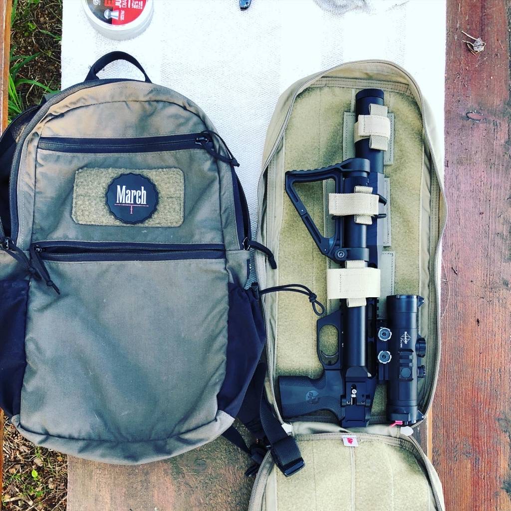

Thanks Brian, I am looking for a hard case for traveling from NL to USA when I can, and a soft pouch to put the Leshiy 2 into into my backpack. I have 4 backpacks, 2 TheNorthface and 1 Patagonia backpack duffel bags. Along with some other bags and if I get another backpack my “friend” will kill me. 🤣
Like this combo:
Which backpack is the one on the right with the Leshiy Classic? It looks slick!!! I think someone needs to start a comprehensive thread on backpacks, soft and hard cases for both the L1 and L2 with all the measurements and configurations. Also, add in an 18 cu.ft. Guppy tank, 12 cu.ft. Omega or buddy bottle that the packs could fit with the measurements.
