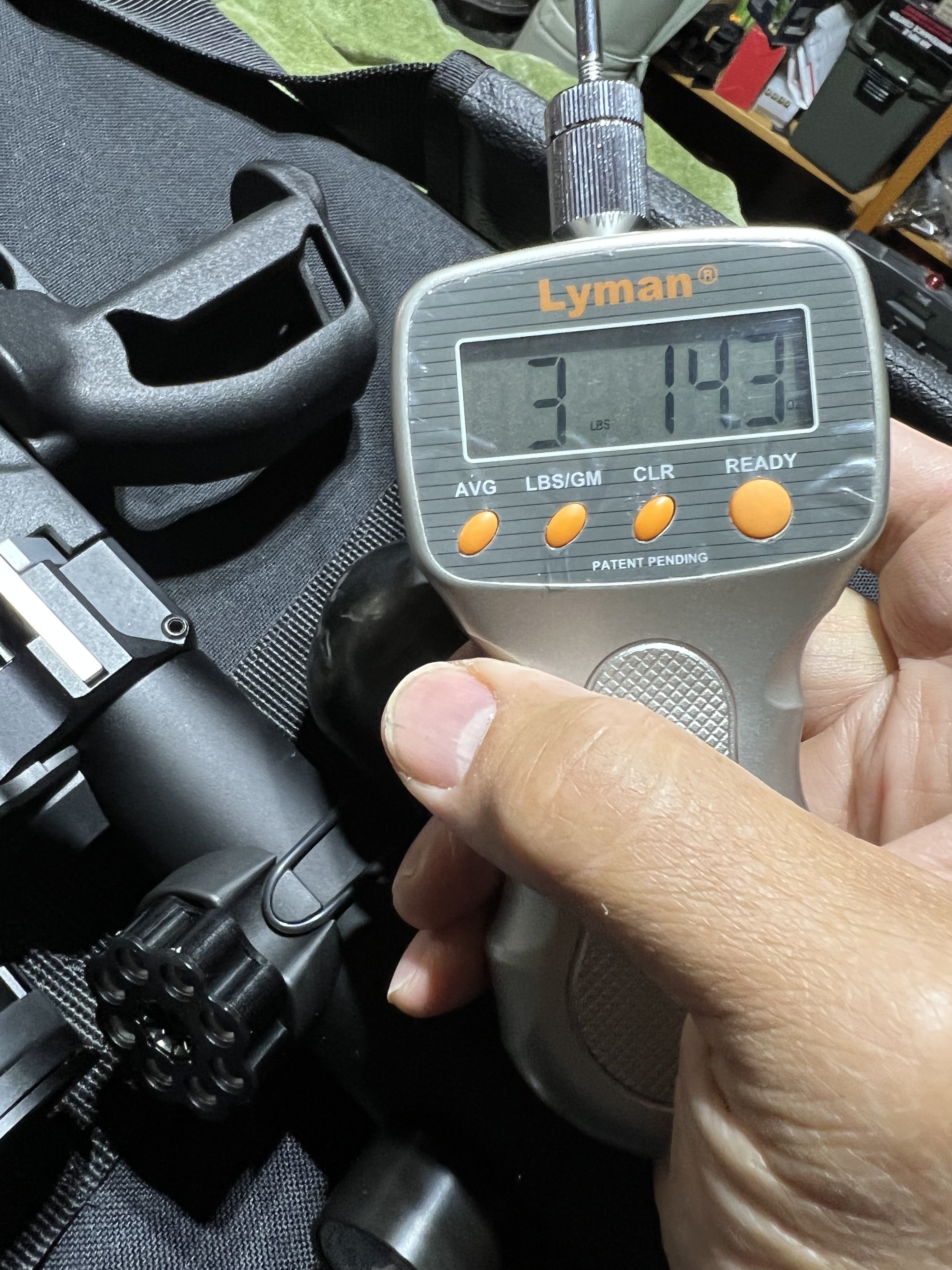

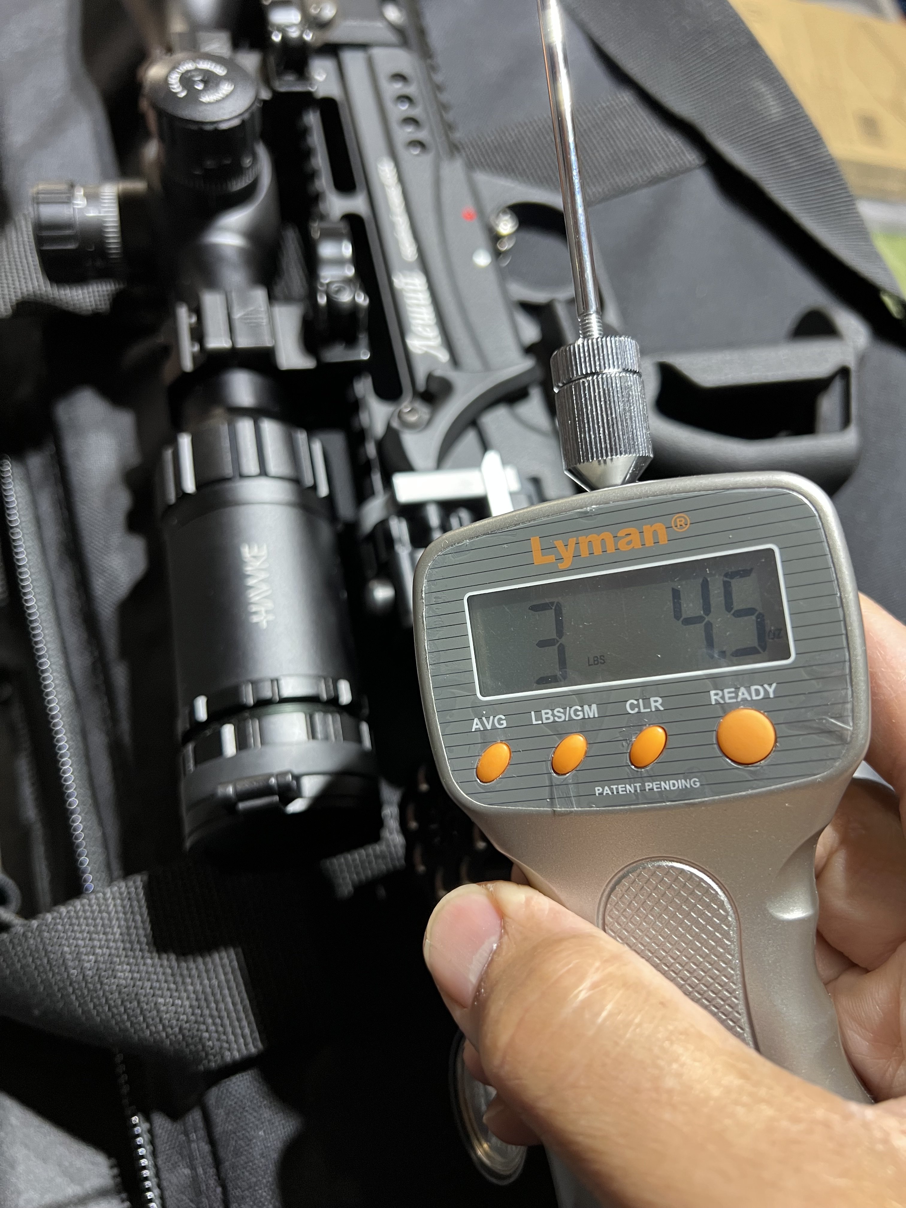

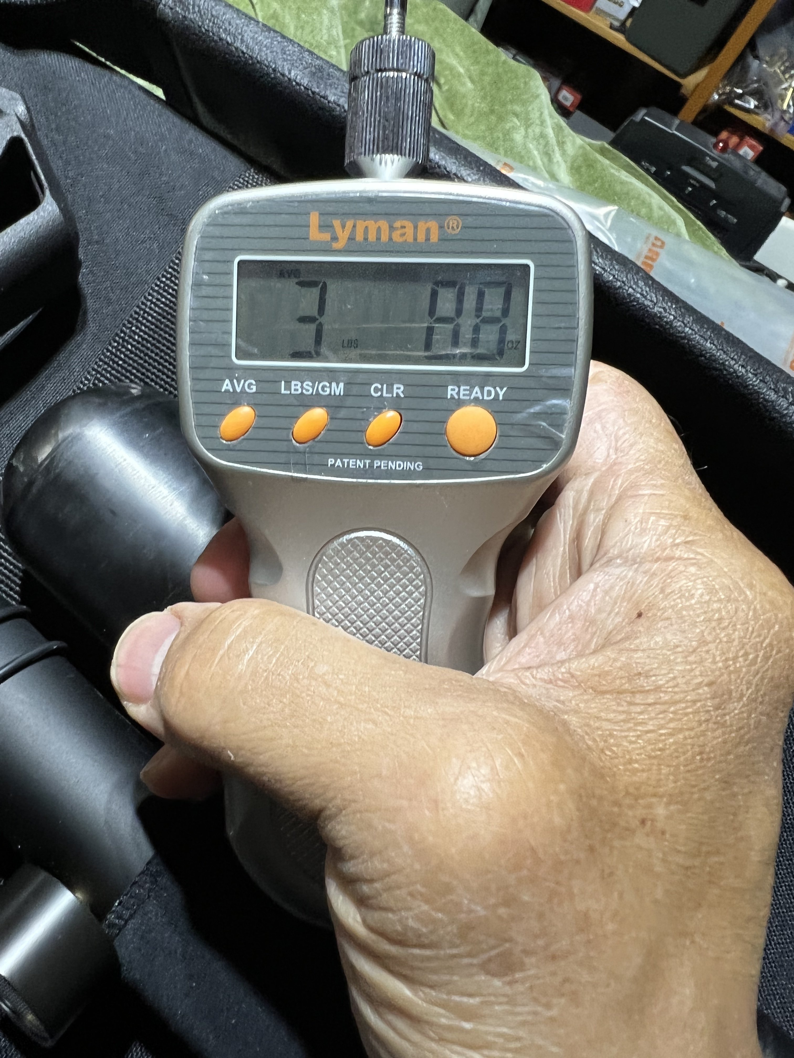

That may be what they list, but I just went downstairs and checked mine using my Lyman Digital Trigger gauge. The trigger pulls ranged from 3 lb 4.5 oz up to 3 lb 14.3 oz with an average of 3 lb 8.8 oz.
