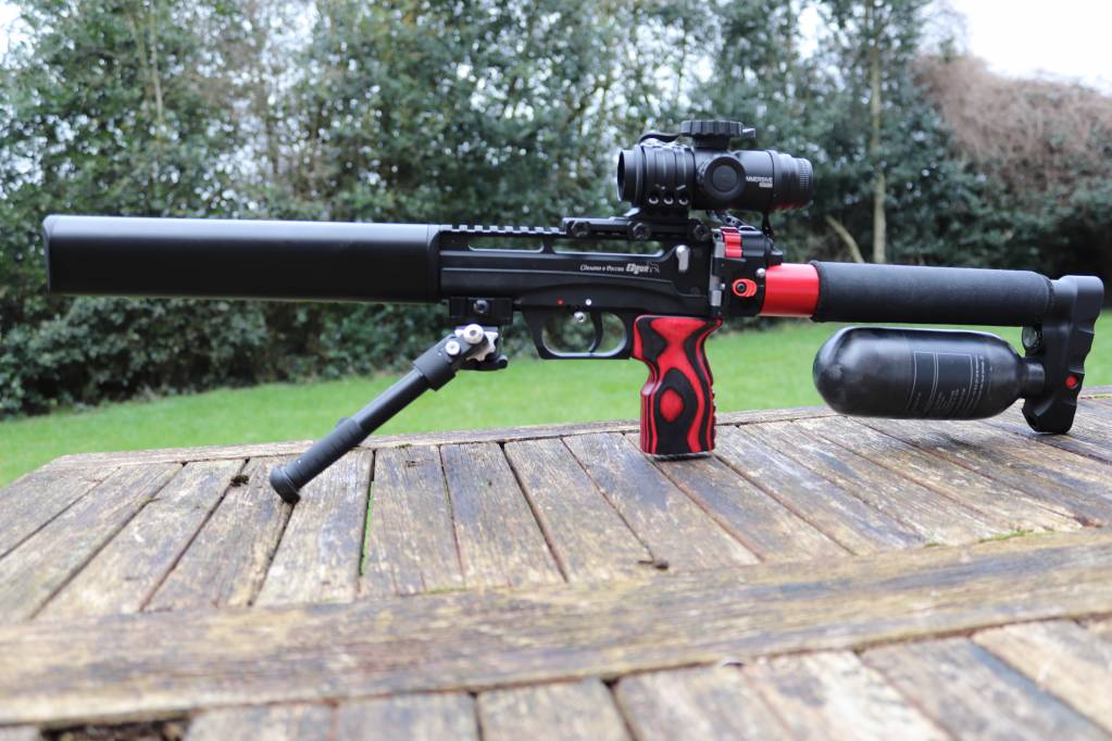

Have Leshiy 2 in hand but my location doesn’t give me many options for scopes to look at / test out. Looking for scope and one-piece scope mount options.
To start, what is a good ring height most find is comfortable which the L2 design?
Of corse depending on ring height can affect scope size....
Second would be the scope choice. My shooting would be at 100ft max (for quick shooting without having to go to far) with sometimes going longer than that.
Would like something that fits the L2 well, i.e. not to long and objective not to big.
FFP or SFP would e fine.
Would like illuminated reticle.
Thank you in advace for suggestions.
