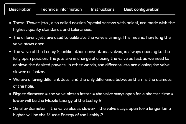

The Leshiy2 "valve" by default is on - most power.
