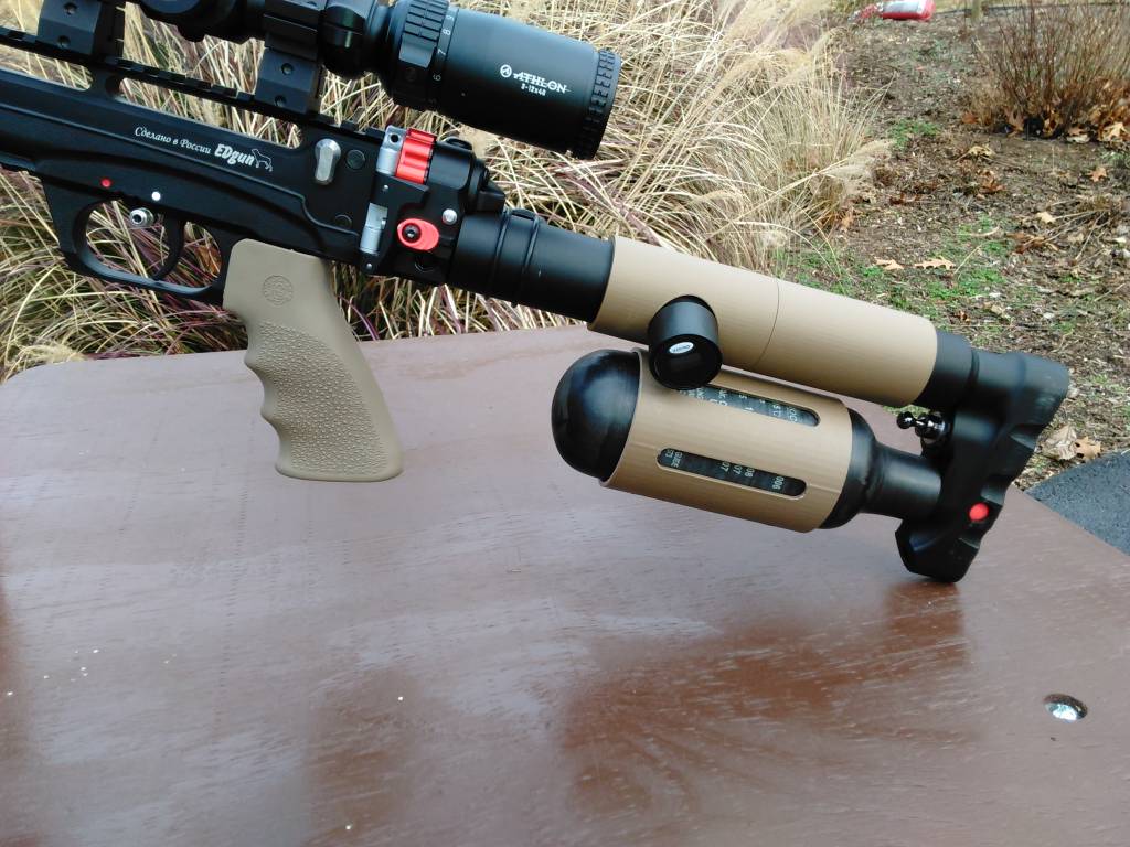

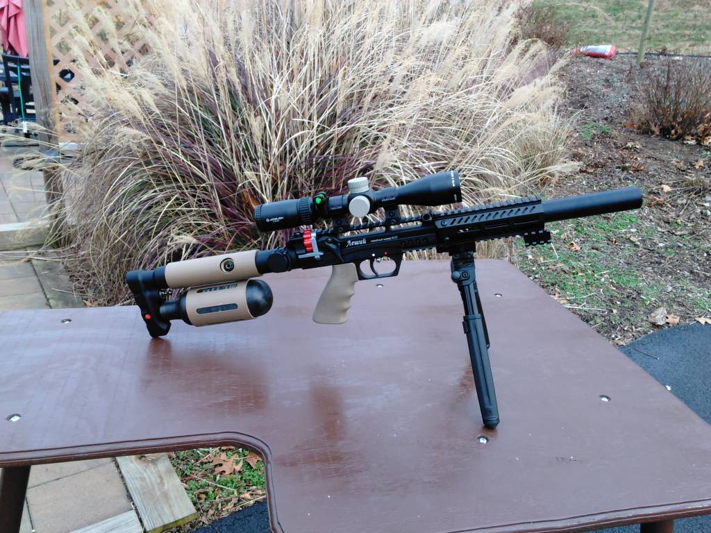

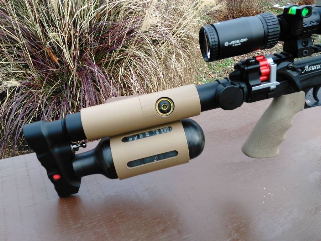

I got my Leshiy 2 Sparrow model in .25 caliber with 250 mm barrel and 300 cc bottle about a month ago. My use will be for short range pesting out to 50 yards. I have been shooting various pellet for groups and accuracy but wanted to use the H&N FTT.25 at 20 grains to maintain a flatter trajectory and to loose power faster for down range safety. I wanted to be shooting the 20 grainer for about 750 fps or 25 fpe. I have achieved that velocity but accuracy falls off after about 40 yards. My Leshiy 2 has two .4 power jets so my thinking was maybe my valve is staying open a little too long creating air turbulence behind the pellet. My question is what power jet range would be good to work with that lower power tune level. Thanks Bill
