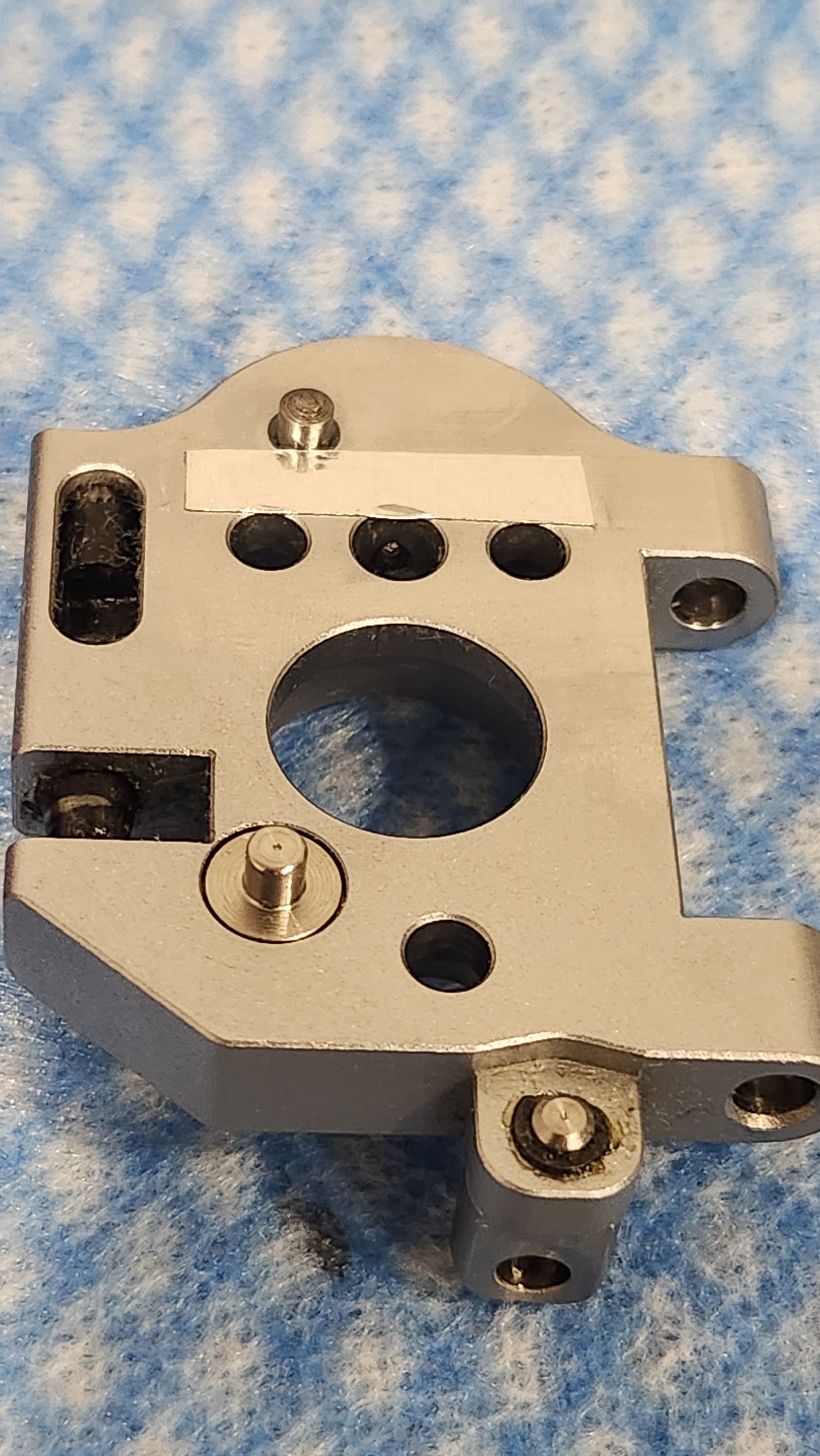

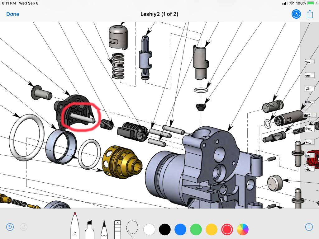

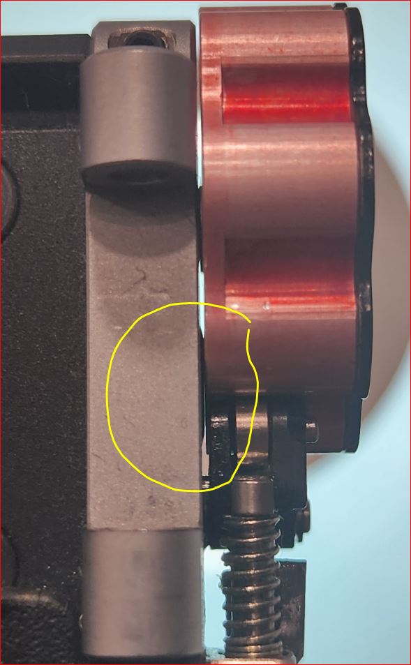

Ensure that this pin is fully seated in the housing. Do this by pushing firmly on the front of the gear face that engages the magazine. If the pin moves forward, it can induce undesired pressure and friction on the magazine. The pin should never be proud of the gear... even when you fully compress the spring.
This helped in figuring out my indexing problem. Tried everything else mentioned and videos with no fix. I took this section apart to familiarize myself in tearing it down and reassembly and didn't reset the pin far enough. This pin was sticking beyond the gear causing tension on magazine. Pressed it after reading this thread and everything cycling great. Thank you
