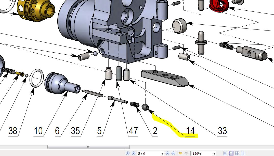

Been having some indexing issue myself lately - what plastic ball are you referring to here?
Start with the east things first. I had cycling issues when one of my magazine plates had a blemish on it. Swapped out the plate, and all good. Then there’s making sure the barrel depth is correct. Too much pressure on the magazine, and it won’t cycle. Make sure your red puck is there. When they’re not installed, or aren’t sitting properly, the mag won’t cycle.
If the plastic ball in the valve is broken, usually the valve pin is not where it’s supposed to be, or you can wiggle it side to side easily.
