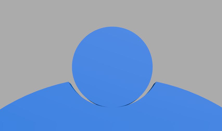

So I ordered these bearings, and they seemed a little smaller than the factory wheel. I went ahead and installed anyway. Still having indexing issues. I tried swapping barrels and mags with similar problems. I does index, but sometimes not at all, and sometimes only half way. I’m still thinking the wheel is the culprit. Maybe size does matter?

I have to disagree - the OD off the wheel do matter, too small a wheel will not index the mag correctly

...and furthermore, the OD of the original index wheel is 6.2 mm, a bearing of that size will be hard to find so better go for the original, its not that expensive
