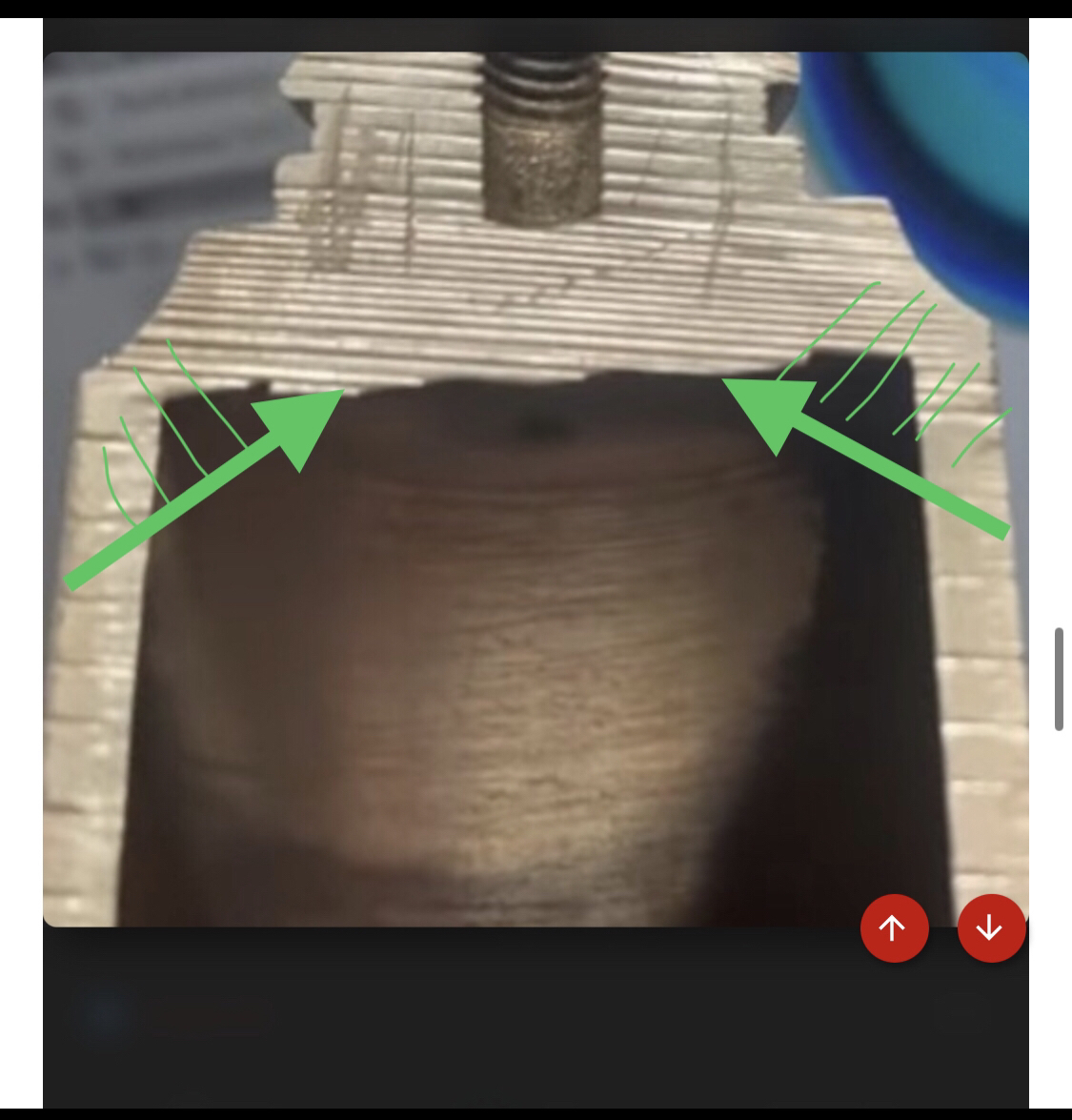

Because the OP tube that spectacularly failed was of the square angle type. Regardless of testing since may I remind you we still don’t know why it failed. I don’t need guidance on buying a L2, thanks, I want the answer to a very dumb simple question -why two designs? Now Ed seems so far completely incapable of answering which to me is hardly reassuring. May I further remind you that again, Marko said ideally there should be no sharp edges in a pressure vessel. To be honest I’m sick of asking the same question -but while fan boys and the manufacturer himself only choose to see the ‘emperors new clothes’ it seems to me a valid and simple question is now being deliberately ignored.

You’re seriously telling me with a straight face this has a radius on the corners? This reminds me … I’m due my annual eye test soon. 👍🏻

Even Marko pointed out the discrepancy of the pictures. Ed twice. Get off your friggin high horse, stop pretending to be so much smarter than everyone else and move the hell on. How many times does something have to be explained to you before you catch on?

All your great forensic science comes from that picture ?... Brah, on that picture doesn't even look like the bottom is even staight and it looks all jagged, is that all you got to keep expecting answers to you so called questions ?
Get a tube, do some serious analyzing of it then come back to us, for you to keep coming back when all your evidence is some bad pictures just makes you look like a clown.
So far you got nothing, zero, nada and Ed owes you no time whatsoever, come back with some serious stuff then maybe someone will pay attention to you.

Are you unable to understand what I write? No "sharp corners" are there! There is a radius of 0.4 mm. Technically impossible to make that corner "sharp" with no radius. Even small radius makes the concetration of the strength completelly different of the "theoretical sharp corner". Test shows that I am right, the destruction of the tube starts in the middle, no in the "corner" at the pressure that match the calculations. That is it! What else do you need? Useless thing to try to pursuade the fanatics of the "flat Earth" that it is sphere :)
