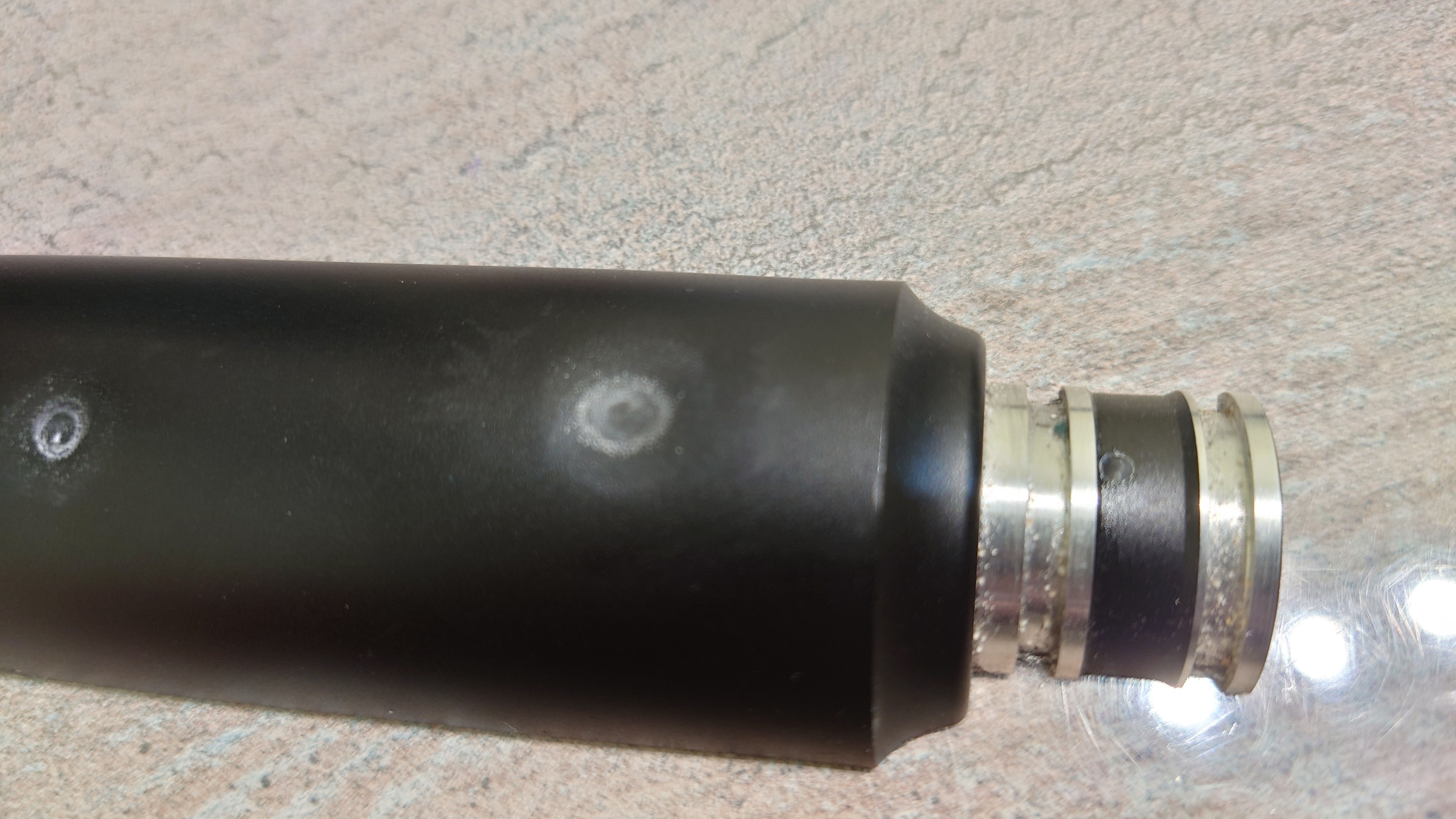

I've cleaned off enough to know what that is...
Calcium, lime, and rust. I looked up it's friendliness with aluminum and I get mixed feedback. Wondering why the end of tube isn't anodized like the rest?
The anodizing process submerges the part in an electrolytic bath. Electric current does its thing. The anodized area is now very porous and will accept a dye coloring. The part is then dyed but the dye doesn’t color (stick to) the area at the bottom of the tube that had an air pocket during the anodizing. (Bottom was probably at the top during process)
The other non anodized area (silver) is that machine operation was done after anodizing. It is a sealing surface for the oring and allows for a better seal than an anodized surface (porous).
As I mentioned earlier, aluminum oxide will appear whitish/powdery. From your picture, it is hard to tell if that is what you have or if it’s just poorly colored from the anodizing I described above. Hence why I said, IF you can clean it, do so but it may clean already.
Try to clean it with something that is not a chemical that might attack the bare aluminum. I would never use something like CLR on any part of a gun, especially if there is a bare metal.
Calcium? Really?….

A couple of my tubes, no corrosion (oxidation) or CALCIUM. Notice how the area extends up in the tubes.
Wanna see some real corrosion? This is someone's L2 REPR plenum with the brass filter removed. I do not know the history of it, but it looks like it had been fed with lots of humid air in its past life. This is the ideal place for galvanic corrosion to occur, with two dissimilar metals in contact while moisture is present. Aluminum acts as a sacrificial anode and gets eaten, producing aluminum oxide, the white powdery stuff. Looks horrible but it cleaned up nicely, and it does not present a safety issue, as there is plenty of wall thickness there and the corroded threads are not load bearing. Interestingly enough, the rest of the tube was just fine, no signs of corrosion. It was localized only where brass contacted aluminum.
Could this be another failsafe built into the design by Ed the mad genius? Feed your Leshiy with poopty humid air, and eventually your regulator gets plugged with the white stuff before the integrity of the reservoir is compromised! Then you're forced to open up your gun, gasp in horror, and re-evaluate your life and your choices of air sources :D
After seeing this I examined both of my Leshiys and there was zero signs of corrosion in this area or elsewhere. I've been using GX and Tuxing compressors with what I thought was suboptimal filtration. Zero issues.

I’m pretty sure it’s where an air pocket happens during the anodizing and again during the dyeing process. All of my Leshiy2 tubes have it. If it can be cleaned, clean it. It’s not of any concern/worry.
Oxidation will appear whitish/powdery.

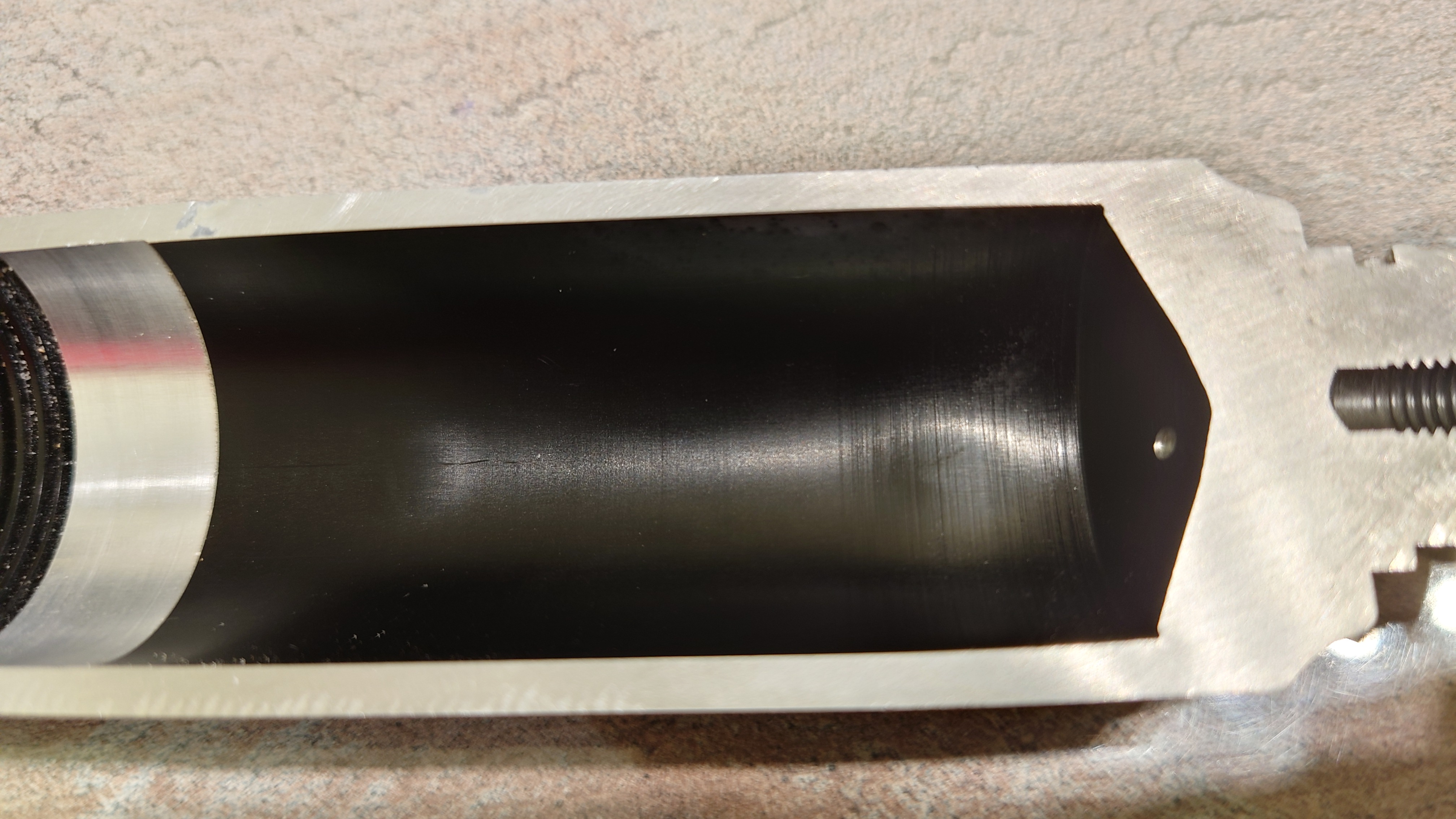

Right, the inside surface is anodizing as the side process, not the main process.

Moreover, even the half of the tube resist the shot, inspite of the fact that half tube is much, much weaker... That is the result of shot from 50 meters from .25 (85 Joles) and 10 cm with .35 (125 Joles).
Just admit the fact, material is OK, ED is OK :)
