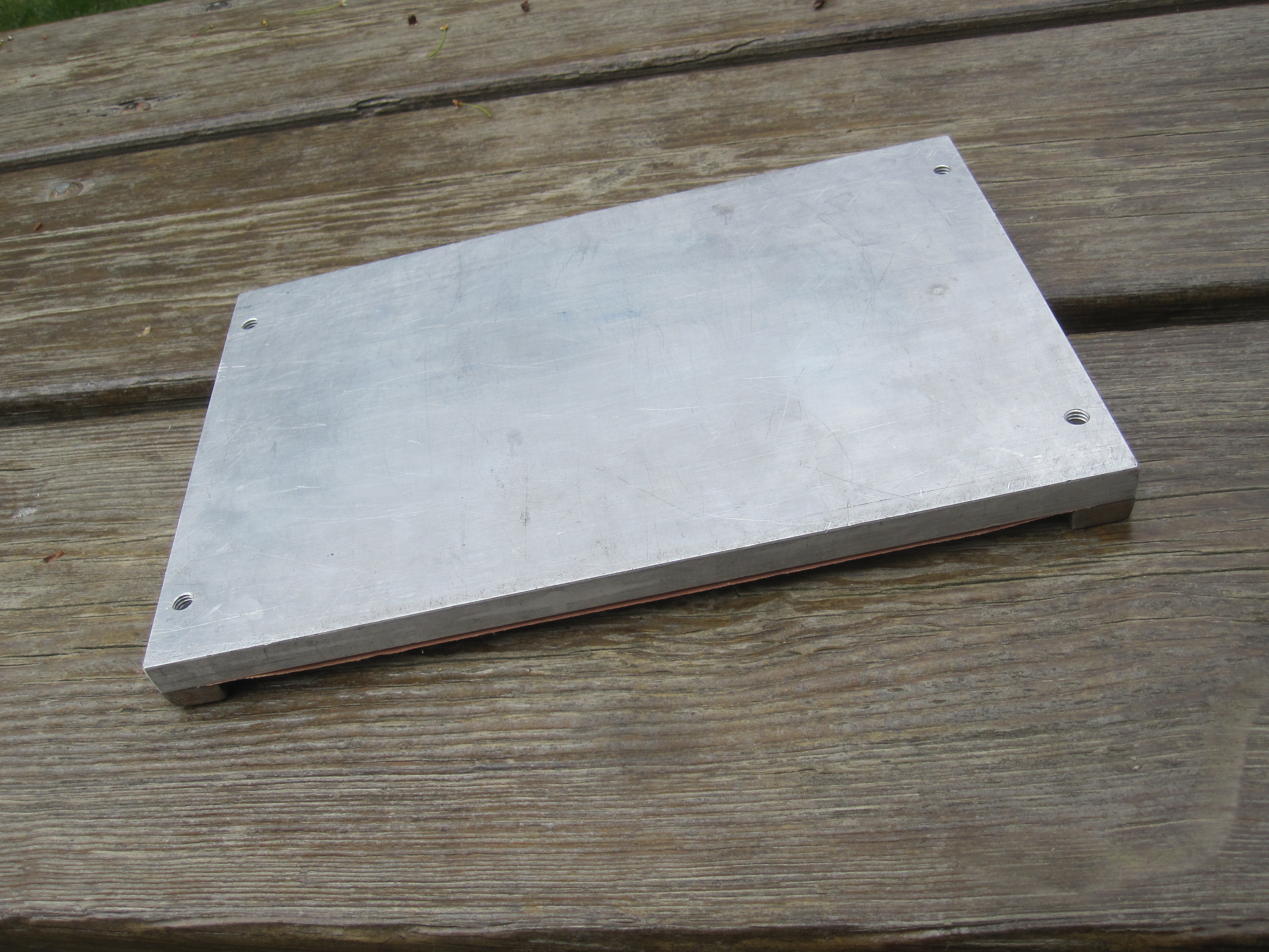

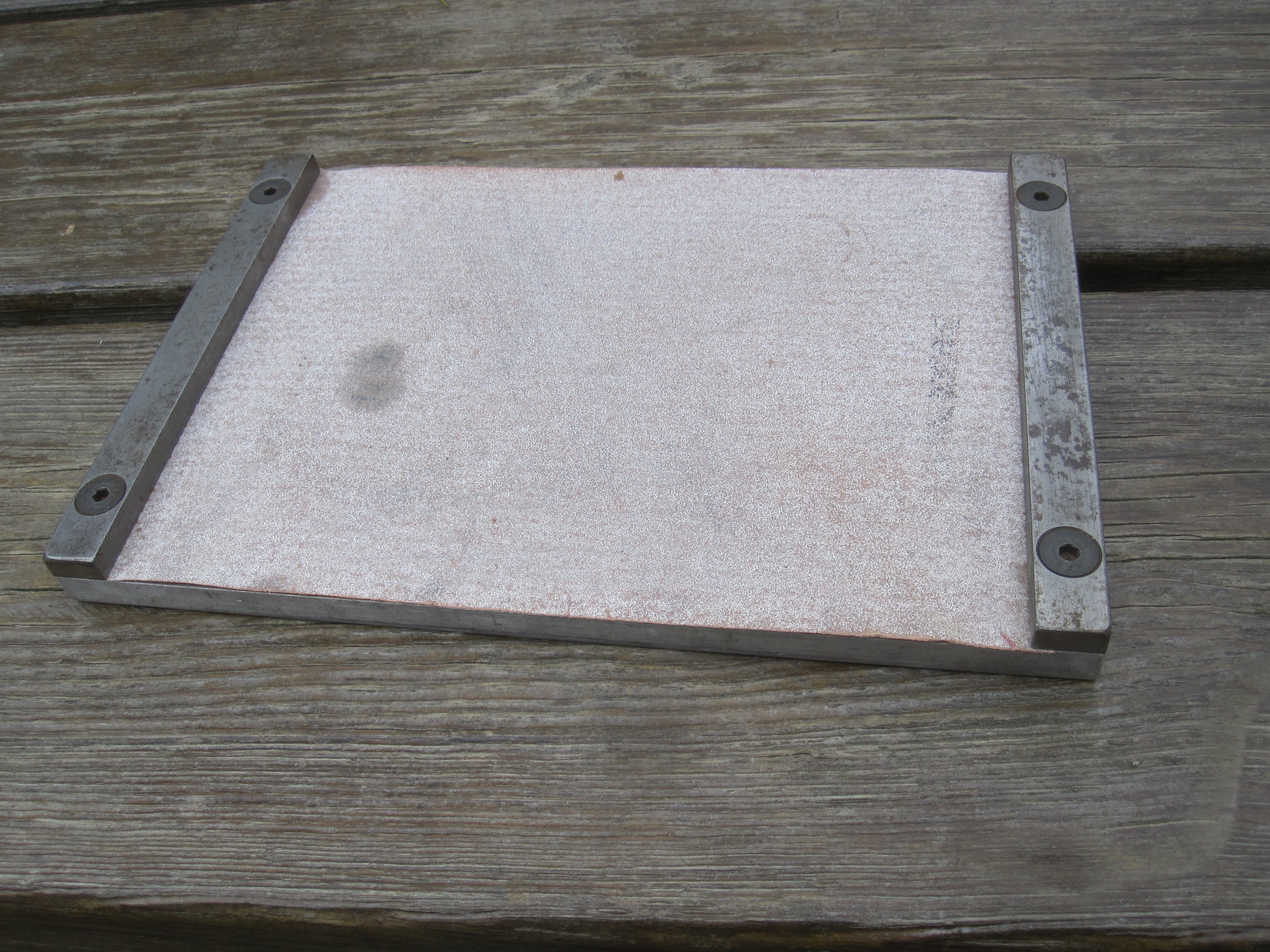

Hello, Ed!
I have a suggestion for you. A fixture for holding a sheet of sandpaper.
Simple design, easy to make and very useful throughout your whole shop :)
Top surface of the aluminum plate (under the sandpaper) is ground perfectly flat.

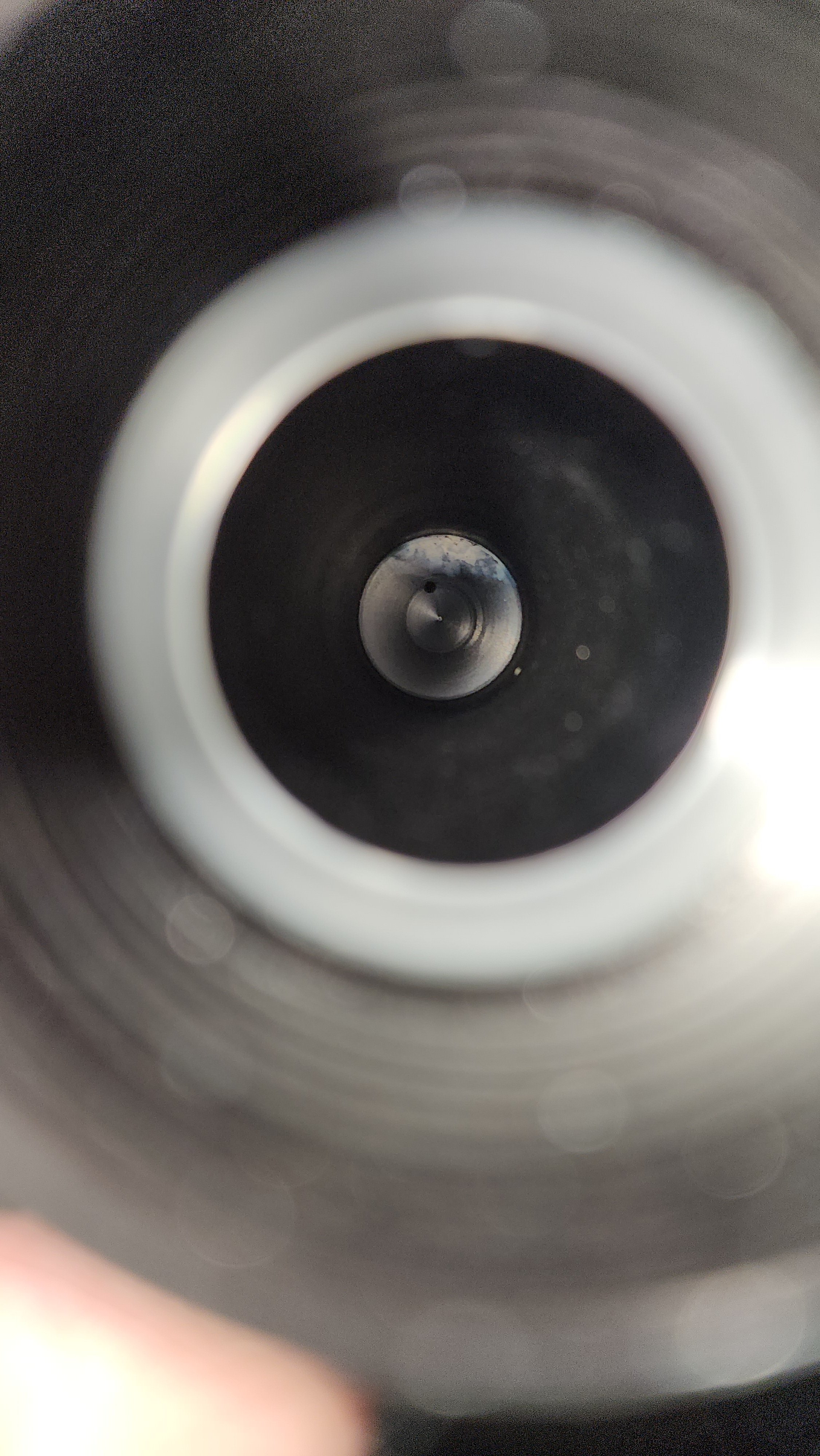

Can someone tell me what this is and can i get rid of it? Looks to me like oxidation or something. This is the back of the larger lower tank. I've had my L2 for a little over 2 weeks.
It's calcium... that came from water... which came from your compressor. That's the issue with these cheap compressors, they don't separate moisture, and it ends up in your gun. Moisture is not your friend with PCP airguns. Just clean it out with a long q-tip with a little CLR on it. When you can swing it... upgrade your air source.
Thanks, Is there a somewhat affordable compressor that actually gives you dry air out there or would it be better to just buy a tank and take it to the scuba shop? I hate having to rely on a shop, but I don't want to trash my airguns.
Lots of information on compressors in the Tanks, Pumps and Compressors forum. The two schools of thought I subscribe to are an Alkin or a Bauer for a pretty penny, or a pair of Yong Heng's, spare parts, a blower, ice water, a mechanical water filter followed by Brancato's carbon/molecular sieve filter if you're cheap and like to tinker. I can't say I've enjoyed my Yong Heng adventure as much I have our Leshiys however it has been fun to put the system together.

I have some of that calcium at the bottom of mine as well. Not as much as yours, but there is a speck there. Mine is about 5 months old.
Turns out, I forgot to swap out the moisture filter on my compressor for far too long. I don't have the most expensive compressor, but that moisture filter does a fine job.
My I ask what CLR stands for? I'd like to clean that gunk out as well. Also, anyone got any tips on how to clean out a gun that's "wet" on the inside? I filled at least 2 of my airguns guns with that bad filter. I'd like to minimize moisture damage in the future.

Feed your compressor nothing but low pressure Nitrogen and you will NEVER have water or any Oxidizers in your gun. No detonation in gun or compressor
and if you have moisture in the bottle remove it by purging it with nitrogen, must be able to flo in and out of tank.
Most any welding supply store can get you Nitrogen and a regulator with hose.

Calcium, lime, and rust. I looked up it's friendliness with aluminum and I get mixed feedback. Wondering why the end of tube isn't anodized like the rest?
Unless he’s filling up his gun with tap water I don’t think that’s calcium. Doesn’t look like oxidation either. Most likely the residue sb327 mentioned.
