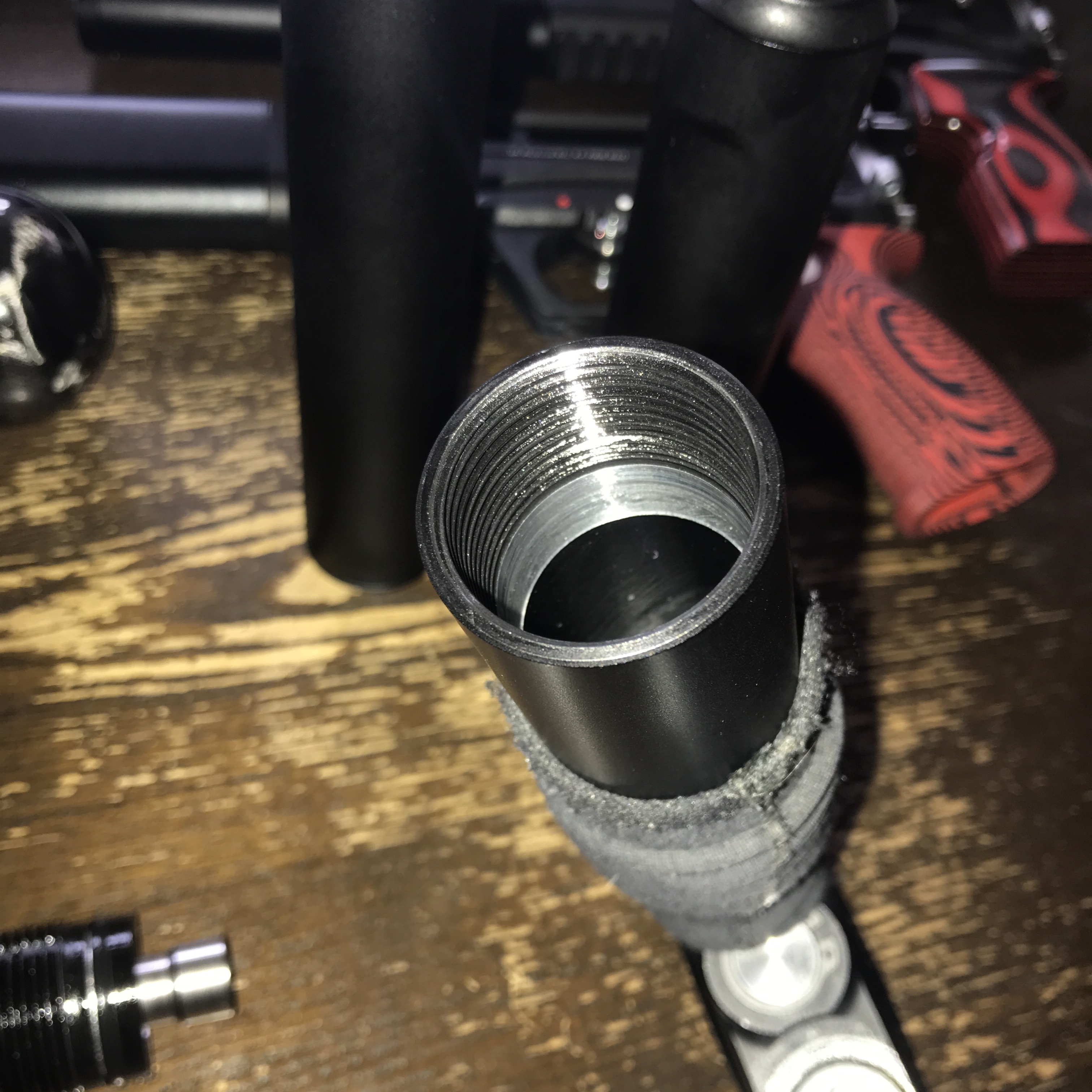

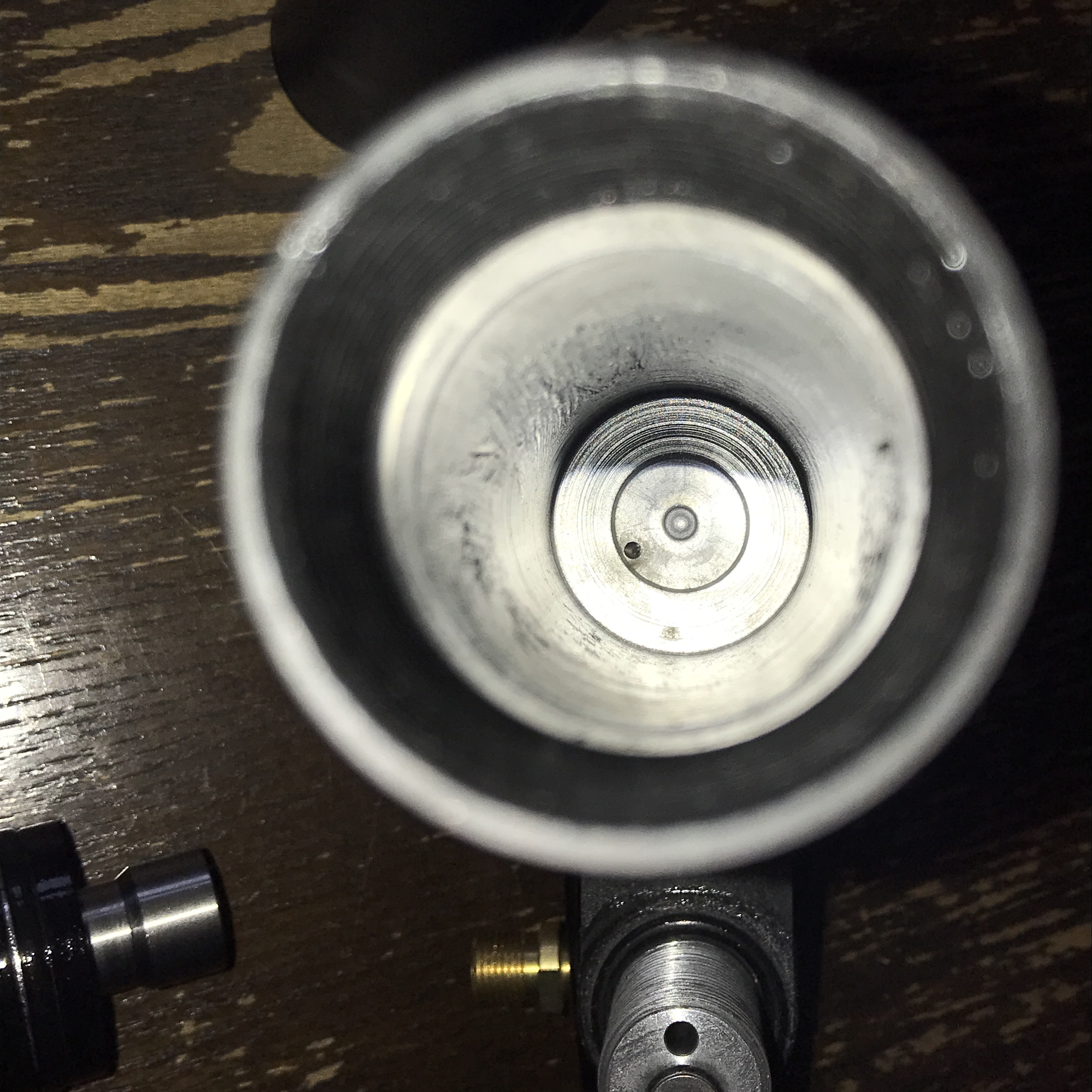

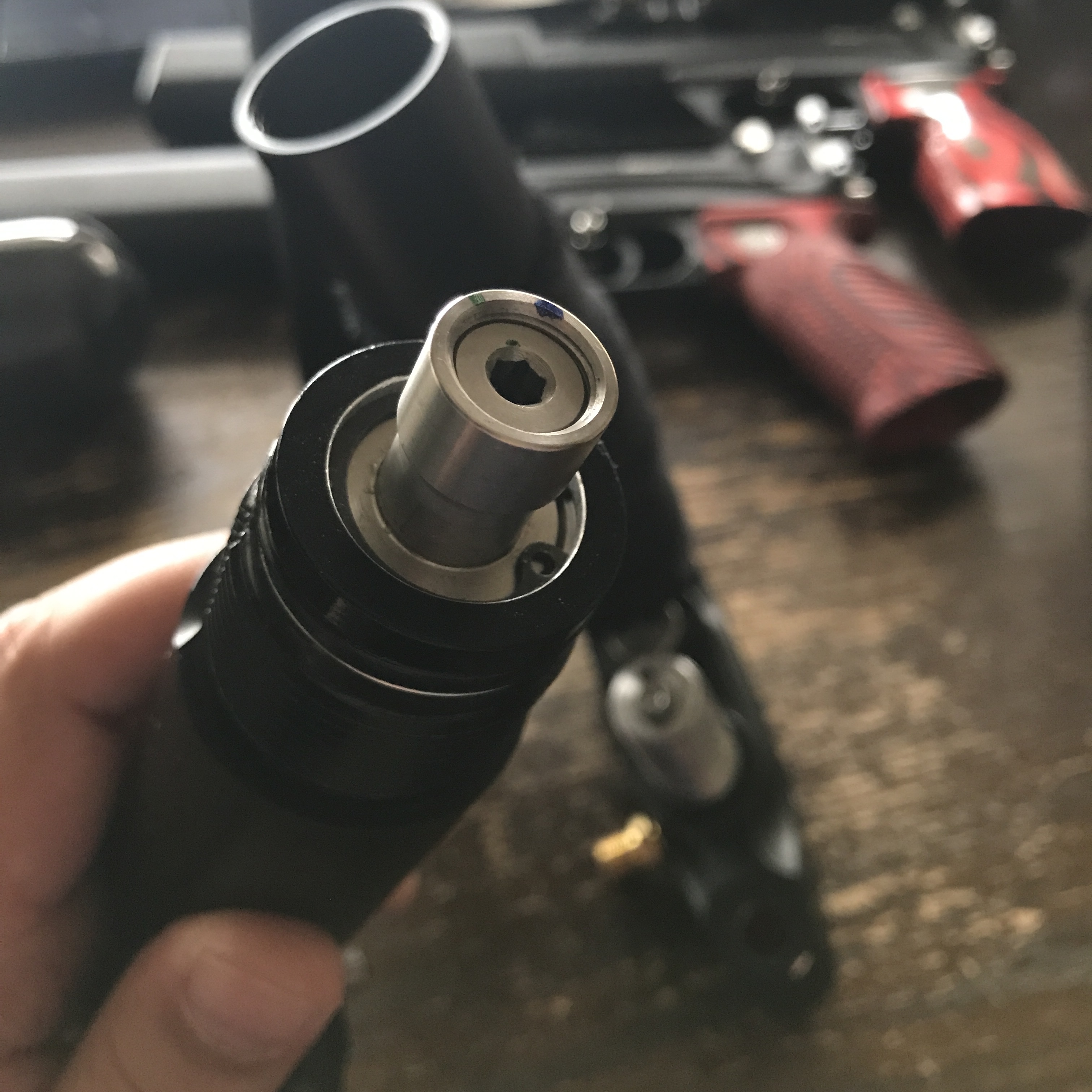

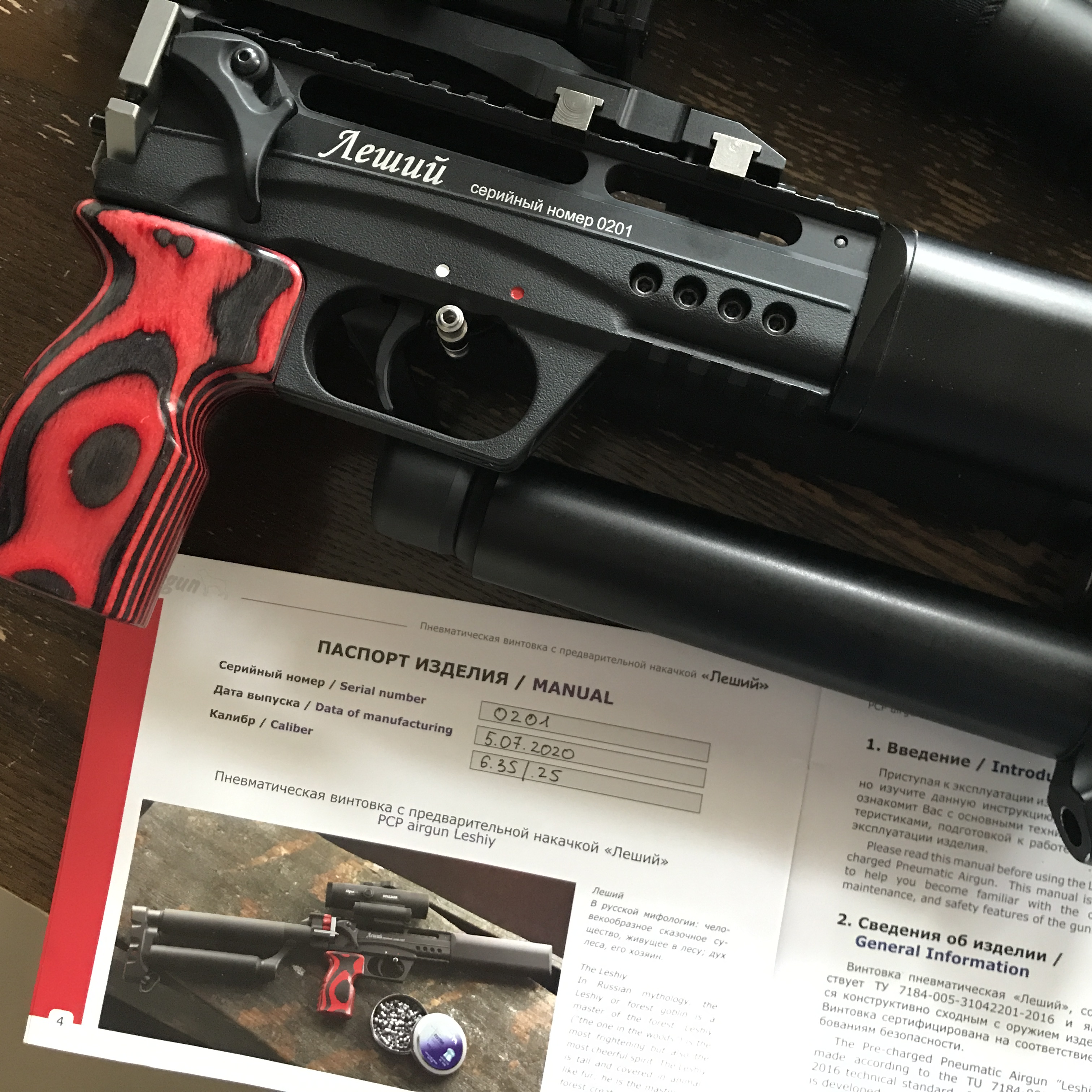

Today I disassembled my leshii 2 made in July 2020. I used the paintball shop service, they have a huge compressor with filters. + my Armotech 6.8l.
happy)
Sigh... I gotta say guys, ever since this incident came to light it's been harder for me to enjoy shooting my L2. I can't help but brace for impact every time I pull the trigger. With my other guns I at least have the "comfort" of knowing that my supporting hand is the only thing at risk. And not half my face xD
From the pictures it looks like the rupture happened approximately on the right side of the tube. Assuming the shooter is right-handed, it seems that is what saved them from serious injury. Had that airblast been directed to the other side... god only knows how it would've ended for them.
I really hope this situation gets cleared up soon so I can put my mind at ease. In the meantime I think I'm just gonna stick to shooting my other guns for the most part. It may seem overdramatic to some of you, given that the chances of this happening are slim, but as someone struggling with an anxiety dissorder, this kinda stuff puts me on edge, haha.

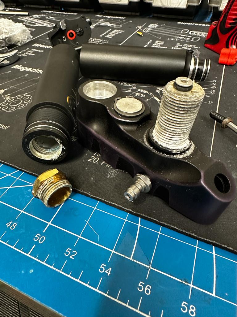

Ed asked me to share these photos of a gun I just took in for repair. Leshiys get used and filled a lot;. I have repaired many airguns that look like this.; using a quality compressor and water filter is critical. About 18 months ago, we switched Python Cowboy to nitrogen, and he has had zero issues or leaks since switching to nitrogen. Python Cowboy puts aproxemently 4 thousand rounds a week through his guns as the premier iguana guide in Florida.
Is that Topher's? LOL - pretty much what I expect his looked like.
Brian, you're a total superstar man - thank you for keeping us shooting and safe!
True corrective actions that I was involved with required the cause to be determined then replicated. Without the replication causes are speculation. ED Gun needs to replicate the failure and it should look similar to the actual incident. The more info you can gather prior to the failure the better to simulate the break.
