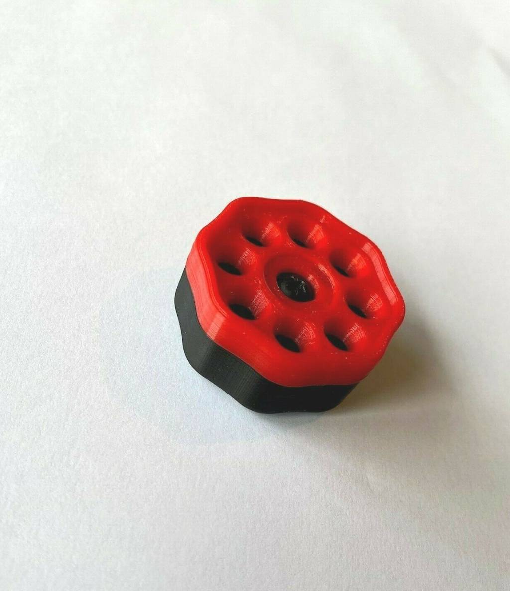

OD 40MM:
..so special edition 4 you - will attach PM if you want to try it

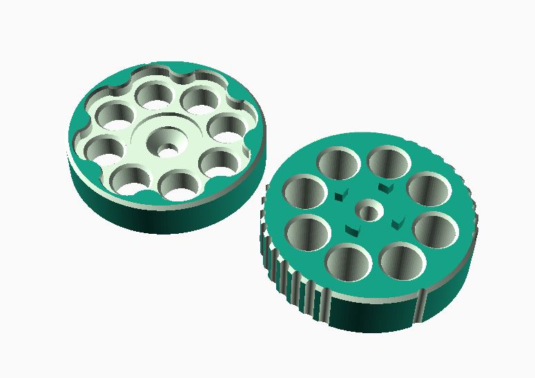

It's totally up to you. But that's pretty much exactly what I was going to do -- make a 6-disc version, or something like that. It would also make it easy to print off a model that has as many rings as will fit whatever bolts I have on hand.
FYI, most resin printers are relatively small so to use your .stl files we'd have to open up your .stl files in an editor, and parcel out the components to various individual .stl files. Parceling things in this pre-packaged form is the opposite of easy, for some users.
The greater purpose of sharing is that it saves people time. If I want to make something else that holds a magazine snugly (say a little muck/dust shield for when the Leshiy is open), I could open your .scad file and read off your well-measured dimensions myself. But if I wanted to build one on my own, I'd likely have to measure everything carefully, try a print, fit, edit my model, try another print, fit, etc.
Anyhoo, those are a few reasons to share, that come to mind.

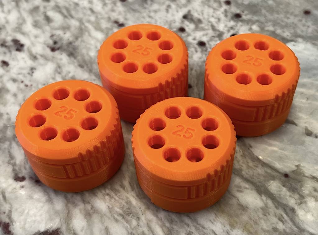

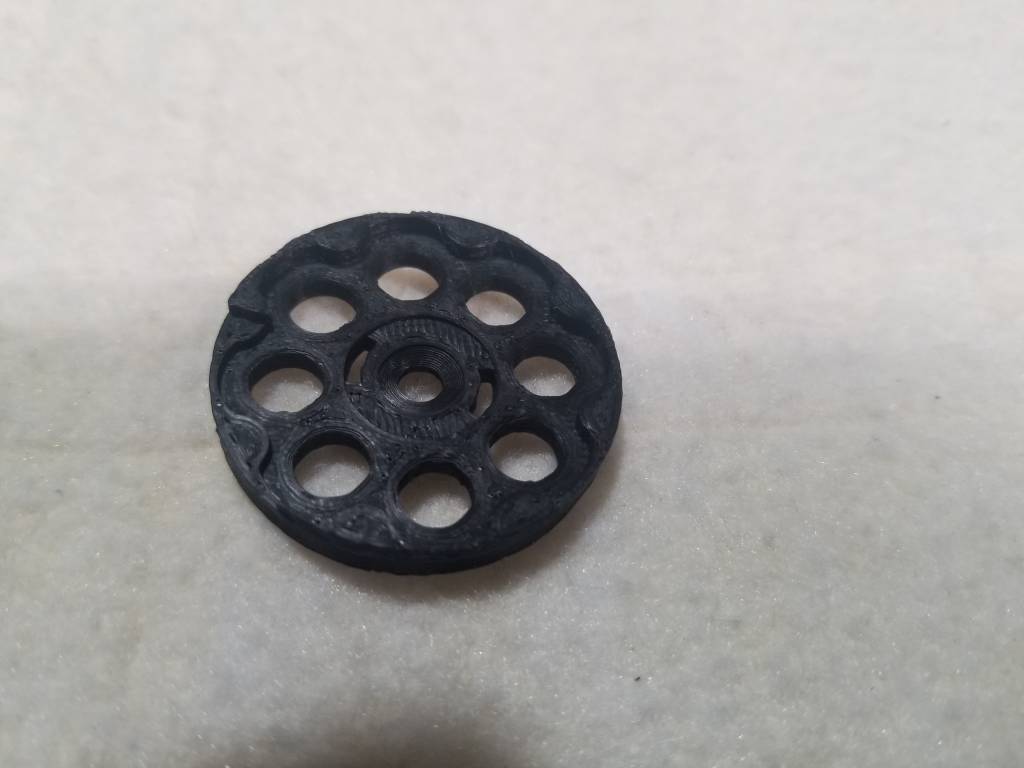

Towle, just a quick note with my thanks for sharing your speedloader .stl with us. I printed up a sheet of the 3-disc version overnight and they are a very nice and well thought-out design that as you said, prints very well. Will source the screws today and run a second sheet overnight tonight. Eight of these should be more than sufficient for my needs.
I didn't mind an overnight run as my printer wasn't otherwise occupied, so I printed as follows:
Prusa MK3S+, 0.15 Layer Height, 15% Gyroid Infill, Hatchbox Orange PLA

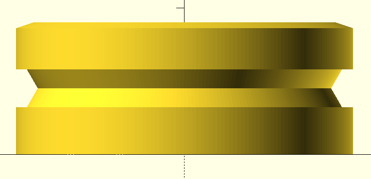

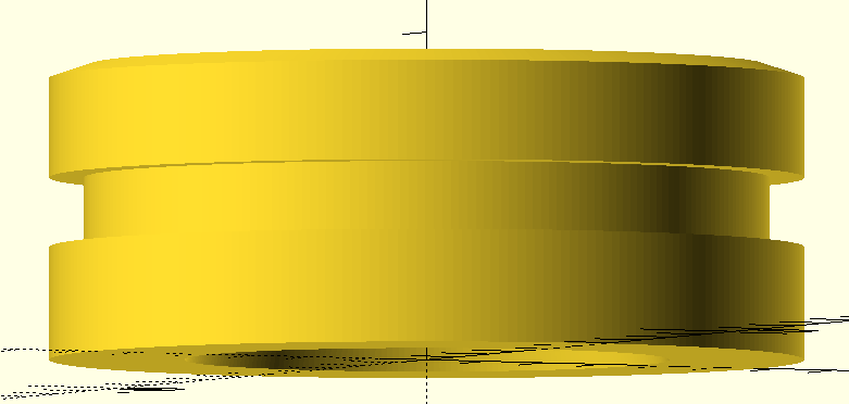

I thought I would try making a hopefully slightly more efficient and effective puck (transfer port seal) for the Leshiy 2.
This is the rough design. Any ideas for anything I might be missing?
The primary changes from the original are:
1) the hole diameter transitions from the port opening to the pellet diameter
2) the o-ring cavity has the same shape as the o-ring, i.e. round not square.
3) there is only rounding on the face that touches the magazine.
I'll try printing this tomorrow and see how it goes. I might need to add a bit of rounding on the face that is opposite the magazine, to get a good snug fit.
When I'm done I'll put this on thingiverse as a "customizer" so you can print for whatever calibre your Leshiy is setup for.
I think I see your rationale. If it's square there will be three "contact circles" and two intermediate pockets of air. Those little pockets will slow the transfer of air around the o-ring.
I still think a tight-enough circular cut-out should work, but I'll try both and compare. I suppose I could try a hexagonal cut-out as well, to have three air pockets.
