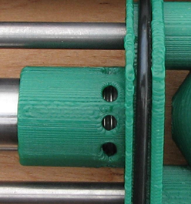

I'm curious how much clearance are you giving the pellet path in the original design? PETG tends to be a bit gooey to print with and my pellet path was lightly covered over printing following your orientation.
when printed in the horizontal position and with the pellet channel unsupported you might get a small hang from the upper perimeters, I do not know how PETG react to machining but I cleaned up my print in PLA Max (5-6 times stronger than normal PLA) with a 5.5mm chainsaw file

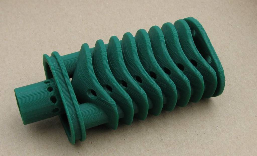

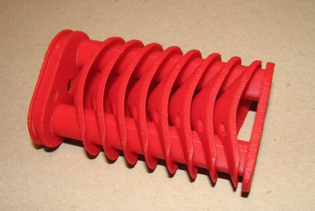

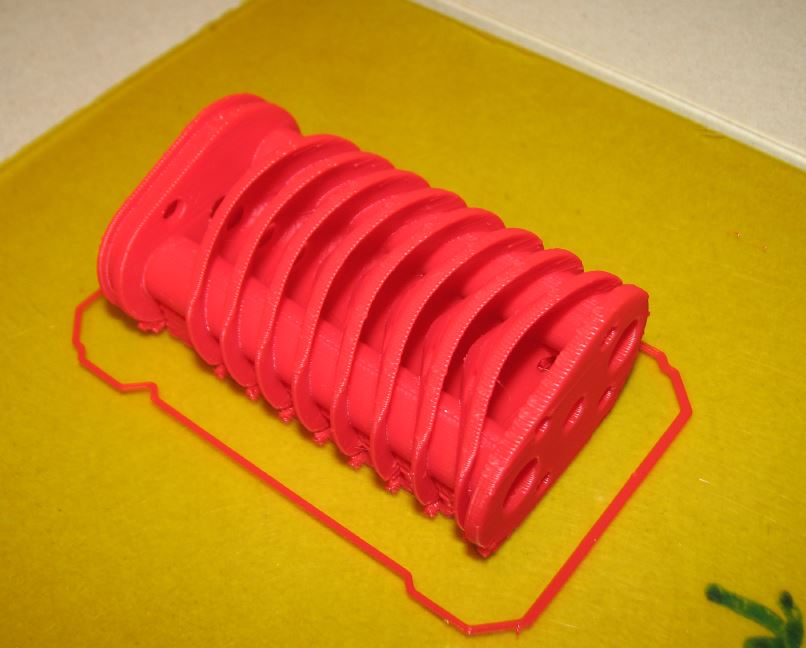

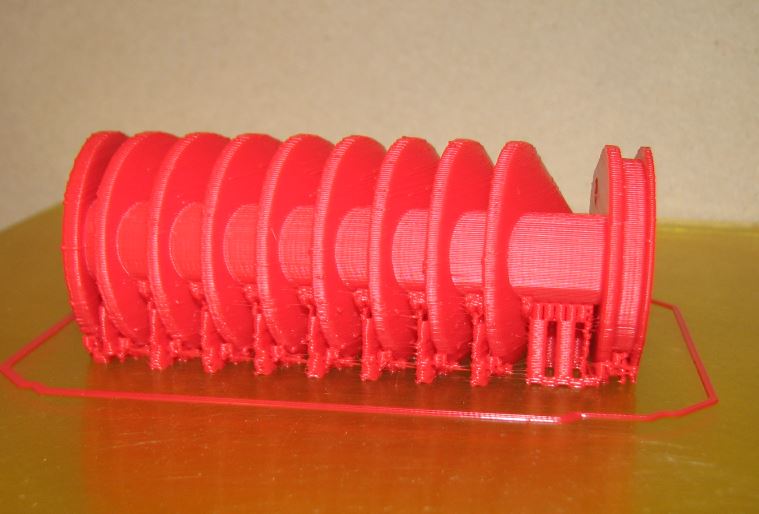

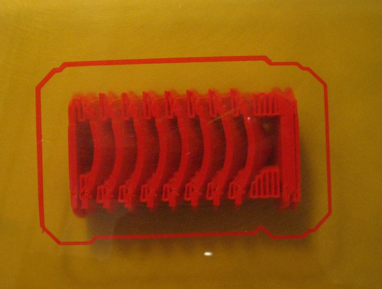

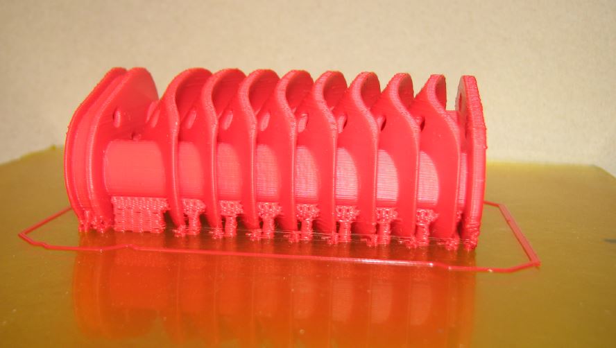

This is from my horizontal print with a home made Franken printer
Up skirt view though the glass with kapton tape
After removing the support material
Reactions: adamworkinghard

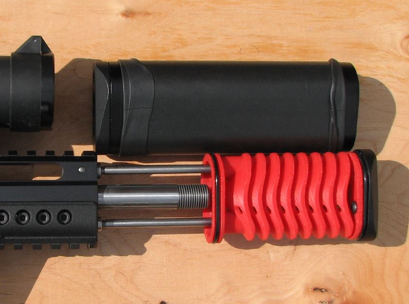

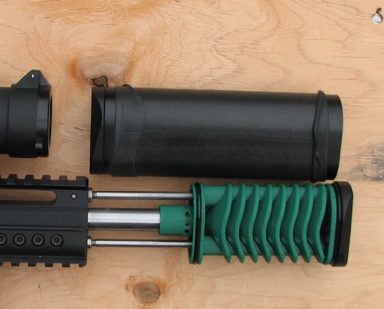

I also printed you B model
Thank you very much for you time in design and sharing!, it would be impossible for me to make a thing like that i OpenScad!, your work is highly appreciated!
I do not have access to a sound-o-meter but the difference from the original moderator is substantial!

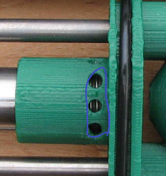

did u notice any difference between the normal and B model? I have the 350mm barrel so when I designed the B model the barrel doesn't actually go past the holes in the baffle but in your 250mm version the barrel is well past the vent holes which is not what I intended.
I think for L2 short versions it is better to stick with the normal version.
