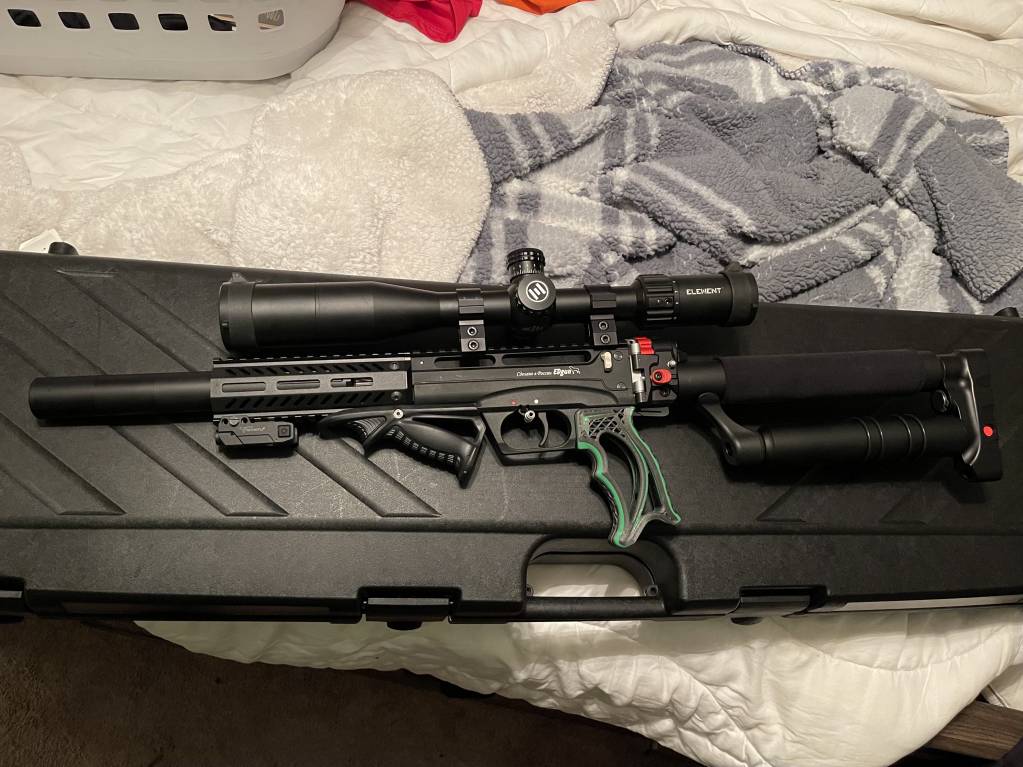

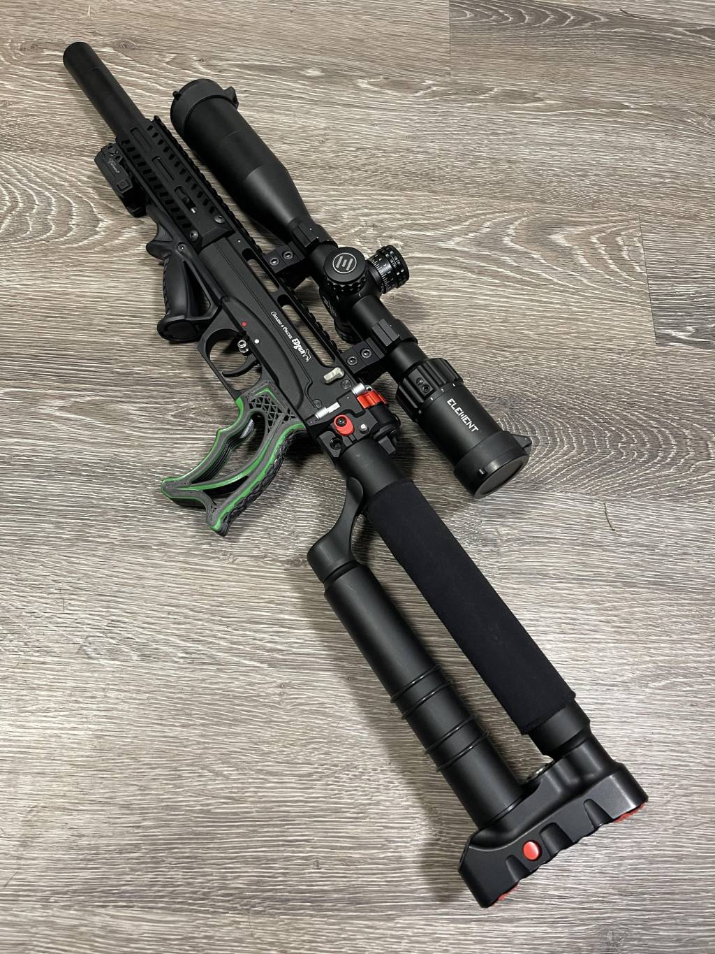

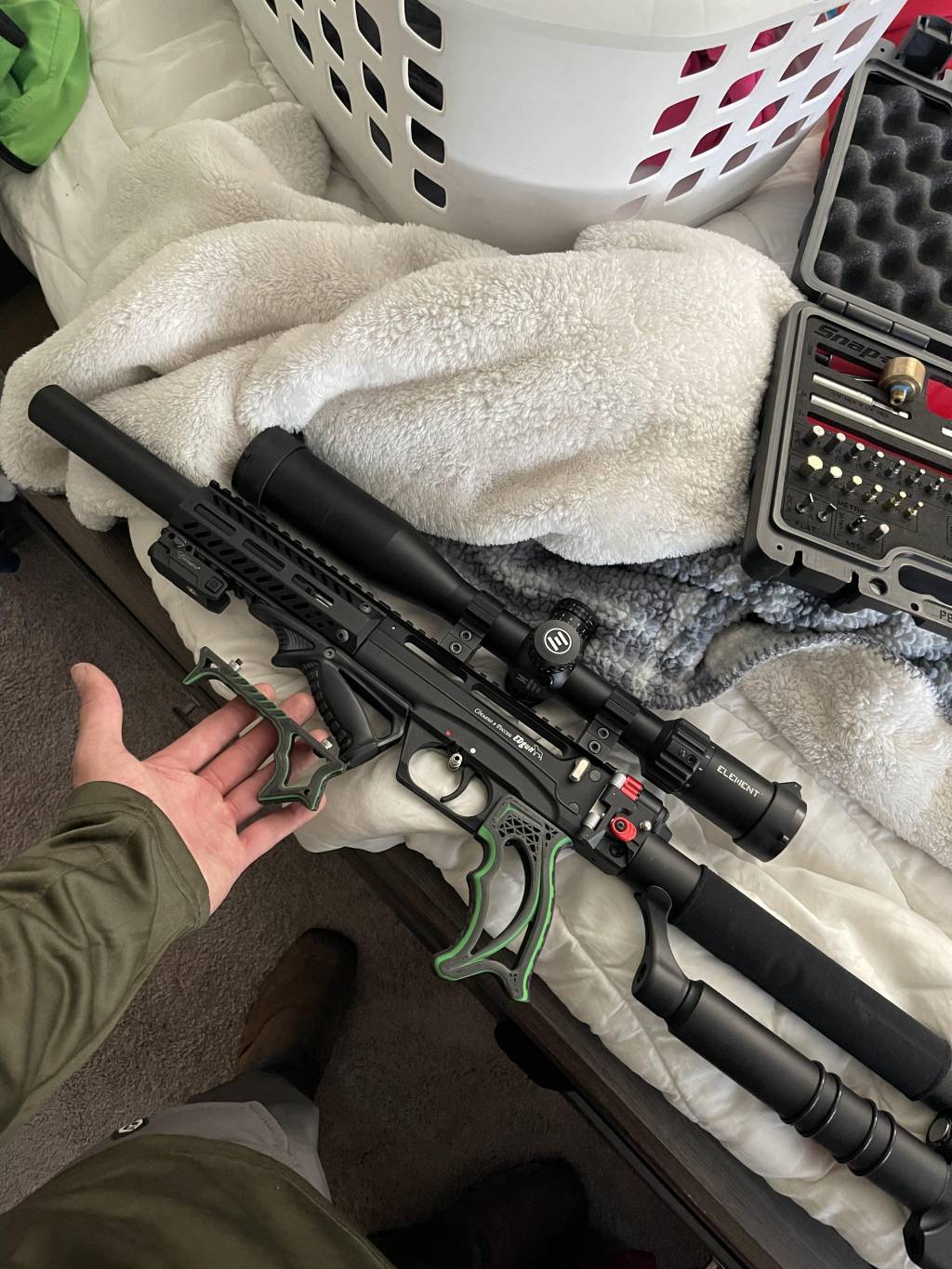

My 250mm seems to dislike the avs slugs everyone raves about I have found however it loves FX Hybrids .22

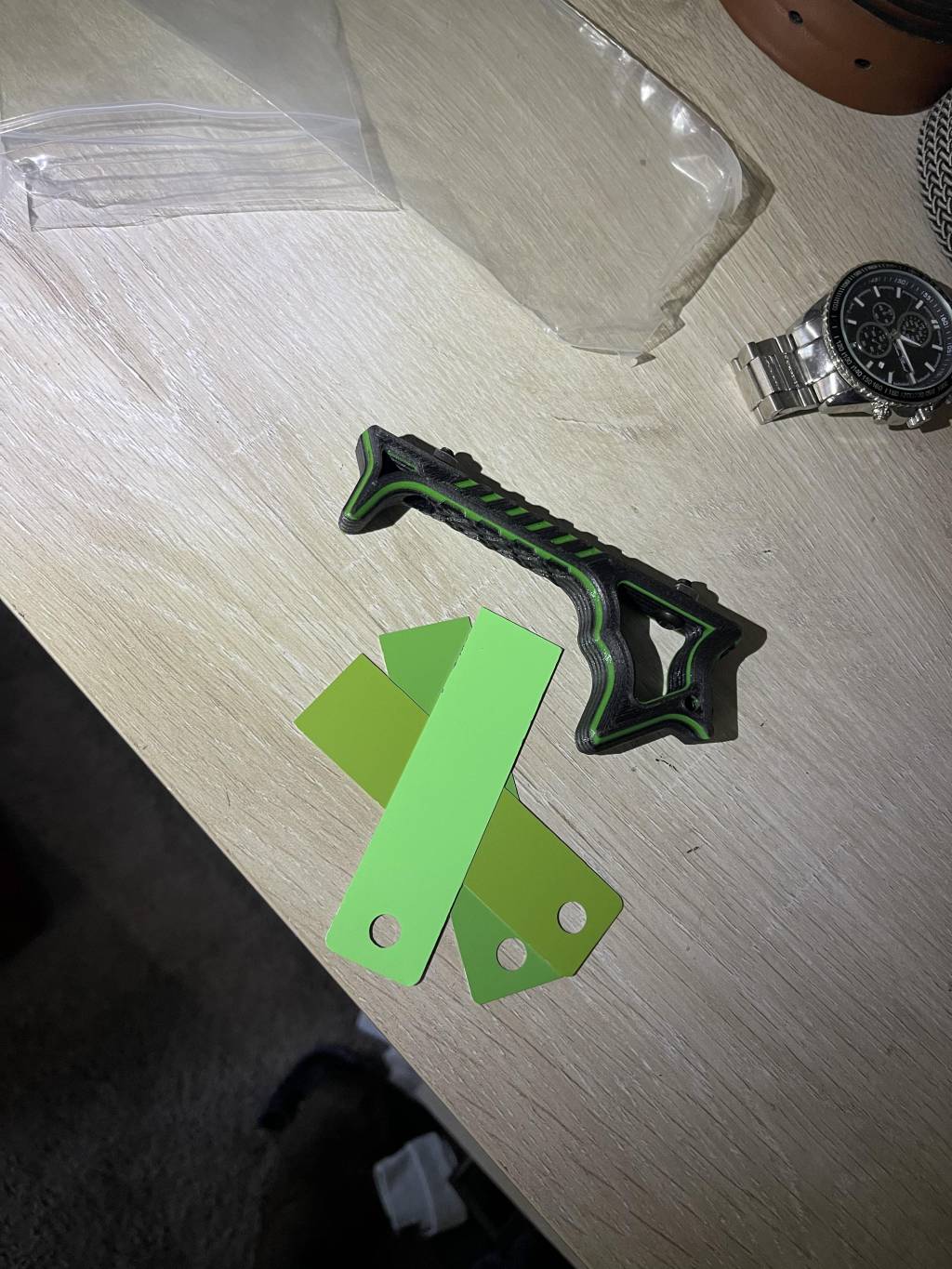

i plant to cerekote the mags enough to build up the coating inside the holes so that the ammo stays in place and doesn’t slip through the front for now I carefully load them “upside down”
