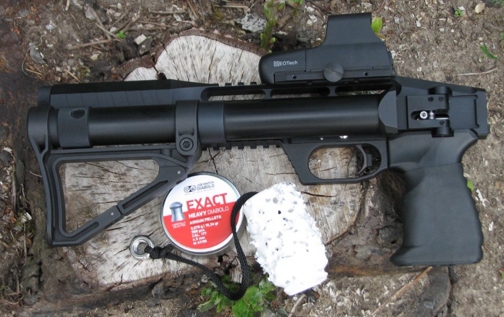

Just shot 3 fills at this target (the white thing) at 60 yards and was able to hit it 80% off the time - that's 80% inside 3 MOA offhand, I find that amazing for such a small and light airgun (1627 gram total with Eotech Holo)
I love this thing..
