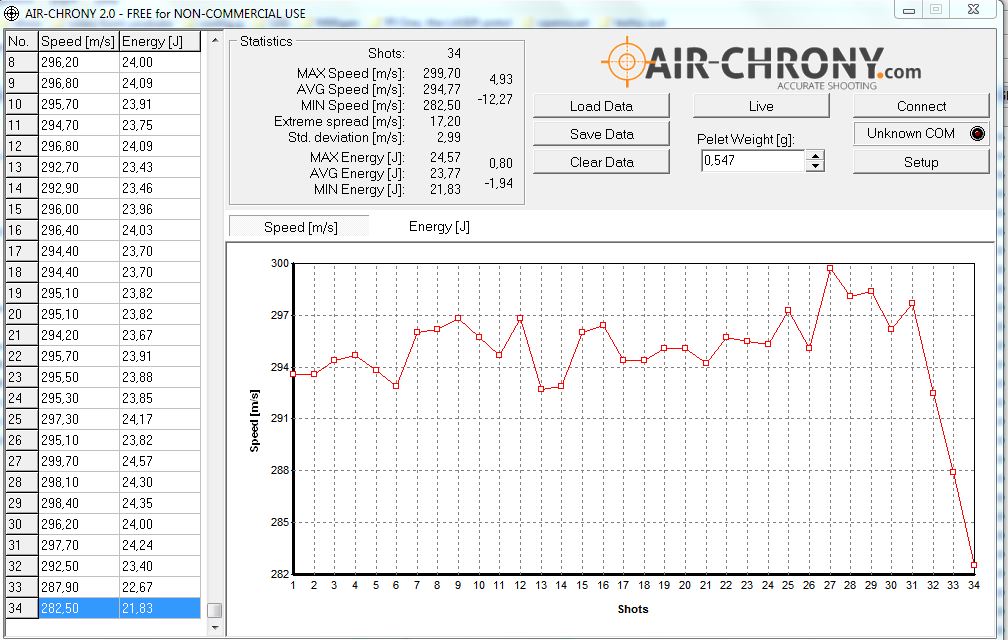

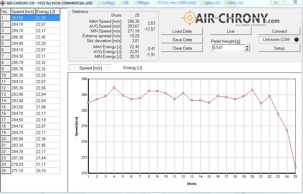

No that's OK, 130 bar reg. seems to be the most effective setting in .177 cal, my two Leshiy's is also with 250 mm barrel
Leshiy 3485 Reg 115Bar HST 22 - 288 to 97Bar:
leshiy 3801 Reg 130Bar HST 15 - 310 to 106 bar
Excellent information. Would you know in which configuration of the reg it was quieter and more accurate? 115 or 130 bar? Thanks
