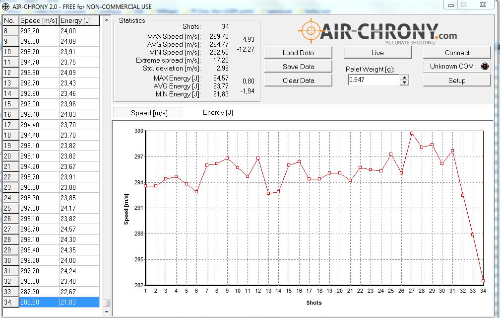

Leshiy 3485 Reg 115Bar HST 22 - 288 to 97Bar:

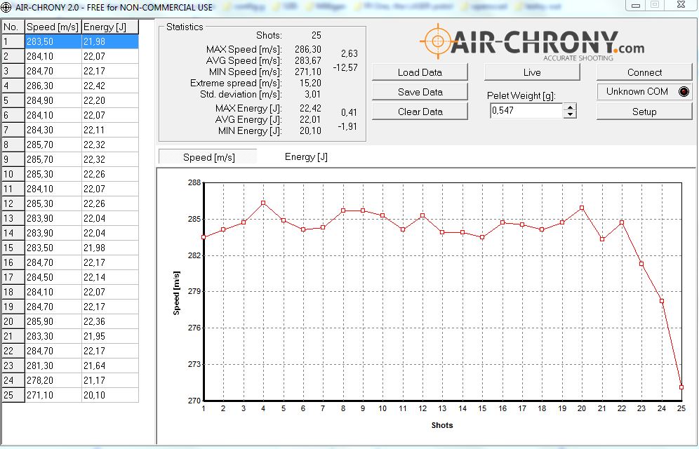

leshiy 3801 Reg 130Bar HST 15 - 310 to 106 bar
