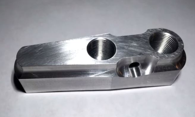

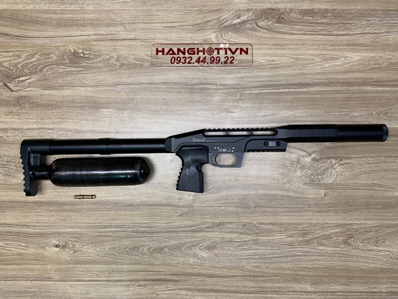

Somewhere on the internet is what appears to be a Classic Leshiy with a machined shoulder pad and a bottle screwed into the lower part, very similar to the Leshiy2. I'll see if I can find it.

Leshiy 1.5?

Quite interesting, but I prefere somthing to attach to the OEM reservoir.
Leshiy 1.5?

No. This had a part similar to the picture above but the lower hold was further down and a carbon fiber bottle was screwed into it.
