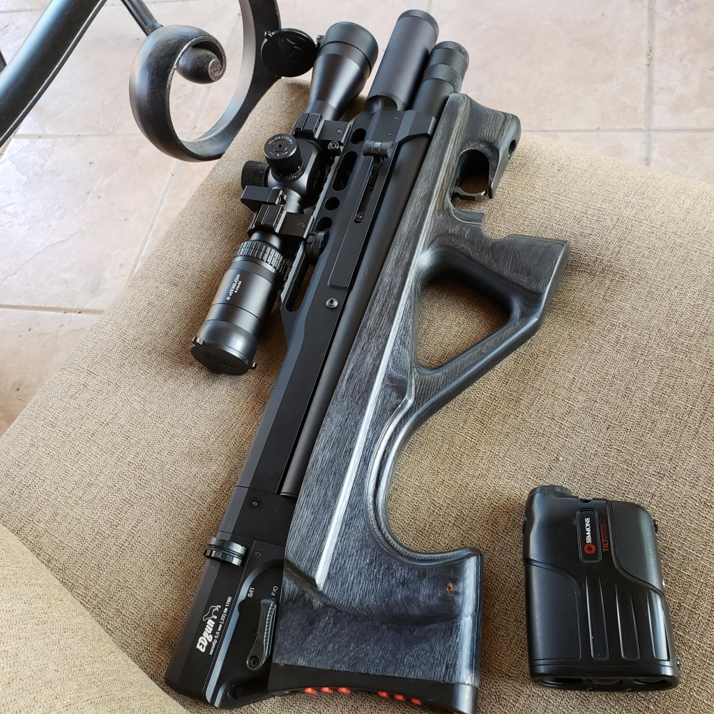

Hey all,
I just took possession of a Lelya in .22 and so far am really enjoying it. The only thing that's bothering me is the hammer ping. With the BAT mod, it's the loudest part of the shot cycle (even when held away from my face) and actually makes my ear ring. Is this normal for a Lelya and is there anything I can do to alleviate it?
Also I still have it at factory settings (18.1s @ 854fps) so I don't think its turned up super hot to justify the ping. I do plan to adjust it such that it shoots 16s around 800 to 850fps but wanted to shoot it as is to break it in. Hopefully I can get there with just a hammer spring adjustment.

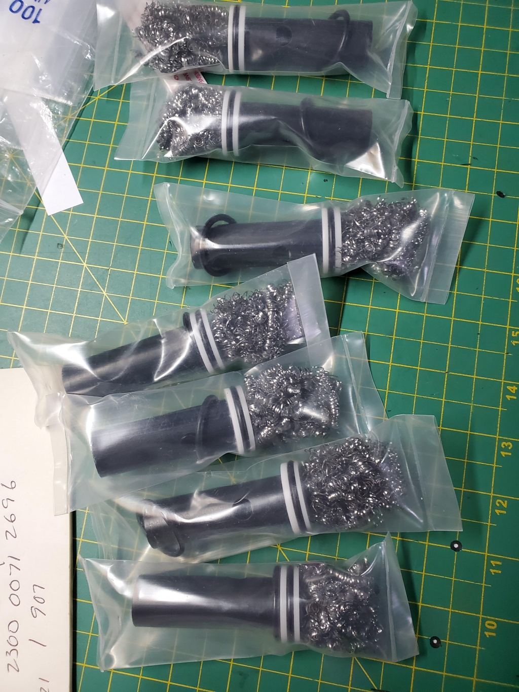

I have 7 depingers for the R5M Lelya, these are experimental , I am willing to give them away for the cost of shipping (5 dollars). I would like some independent reviews of them. If want them email me
Brian
