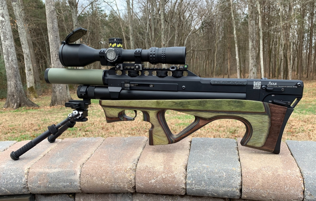

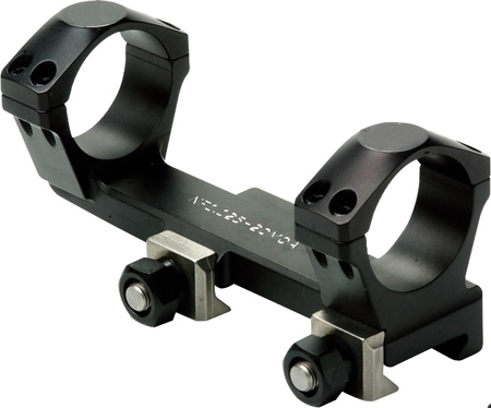

I wanted to use a low cantilever Mount. This is the Nightforce A109 with the NX8 2.5-20X. It sits low. I really like it... it fits. The mount has added comp and it is no issue at all with this optic.
