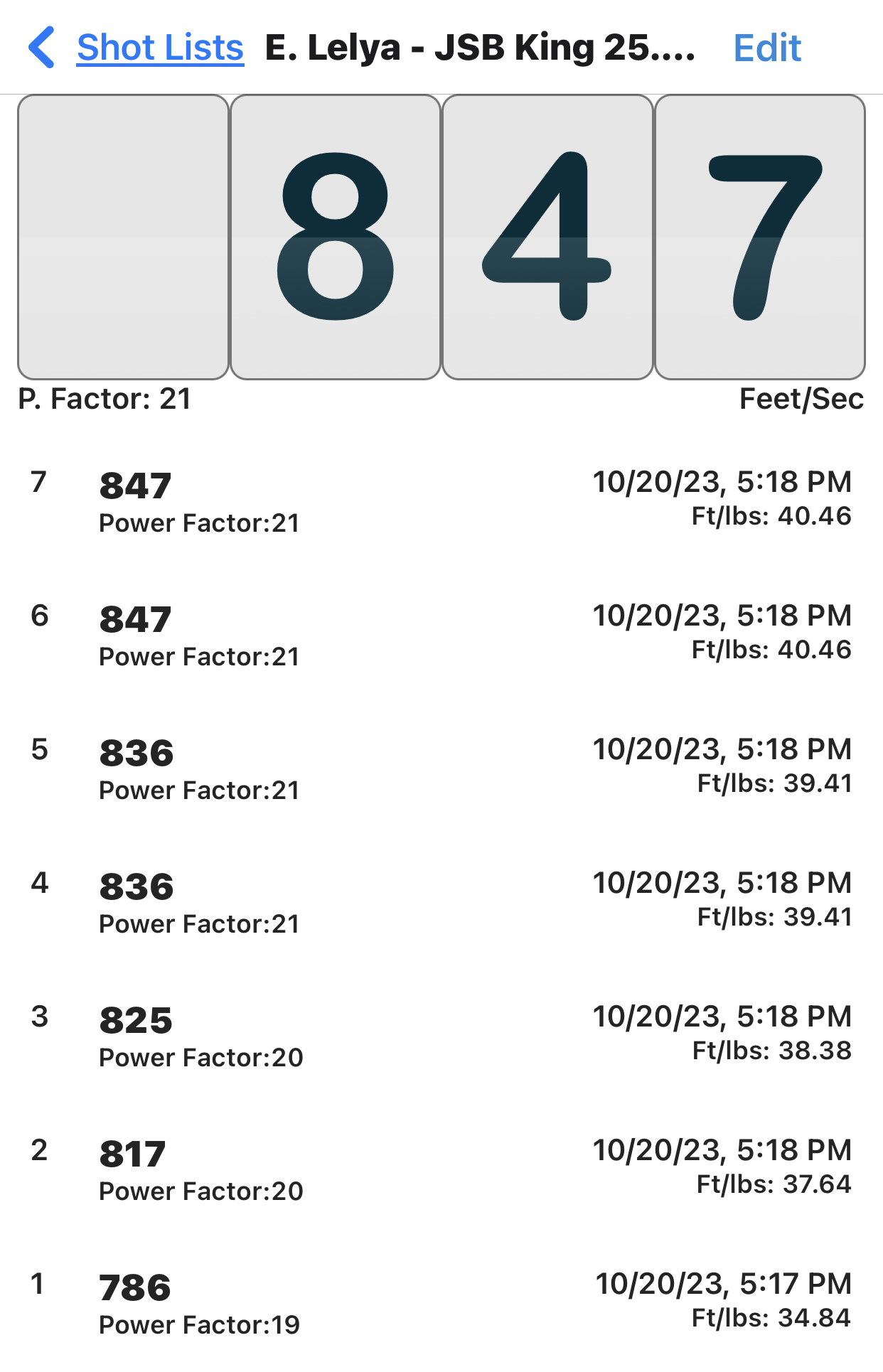

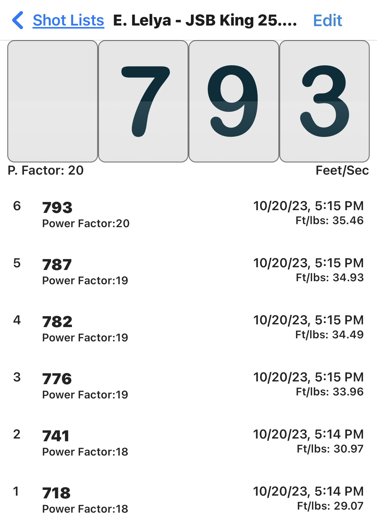

Last squirrel season I began noticing that I was missing shots that I shouldn’t miss. I’d suspected that something was awry with my .25 Edgun Lelya 2.0 i suspected a valve or reg issue. Consequently, I shelved her and it’s probably been 8 months to a year since I shot this rifle. Yesterday I cleaned the barrel and chronographed 4 shot strings. Only one string read every shot, but what is consistent is that the velocity rises with each shot. I’m thinking my reg is shot, but I’m unsure where to begin looking. Anyone else experience this? If so, what causes this?
Below are screen shots or the strings. Starting reservoir pressure was around 185 bar and I finished around 120 bar after 36 shots.
1st shot string
2nd shot string
3rd shot string
4th shot string
Even with these rising velocities, there groups were not too bad for quick shot strings off of shooting sticks.
Reactions: Showme
@Airgun-Revisions Im used to my unregulated guns doing the opposite. They start high and then drop. Sometimes the first 1-2 shots may rise a little before tapering off in velocity. This starting low and rising is very strange to me. These shots are supposed to be in the mid 800s.
You get this effect because at high pressure, the hammer barely opens the valve and as pressure drops valve opens more. You reached your expected speed right at the end, suggesting that your reg is set ~120bar.

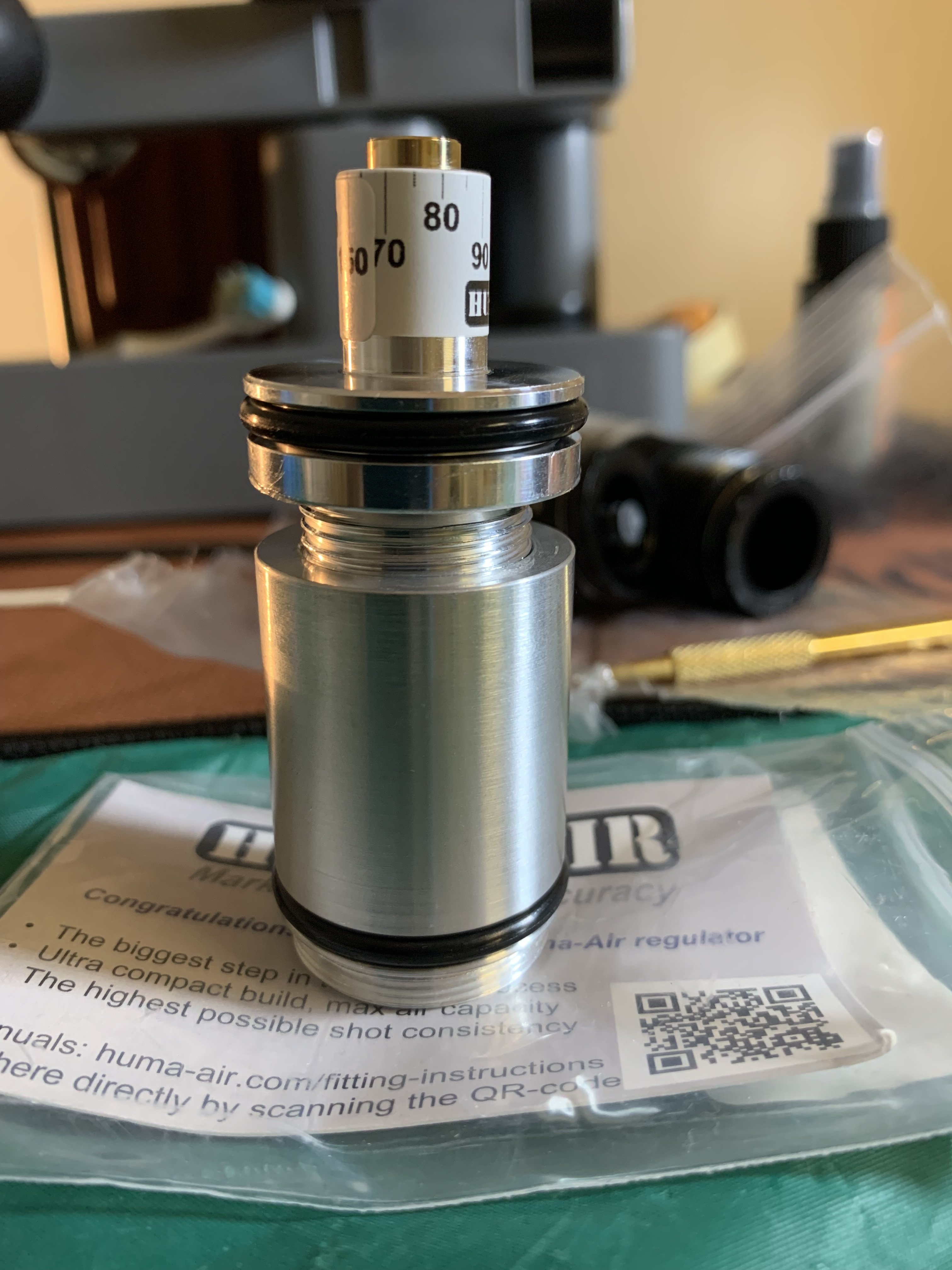

So it looks like I don’t have a decent reg to put in my Lelya right now. I don’t have the right sized o-rings to rebuild my factory reg and the Huma reg I’ve had stowed in the packaging it came in for about a year, doesn’t seem to want to screw into the plenum. I can’t see where anything is cross threaded and I’ve never done a thing with either of these parts.
This is as far as it screw into the plenum before it feels as if it’s catching something. I know better than to force it.
I’m having a helluva run with problems right now. Only things I can think to do are to order o-rings and to contact Huma and see what we can do about this regulator set. There’s goes my hopes of hunting with this rifle this weekend. The factory reg is back in the reservoir.

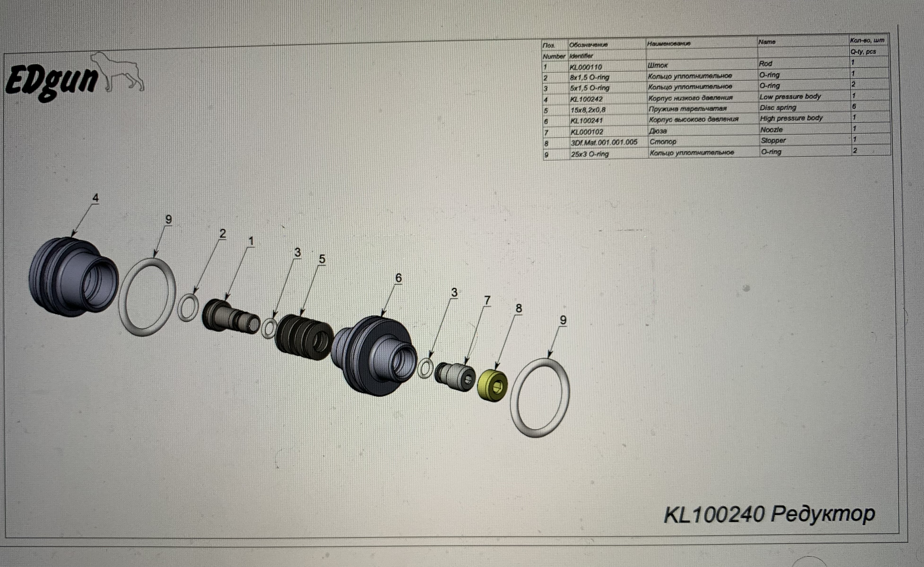

@nervoustrig On the factory EDgun regulator, that would be oring number 3 in the schematic, correct? To be clear, do you suggest using Viton 90 durometer on the piston?
Yes #3 in both places.
Regarding hardness, the safe bet is to stick with the OEM value. The drawing doesn't say, though the fill pressure of 250 bar suggests a 90 durometer is reasonable. However my experience is that Viton in 90 durometer is more susceptible to tearing when installing than Buna-N or polyurethane so it may be helpful to drop the O-ring into hot water for 30 seconds to help with installation. Or if you can buy small quantities from a source like theoringstore, consider also getting some 70 durometer just in case.
