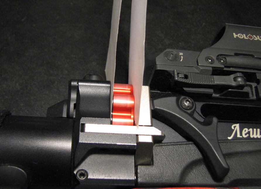

You can check the head spacing with a slice of paper, 80g copy paper measures 0.1 mm, should easily slip down to the barrel end and puck on both sides of mag, rotate mag, check again

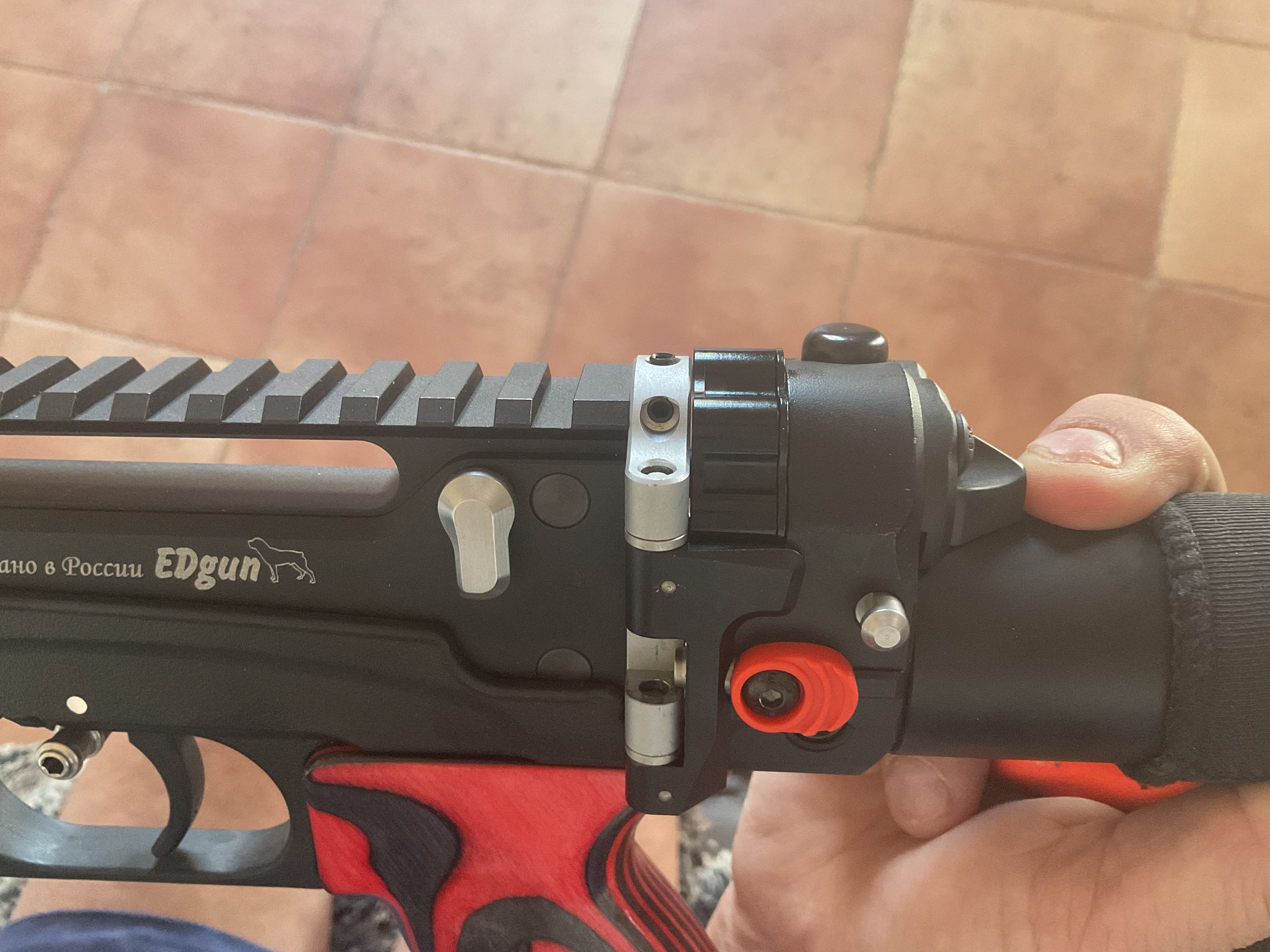

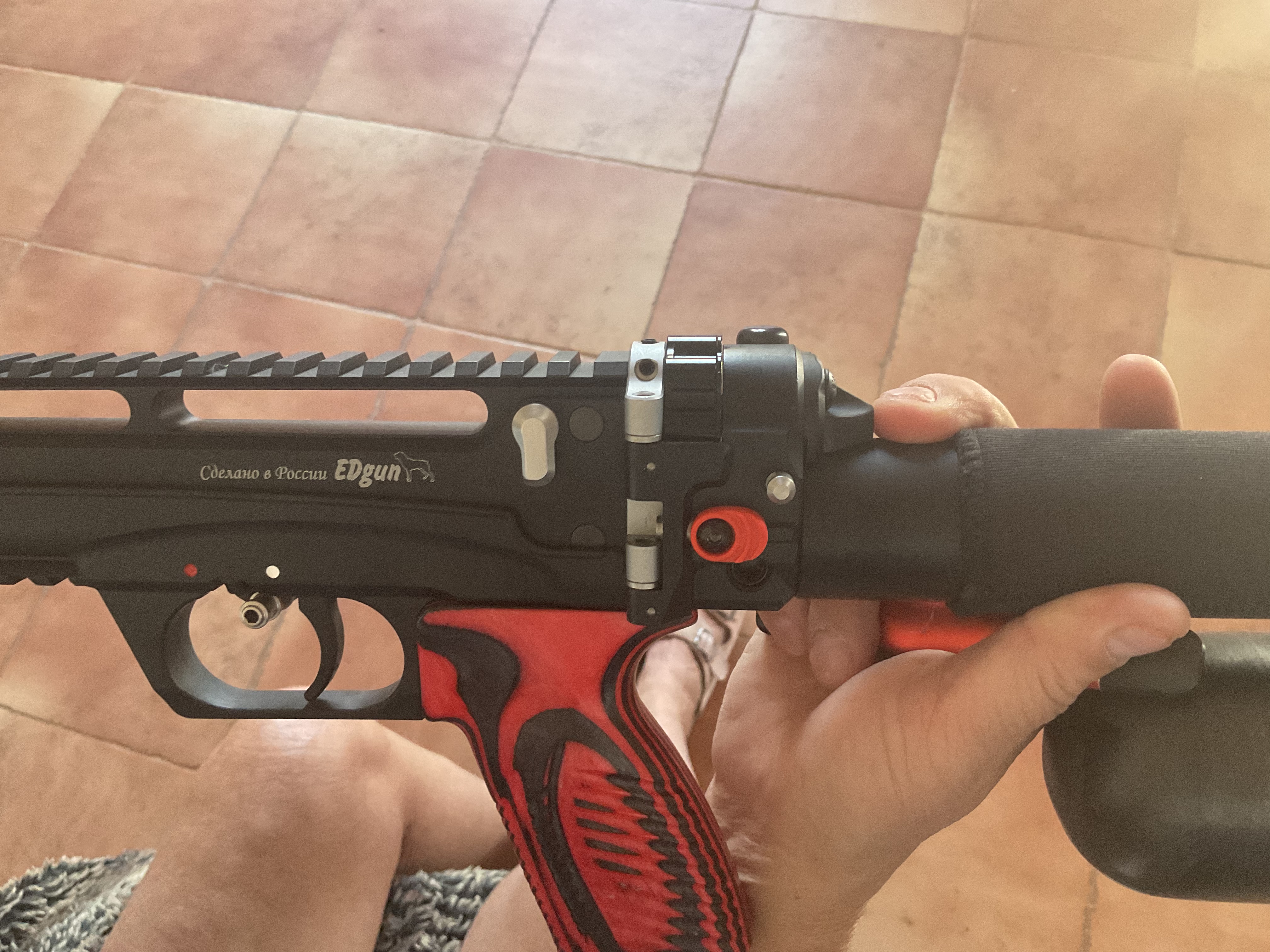

As you can see i have a small gap between the mag and the breech both sides i have done the paper trick and it moves freely, i have also swapped the puck again and applied a tad of lube but still no better, the mag moves more freely with the gun open than when closed, if i manually move the mag after firing it refuses to fire again until i open and close the gun even tho i have moved the mag into the next firing position, More help needed :rolleyes:
I haven't had any real problems with my gun, so all I can tell you is the little I know. When I have had the cycling issue you mention, in my case the problem was one of three things, all user error. 1) The gun was out of air. This is the most common way I get to the cycling issue. 2) My barrel wasn't properly seated and 3) I forgot to attach the backing plate on my magazine.
