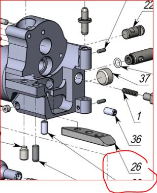

Not asking for puck hole ID but for the extended puck length, whatever is the mag thickness.
I have seen one picture about it deep in past but cannot recall where.
Why?
There is two way to make the L2 a single shot: - either to move the barrel back to touch the puck; or make the puck longer to touch the breach.
Need these flats to reach to the puck (see that shelf below the puck), but will not necessarily clear the #26 when un/latching.
I can 3d print any puck until it is in the hole, but for extended version shall be some metal I guess.
No, I will probably design one - simple bushing, and source to a CNC lathe shop. Orings on me. The guy was doing some airgun parts and mods for me during a year.
I think delrin or teflon shall work, peek maybe too hard.

To fabricate this extended puck is easy, I would go with turning it on lathe from delrin.
