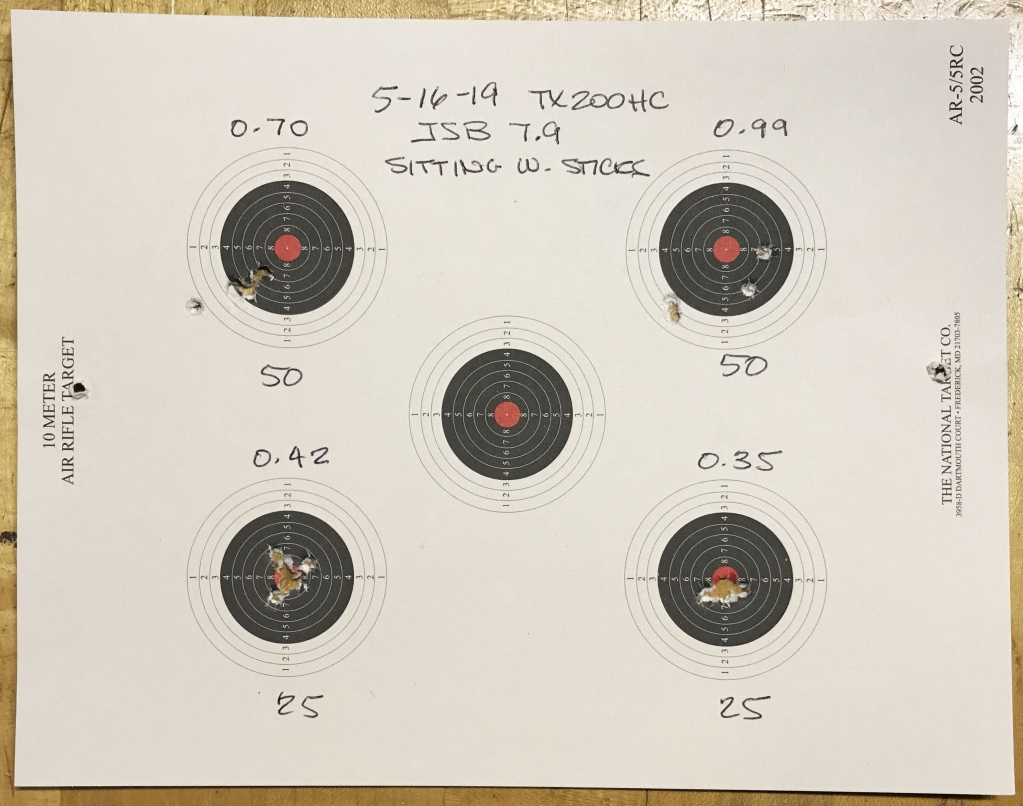

I shoot mostly from sitting with sticks as that is my favored position for hunting. My goal has been to keep all shots in a standard 10 meter bull at 50 yards. I can manage it sometimes, but can't claim to achieve it consistently, although I often come close. I was practicing today and at the end of the session decided to shoot a target for the record. The results at 50 yards were OK, but not outstanding. I find it very difficult to get PCP type accuracy at that distance with a springer. I don't know if it is pellet stability, wind sensitivity with light pellets, power drift or something else. If someone has been getting consistently better results sitting (not bench) from their TX, please tell me the secret! Results at 25 yards I would call good, and probably close to what I can get with a PCP from the same shooting position.

Hopefully this helps answer some of the recent questions about what to expect from the TX200 with regard to accuracy and tune kits.

"sitting & stix" looks pretty good. FT seated might produce better groups if you can.
Sorry, it's likely not the "springer" . Now your groups are at least as good as I could ever shoot with a TX but I've shot with many others who could use my rifle and shoot honestly great groups, seated or standing go figure.
Maybe(?) moving your stix back much closer to the trigger than one would normally do. Saw it work for another shooter of that style.
The "pcp like" accuracy I have seen springers shoot was either from admitted world class shooters or squirrel shooting types with one old rifle.
